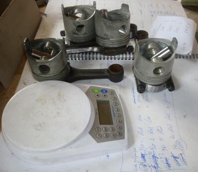

Piston-gudgeon -rod assemblies are all weighted to 1 g. Two at 1137g and two at 1136g. Piston weights varied from 337 g to 345 g which required some "fettling". Other variables were in big end caps and 1 g variation in gudgeons.

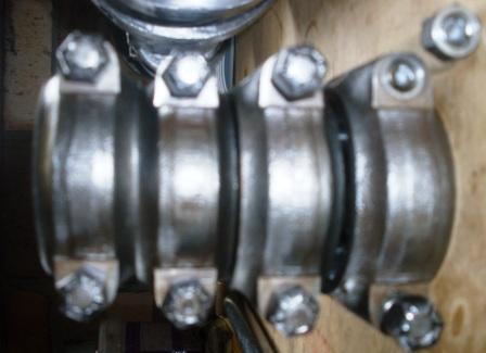

New hi-tensile main cap bolts were check fitted by the chief financier, kero-cleaner, de-greaser, go-fer and part time casual would-be engineer.

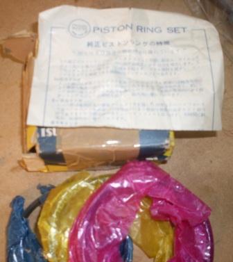

Piston rings came complete with instructions - Perhaps one of our Japanese friends who visit the site can help?

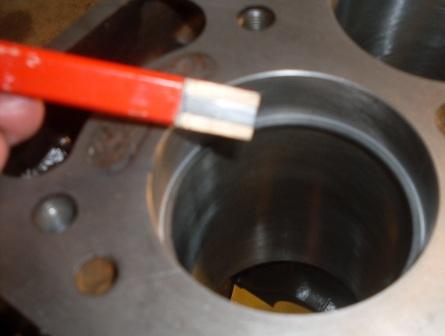

End gaps checked out beautifully -13 thou for no 1 ring and 10 thou for number 2 without any filing required. The hi tech depth gauge for locating them squarely in the bores took ages to manufacture!!
