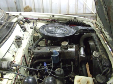

Carb adapter finished, accelerator cable made and fitted, modified some valiant parts I had in my parts bin.
Working on aircleaner and wiring at the moment.
Will post a picture of fitted carb later. The ones I took were a little bit out of focus :(
Edited to add photo of installed Weber 34ADM.
Note: I turned the engine over to prime the carb with fuel to check for leaks .. Bella STARTED !!!!
That's not supposed to happen surely, carburetor that has been sitting in shed for 4-5 years, covered in red dust, no leaks and starts without any questions !!???
Well, the idle circuit wasn't connected and choke was fully closed, ie VERY RICH !!
When I got the power hooked up to the solenoids it still ran, very fast ... lots of air, lots and lots of fuel. Will definitely need to re-jet idle and main circuits.
Idle mixture and speed adjusted so she idles around 900rpm (just cannot get it any lower with that much fuel going in).
Initial comparison, accelerator pump works (old carb had none) revs very cleanly (even with that much fuel) to an indicated 6000rpm.

Okay update time.
Air cleaner pan has been modified and now air cleaner fits without hitting the oil filler. Likewise the rocker cover and battery !!
I won't offend anyone with a photo of the inside and the crap fabrication that I had to do to move the carb mounting across.
Still got to finish the snorkel so it clears the bonnet at the front but otherwise fits okay.
*Update snorkel finished*
Also fitted up the crankcase ventilation.
Anybody know if I need to fit a PCV valve into the line between the aircleaner and canister or is it only necessary if the PCV is plumbed into the manifold, thanks.

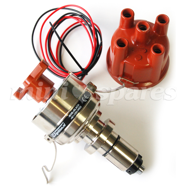

I also found on the Demon Tweeks website some points replacement units ... need to work out what distributor it is (I can't find my book at the moment).
And this ... anybody know anything about these?
http://www.123ignition.nl/id/50.html
The standard distributors for Citroen's etc are around $550 AUD, so the 123/Tune maybe around the $600 - $700.
Not sure if this is good for a programmable distributor.

Found this on the web ...
http://www.leenapk.nl/products.php?category_id=77
This is the programmable distributor that only needs a 12mm spacer to fit to Bellett engine.
The picture is not of the exact one for the Bellett but it gives an idea of what they are like.
Anybody know anything about these?
