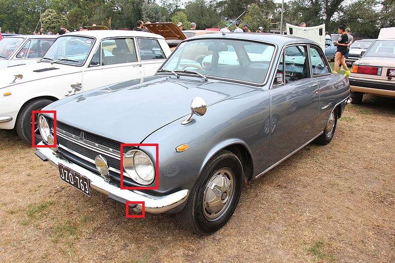

Meanwhile I bought some parts for the Bellett through the years...but I'm still looking for some parts, can you help me?
I'm looking for the front blinkers and the headlight trims.
Thanks guys ;)

Both of those items are very rare to find as spares.

Hi
I have clear copies of the beehive lens but not the metal surroud
As Glenn has said the headlight surrounds are very scarce
Flying

Maybe I'll try to make metal surround replicas :? It's possible to find similiar lights/lens from other classic cars.
I believe that the most import thing to find now is the headlight trims, because I have the front grille but the trims are missing :cry:

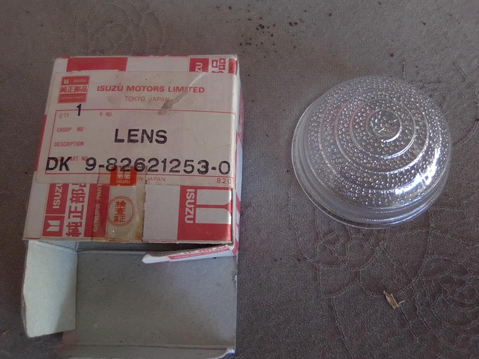

I have a set of the beehive (GT) lenses for sale. PM me or go to classic isuzu on Facebook.

Morris 1800 look similar, maybe they can be modified to fit?

KJB wrote:
If it does not fit it is a hellava good start...……….that has got to be better than nothing (how many of them are there out there ?)…......you must have "eagle eyes.."
As soon as I saw them I remembered those old pommy cars having a similar looking headlight trim. Used to be a quite a few around when I was a kid. Hopefully the parts are still easier to find than GT Bellett bits!
I didn't knew this Morris 1800...they really look similar. I will try to find the Austin trims.

I have both types, the Bellett ones are pressed alloy and tend to get banged up a bit but the Austin ones are cast then chromed. The Austin ones ar a bit deeper too and in my opinion look better, much better quality but totally different mounting.
I am actually using the Austin ones on my GT instead of the original Isuzu ones (which are a bit beat up anyway)
