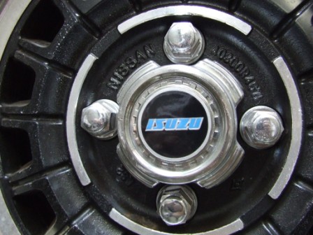

Here's a bit of a teaser.

Does anyone want center cap stickers, currently have 44mm diameter Isuzu ones, other sizes upon request (check out picture in here somewhere).
