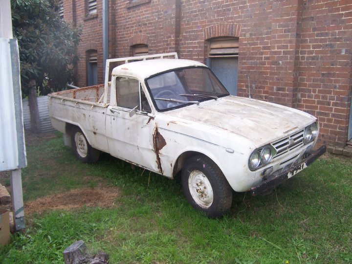

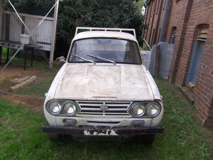

ok might as well give this a go! since i know bugger all about the wasp, and since the plate with all the details on it has evaded me, i thought i might leave it up to you guys to fill in the blanks!

Holy crap dude that is not overly worse than mine!
Not much that can be filled in though; the build date info etc was never printed on them.
Probably the best bet for you is to check out the Wasp brochures for the original specs.

i would /should be able to help you out with rhf door.i am under 2hrs away from you maybe 3 in a stock wasp :lol:

koolies. i wasnt sure exactly what to do about the rh door, im assuming someone had left the door open and reversed into something quite hard! what do you reckon condition wise? i know it will be a mission either way, but it would be worth it though hey?

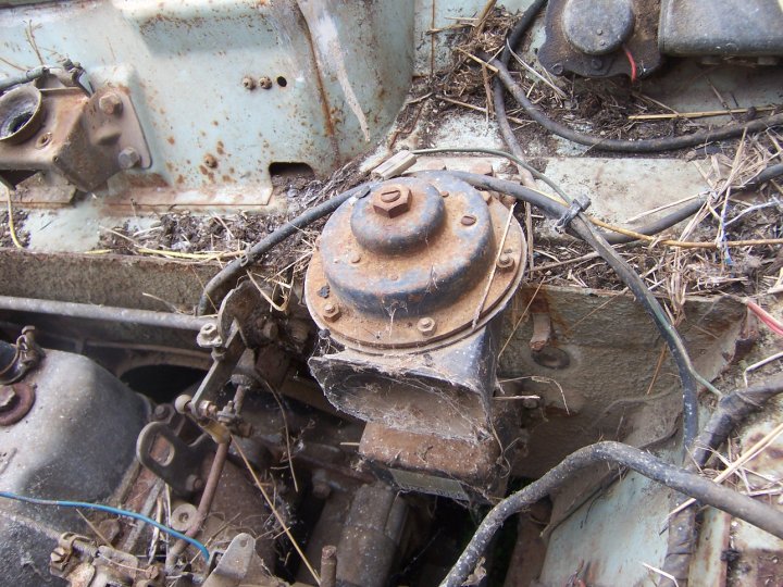

got the other pics working

Holy shit dude, that Wasp is about 75% as good as mine, and mine is running and registered (uh, except for a current head gasket issue!).

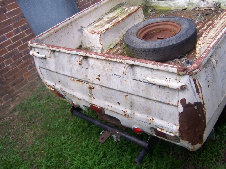

Oh yeah, I noticed that the rear reflectors appear to be the original ones, although someone has moved them to make the rear of your car look a bit cross-eyed! A look at some of the stuff above should reveal where they're supposed to be.

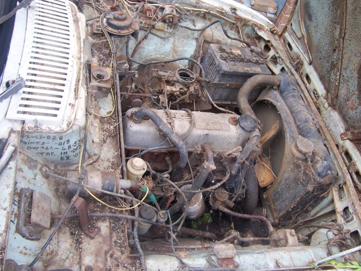

also i had a look earlier for any details about the engine, and the only thing i could find was G161 stamped on the block. does anyone know what that means?

Yeah man it looks like it's got an Isuzu Florian/Chevrolet LUV 1600cc engine, rather than the G150C 1500cc donk that would have come with it.
The 1600cc G161 from the Florian/LUV is a straight swap, but the Gemini G161Z doesn't bolt straight in; the Bellett runs the mounts way down the front of the engine, while the Gemini runs them about half way along the motor.
I've seen pics of it done, but the Isuzu G180 and G200 DOHC motor fits in stacks easier as the mounts are in the right place, normally.

Just looking at your pics again, I'd go so far as to say that yours has LESS rust in it than mine!
Plus they often rust in the roof.... which is a fairly big job to sort out, however yours appears to have not, which is good.

yeah well considering it had been in a paddock with one door wide open for over 10 years, its in reasonable condition. the interior suffered a fair beating from the weather though. i looked at another g161 on google, and the numbers are in a different place to the ones on the wasp. dont know if that means they are different era maybe? also how would i go about getting seats? as mine are just springs at the moment =)

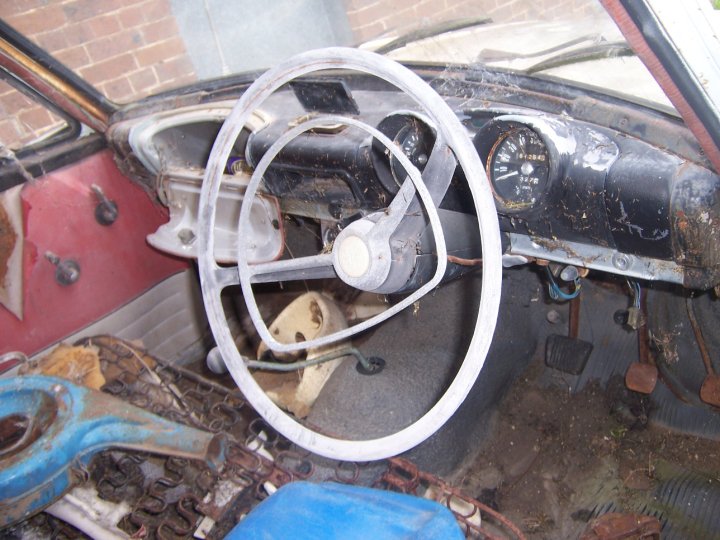

Hey "Waspy", Thanks for showing us your fantastic find - one of 7 stylesides I know of. Amazing how much a good cleanup helps. If your seat springs are not broken, I reckon the best thing is to re-upholster the original bench - gives you the max legroom. About $400 where I live. Try getting the motor going. I recently got one started that had been sitting for fully 30 years! (See 'Barn Find' in My Bellett section) Put some penno down the plug holes, leave for a couple of days then wind over. If you have compression enough to push your thumb off the plug holes, it will probably go. Put some cheap clean oil in the sump before starting. Maybe you'll get a nice surprise!
