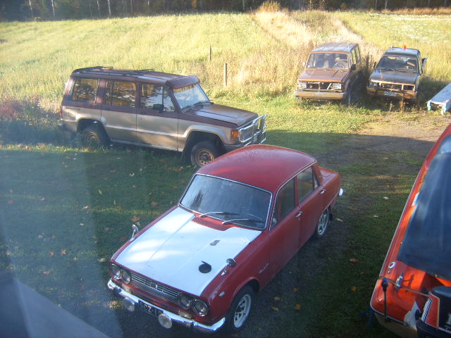

My Bellett is a four door sedan. It is fitted with a 4ZD1 single carb engine and a 5-speed gearbox from a Isuzu pick-up. Front brakes come from a Ford Sierra.
Here's a wiev thru my livingroom window.
Tuomas

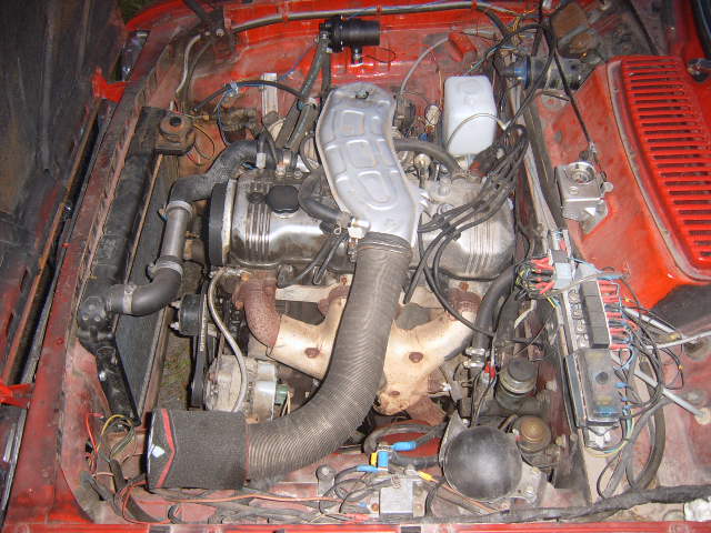

That's a 4ZE1 in Anttis race Bellett with webers etc. A pic of mine fitted with 4ZD1 (2,3l) is below. I once had a petrol heater in that engine compartment. It almost burned up the whole car. Luckily the fire department was quick enough to save it from disaster. You can even see the cinder on the firewall :? .
The most difficult part was to find an intake piping for the updraught carburettor to fit under the standard hood. This one is from a Mazda E2000 van! The oil filter had to be relocated as well.
Cheers, Tuomas

This is how I did the conversion:
I took the 4ZD1 engine and gearbox out of a '90 Isuzu pick-up. Along came the drive shaft and engine wire harnesses.
I Mounted the gearbox to a '68 Bellett gearbox frame by usin steel plates as an adaptor. There are two one inch tall rubber bushings between them. The Bellett speedo cable fits and is quite accurate. The clutch cylinder is original Bellett mounted with a steel plate extension piece.
The motor mounts are two steel plates welded together on each side. The right hand side mount has the oil passages, as the original oil filter post is on the same spot. Oil lines go thru the mount and via rubber hoses to the original 4Z oil filter. The motor mounts have the original Bellett rubber bushings.
I used the 4ZD1 exhaust manifold and downpipe from the pick-up which fits nicely on Bellett. The 4Z clutch fan had to go. I have a Datsun 120Y electric fan instead. I got rid of all that smog equipment as well.
That's about it. I think this can be applied to 4ZE1 conversion as well. You'd want to use the 4ZD1 oil pan and oil pickup pipe instead of that high volume cast aluminium pan of the 4ZE1. I doubt if the efi throttle body fits under the Bellett hood. There may be some interference with that steering axle there on the other side of the globe ;) .
Tuomas

2ldohc wrote:
Doesn't sound like a massively difficult swap...
What problems did you run into while doing the change over?
I'm weighing up the pro's and con's of putting this engine into a Bellett or a Gemini.
I had the side engine mounts custom made for me. Especially the one with the oil passages needed some accuracy. Thanks to my father-in-law! ;) I believe that AriNojd has the same kind of design in the engine mounts of his GT with the 2 litre twin cam.
The main drive shaft had to be welded to the Bellett one and balanced in a workshop.
The carburettor has some solenoids and the automatic choke on it and they needed to have voltage while the engine is running. It took some time to figure them out. Of course you'll have the efi or double carbs on the 4ZE1!
I moved the alternator over slightly and so I had to find a new drive belt to fit. There's only little room to adjust the tightness of the belt. I used the shorter Belletts adjusting bar on the alternator.
Those are the main problems I remember now. Not that bad. Four weeks of work after daywork and it was moving with the 4Z engine. The trouble of getting it legal is another story...
