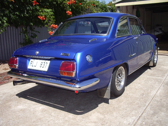

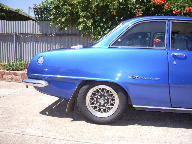

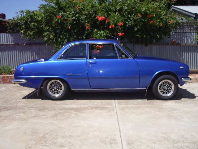

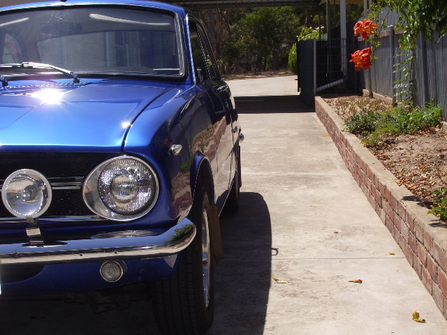

Well, Finally got to it. Here is the little beast...If you guys were wondering about my credability (maybe some internet freak who keeps crashing the party...NOT!?) Next posting will show three more pics, interior and rebel original engine included. Part two incoming now.

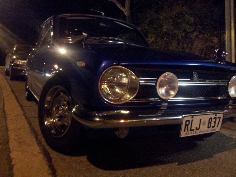

Part 2: some history, My first original silver and red trim 66 totaled in rollover. Bought this 65 from TAA pilot in Adelaide about 1990. Project was to salvage the wreck and do up body of this one. Don't know why, but they grow on you. Swapped best of interiors and running gear myself. Body and paint compliments of "Jamestown Crash Repair" family owned business in midnorth when I lived up there (for 25 years). Engine rebuild in about 1994 by young mechanic freind (who is destined for greatness in the mechanics world). Bored out, mild cam became hotter, and high performance parts fitted, though kept the looks rather original from the out side. Has only done about 20,000 miles since. Has a few very minor scars from living in the sticks, but enjoying a new existance driving it on good roads. Drives well, lots of fun but some work to do....Front end bushes and sloppy rack, has no rear breaks or handbreak (siezed), and yes, like your front seats Dave, consistency of violet crumble. You guys have given me a kick to get these things sorted. Hope to gleen more of your wisdoms!! Please comment !

love the colour, looks really nice mate!
Sun Feb 15, 2009 9:06 am
Really nice example... That paint looks new and as mrfibbles said... love the colour too :)
The interior looks really nice too! I can't tell if the dash is cracked but judging by the rest of it there won't be much there to worry about!
Thanks for sharing the photo's.
R.
Sun Feb 15, 2009 10:47 am
Gee thanks guys (blush),
Paint new ? Cameras can hide the truth. You expect to get some minor chips and things if you've spent some time on those kinda roads. Nothing seriuos, but if I pointed them out in heart to heart inspection, each tiny defect has a story. Dash has substantial crack in the middle, but I got a near enough dash mat and cut it to size. It keeps the otherwise Ok dash protected. Been following the Dash thread and am amazed there is a templet in OZ and it's being shared around !! If anyone wants to know the name of this metalic 2pac, it was ironically called "Honda blue" back then.
Do you think the suspension height is right, especially the rear, after Alistairs experience.
Cheers.

I have NEVER seen this car ever!!!! It's really amazing to see this SA car that I just never knew anything about!
But every now and then, one of them pops up that I'd never seen or heard of....
Not that I've been around forever, but long enough that I sniff them out a bit, plus a lot of people know me about the place now and tell me about one they've seen... and more often than not, I say, "Oh yeah I know that car (or owner)".
But yours is just... just an awesome surprise!
Mon Feb 16, 2009 10:16 pm
Looks like I,ve tickled your fancy !! No shit, about ten years ago I had a blind moment and was a stage in life I nearly sold it. After adds in the unique car mag, a guy from WA rang and said " is that the dark metallic blue one with the......?" That was spooky! Made me realise there were dudes like yourself out there. But yeah, you'll be seeing more of it around the streets here. Can,t wait to go for a cruise this weekend !

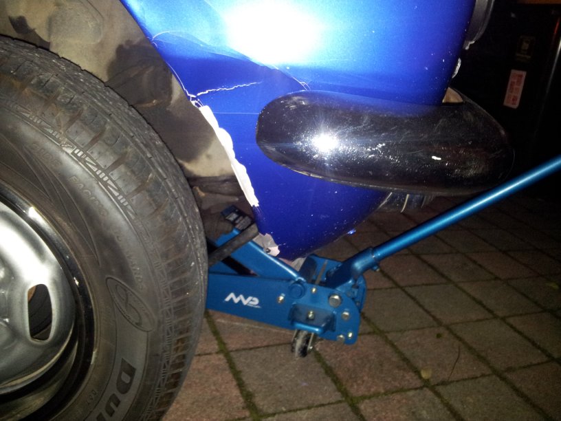

It's been three years, but it's about time we dredged this thread up as there have been some big dramas with Bruno's little blue Bellett!
Just over a week ago, Bruno swung by with his boys to say g'day, then left.
About ten minutes later, I get a call... something is broken!

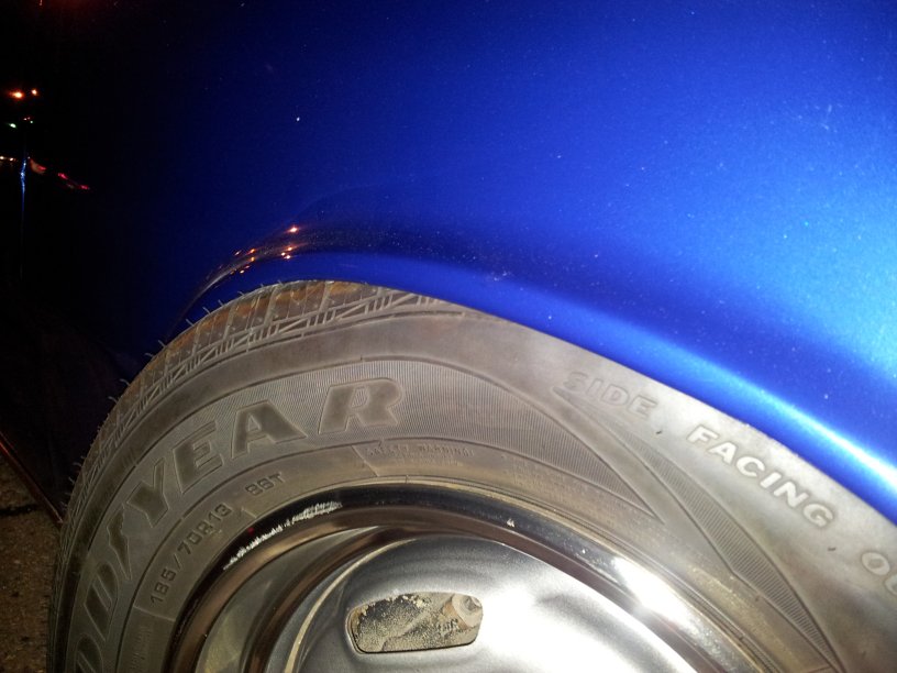

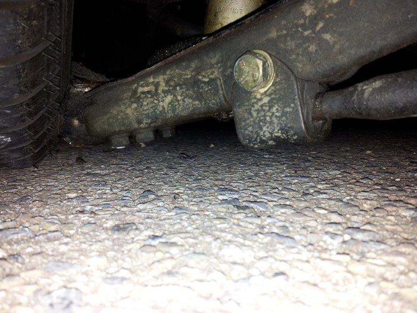

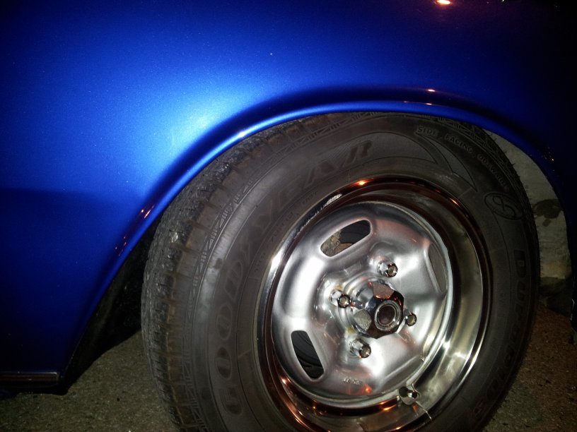

He'd called the RAA and was waiting, but the front wheel was not at the right angle and the car was undriveable. Plus he and his crew were going to need a lift home... 40km away.
When I arrived, Bruno had reversed the car away from a sign he had parked near to try to allow room for the towie, however the front right side had completely collapsed with the wheel shoved deep into the guard.
File comment: Sick camber and offset... really sick.
Flagstaff Hill - Flagstaff Road - 07 July - Bruno's broken Bellett - 03.jpg [ 90.39 KiB | Viewed 44228 times ]
File comment: Can't even get a cigarette paper in the wheelarch... this is usually a problem at the back.
Flagstaff Hill - Flagstaff Road - 07 July - Bruno's broken Bellett - 05.jpg [ 78.57 KiB | Viewed 44228 times ]
File comment: Yeah, nah... this is a problem.
Flagstaff Hill - Flagstaff Road - 07 July - Bruno's broken Bellett - 06.jpg [ 74.28 KiB | Viewed 44228 times ]

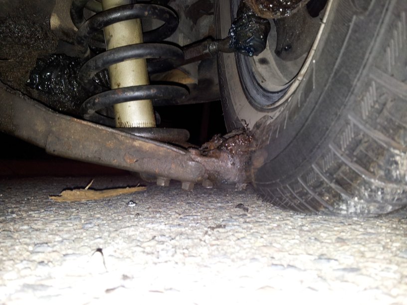

The RAA dude arrived and absolutely dicked Bruno; he claimed that as the suspension had hit the ground and therefore the incident was an accident.... despite the fact it hadn't hit the ground yet. Yet.
File comment: Balljoint has not hit the road despite what it looks like.
Flagstaff Hill - Flagstaff Road - 07 July - Bruno's broken Bellett - under car - 02.jpg
Flagstaff Hill - Flagstaff Road - 07 July - Bruno's broken Bellett - under car - 02.jpg [ 111.18 KiB | Viewed 44228 times ]
Flagstaff Hill - Flagstaff Road - 07 July - Bruno's broken Bellett - under car - 06.jpg
Flagstaff Hill - Flagstaff Road - 07 July - Bruno's broken Bellett - under car - 06.jpg [ 90.25 KiB | Viewed 44228 times ]
So then the accident tow truck guy came and advised us the tow would be $375 for the first 20kms. Yeah.
He was good enough to wait around; Bruno was on the phone endlessly to the RAA, their supervisors and you name it... all the while, his 11yo son Jason and 15yo son Bradley were tired, hungry and freezing their butts off. Good kids; they didn't complain - I was bitching more... and I didn't take a warm jacket because I assumed we'd be on our way soon.
Eventually, the incident was un-deemed an accident by the police dispatch people and the towie was able to tow Bruno's car as a private tow for $130.
But the car wouldn't move properly, as anyone who has dropped a balljoint before would know. I took off up the road and got my trolley jack and brought it back. In hindsight, we should have pulled the wheel off, but hindsight is a wonderful thing.
So as the car was being dragged backwards, the wheel hit the guard and ruined it... so now it didn't matter what the tow cost, because it was going to be an insurance claim (thanks Shannons).
File comment: Damn.

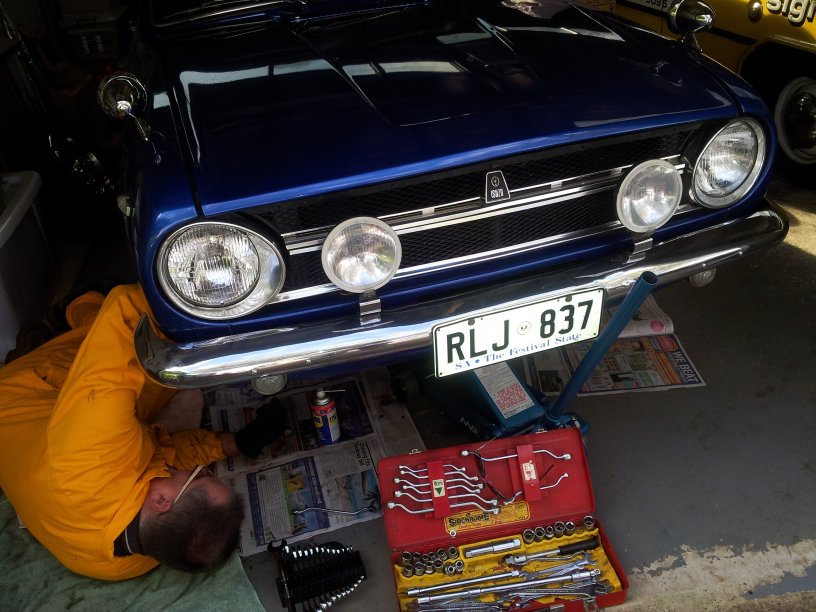

Bruno had been banging and prising the offending balljoint for two hours with no success and had turned his attentions to replacing the four bolts that hold the balljoint on over on the left side; just to be certain.
File comment: I'm sure he just loosened it for me.
14 Gundowringa Ave - front yard - 12 July - Bruno fitting new balljoint in shed.jpg
14 Gundowringa Ave - front yard - 12 July - Bruno fitting new balljoint in shed.jpg [ 105.54 KiB | Viewed 44228 times ]
Well, I gave it a couple of whacks and did some Jedi stuff and it, like, fell out. I had to tell Bruno three times before the words would register.

Now I've finished with the massive list of credits and accolades I guess I should tell it how it was. Well, for any one who has ever had a steering component let go, well yes, there is a butt tightening moment when the car starts spearing off to one side and then the other. The only way to keep bringing it back in a straight line is to steer opposite to which direction it is shooting off at. The drive train threatens to lock up and the rear wheels have a little chirp in protest. Not to mention the ugly noise as everything is flapping loose under the front. Thank Christ it was at 60 km's, but still fairly steep downhill decelerating from 80 km. The dude in the Omega behind me, who had been following at some pace for the last few miles, was switched on enough and gave me instant wide birth to pull her up. I remember saying something like : "Shit, somethings gone in the steering....just HANG ON !!" Jason, 11, was in the back seat. I later asked him how it felt when it let go? His answer was "Like an out of control elevator, Dad !"
The rest, you have documented so well, Dave. To put the ensuing long hours into perspective, the Beastie came to rest on the roadside at about 6 pm, and Dave finally made it home at around midnight, if not later!! Doesn't time fly when your having fun ??
Here is the diagnosis. The ball joint in question was the only one on the car which didn't have a grease nipple, and I've always complained about a little squeekyness on that side. Sometimes a little stiffness as well. I had always thought this was a sealed unit which had replaced the original at some stage. WRONG!! Inspection of the failed part shows the grease nipple had been most likely knocked off at some point and never replaced. Hence, it was not recieving any grease to keep it mobile !! So eventually the top of the ball housing had to sheer off.
Initially, we all thought it was the 4 bolts holding the balljoint assembly on, which we have all been warned to replace as these are most likely to give if they are original. Not so in this case. I did replace them all anyway, even though these original bolts didn't appear too shabby. Good insurance tho.
So the moral of the story is : If one of your ball joints doesn't have a grease nipple, don't assume it is a sealed unit wich has replaced the original. And if the rubber boots on the original joints are a little rooted, make sure you grease regularly enough.
