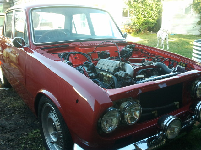

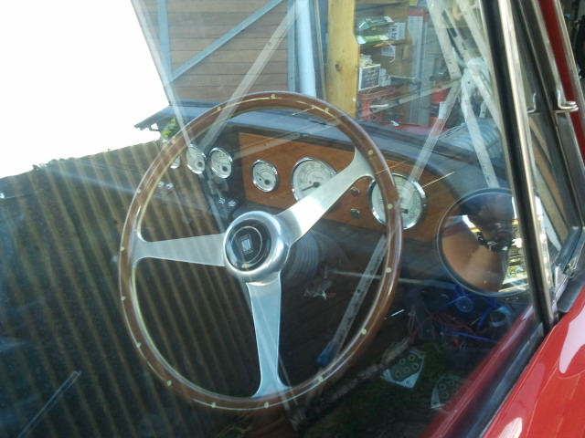

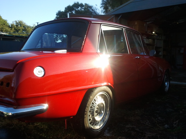

Here's my pride an joy, its been about 20yrs of on and off work on the car, mostly its in the garage but i get it out every now and then to give it a tubs and think about the good old days when life was a bit simpler.
Engine - 4XE1-WT
Gearbox - Nissan FJ20 Turbo
Wheels - Sigma Turbo
Brakes - Mazda RX7 - Series 4 (4 Spot)
- 11" Ford Discs
Guages - Classic VDO
Steering Wheel - Nardi
Seats - Cobra Classic
Chris

oh thats very nice, bet it goes well too!
I like the dash treatment and the steering wheel looks good too, Is the paint the origional colour?

Every little step there was a modification to be done.. from the Throttle Body swap to the Waste Spark ignition, it only just fit in, no intercooler though I have routed the pipes down so i could mount one in front of the car at some point but i think it would ruin the look.

I have an oil cooler mounted in front of the radiator where the three air holes are, it would still be a bit messy with the pipe work for an intercooler. Amzing how time flys one miniute your going to the Nationals the next Married with a couple of mortgages.. I googled Bellet and came up with this site.. very cool, I remember sending a picture to a bloke in the Netherlands when i frist started putting the engine in.. but i think its gone now. a mate got me enthused again when he bought an RX2 a few weeks back in bits, i read that someone thought the car was photoshop myth so i joined up.. its great to see there is so much intrest in the cars out there.

I need to finish the exhaust system, interior and re-do the bonet. but thats about all, fun to drive.. I have run it up and down the street a few times stright out exhaust at the moment so you here the turbo spool up and then when you hit the blowoff valve.. it does spin the wheels nicley, i put a ceramic paddle cluth from a GTR skyline in it.. so that holds up all ok, its just got a standard diff so i dont really tromp-it to much. other than those few things its all there rearing to go.. just need the $$$ to finish it off, you learn as you get older that there is so much more than cars.. House and a wife.. well lets just leave it there.

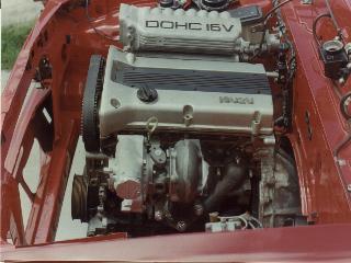

Here's a picture you sent me years ago.........
Sun Apr 29, 2012 11:50 pm
Posts: 234
Car(s): 65 and 66 sedan
That looks fantastic. Did you get the motor out of the U.S?

The Motor is out of a JT AWD Gemini, its the same as the Lotus Elan S2, Isuzu Built it to for the Elan but ended up putting it into the AWD Gemini, I had one of those for a few years but sold when i bought the Hilux, best thing ive ever bought.
I need to pickup a new battery to get it out of the garage, that's in the boot now, running a Commodore VT Battery, a couple of fuel pumps and a small surge tank.
