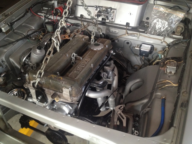

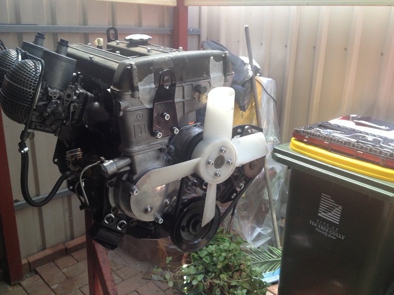

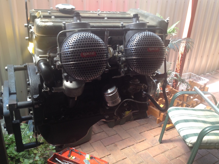

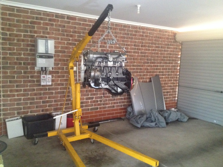

I has been ages but now I have the urge to get my car back on the road for the Summer Cruising Season.
The motor had blown the Head Gasket which started the pull down.
Got the motor machined, balanced, ported, polished.
Here's some pics

The Joys of trying to work out of a carport.

It really does look like the Twin Cam shares the bottom end with the G180ss SOHC motor
Same water pump anyway

They are the same block. The twin cam has 3 cams as the cam in the block still remains and a welch plug covers the dizzy hole as well as driving the oil pump.

No twin can I've ever seen has a welch plug in the dis hole.....
They either have an oil breather / separator to vent the crankcase on early ones or a hose from the back of the head to the a fitting in the hole for breather / head oil drain.
I'd seriously be looking into that as too much crankcase pressure will cause blown gaskets.
Mon Dec 14, 2015 1:08 am

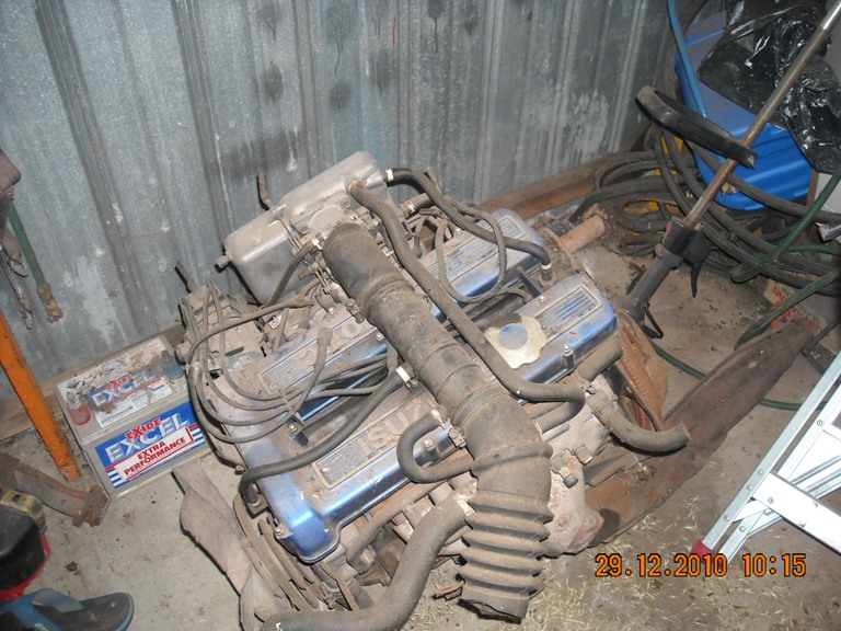

On My Motor which is the g180w Blue Top (rocker cover being painted hence the Green Top )
it is different to the early ones with the breather box in the distributor hole
Orph is correct as mine had the welch plug in the distributor hole, it has a pvc valve at the back of the head which originally went to the plenum in the fuel injection and also had one in the front of the head which T'd into the air cleaner tube
I have chosen to knock out the plug and fit the breather box
At the front right there is a small tube in the sump that is the oil return point
Hope this helps
Cheers Flying

The 2.0 in my Wasp came out of a Piazza. It has the pressed in fitting in the dis hole and a hose from the back of the head fitted between them. I'm told its does oil drain and breather duty. It also has the PVC at the back of the head and another tube breather at the front of the inlet cam (from memory..... car isn't with me atm and won't be til next March).
