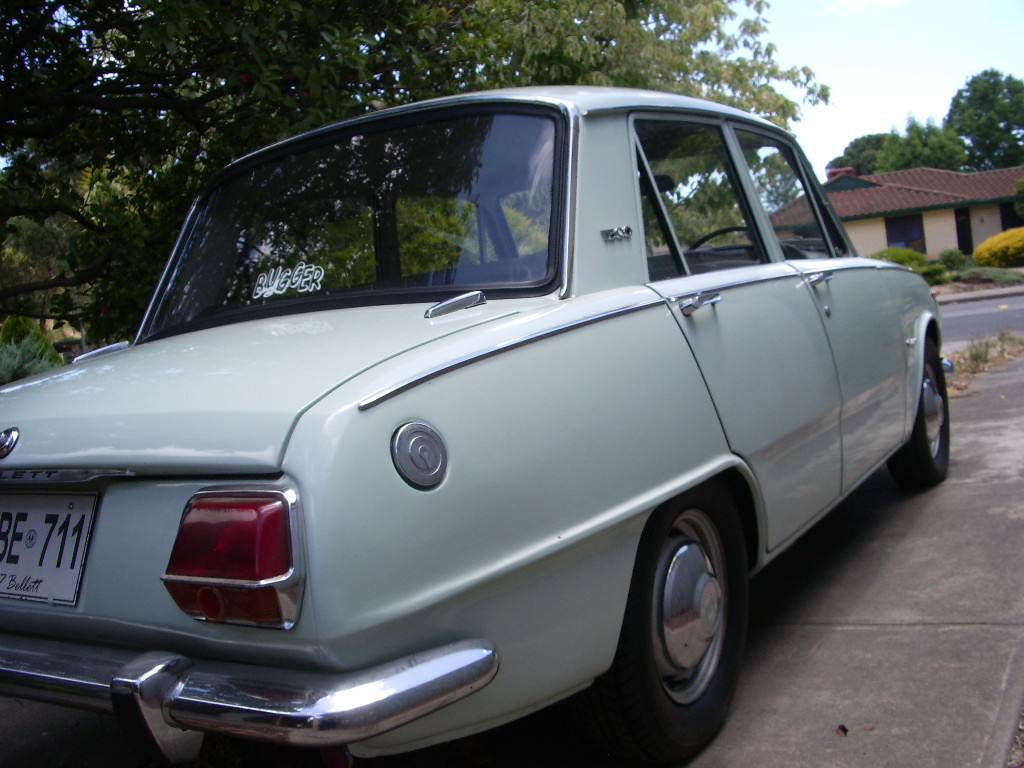

This is the Li'l Darlin' (attached)
Like many pretty little things, she is grumpy in the mornings and prone to throwing tantrums when she doesn't get her own way. (My wife is NOT like this, if she is reading)
For the last 5 or 6 years these tantrums have mainly involved throwing coolant out of her exhaust pipe in large quantities. Nothing I have done or said (mostly expletives) has cured her of this habit, despite vast quantities of money.
After my last bout of excessive expenditure, designed to cure the problem she was finally able to roam the roads, once again. For a little while. She is back to throwing coolant out of her exhaust pipe again.

has it blown a head gasket?

No Mr Fibbles,
I've replaced the head gasket about 5 times. Each time I've had the head off to machine the face or rebuild it. None of the gaskets have shown any signs of a leak path anywhere.

Well what gets in must come out......
If water is getting into the bores and its not through gasket failure, then perhaps a crack in the head or block............

Posts: 53
The head is fine, J. Had it heat tested, put it back on, then gas tested and back on (you can see how the head gaskets are adding up). The face is dead flat. The block is also flat to within 0.5mm. The culprits are bores 2 and 3. Maybe cracks in the cylinder bores But I can't find them with scrubbing the bores with turps. Anyway the block has to come out so i can fix it or junk it and rebuild another.

Fri Jul 29, 2016 6:00 am
sounds like another block is on the cards, at least you can rebuild the new block so its fresh when it goes in.

I have a suggestion. Brother Gary had a Crown that was filling 1 bore with coolant on standing overnight. He had to remove a sparkplug and suck the coolant out before starting it. It had had a full rebuild by the previous owner.
So he went to Supacheap and bought the big bottle of Rislone. Its either blockseal or head gasket fix, I forget, but the big bottle. About $75. He added it straight to the coolant as directed, no need to flush or remove antifreeze. Ran it the required time and turned it off. Next day it was dry in the bore. Fixed! Thats over a year ago and its still good.
This might be an inexpensive and quick thing to try.

My prescription is time. Li'l darlin' just wants your time. But I would try the Rislone, it could be the answer as if the coolant can get into the bore, the Rislone can get into the hole.

I intend to try the Rislone treatment and see if it settles her innards. I'll also start work on another block if i can find another good one. I'll let you know how it goes.
