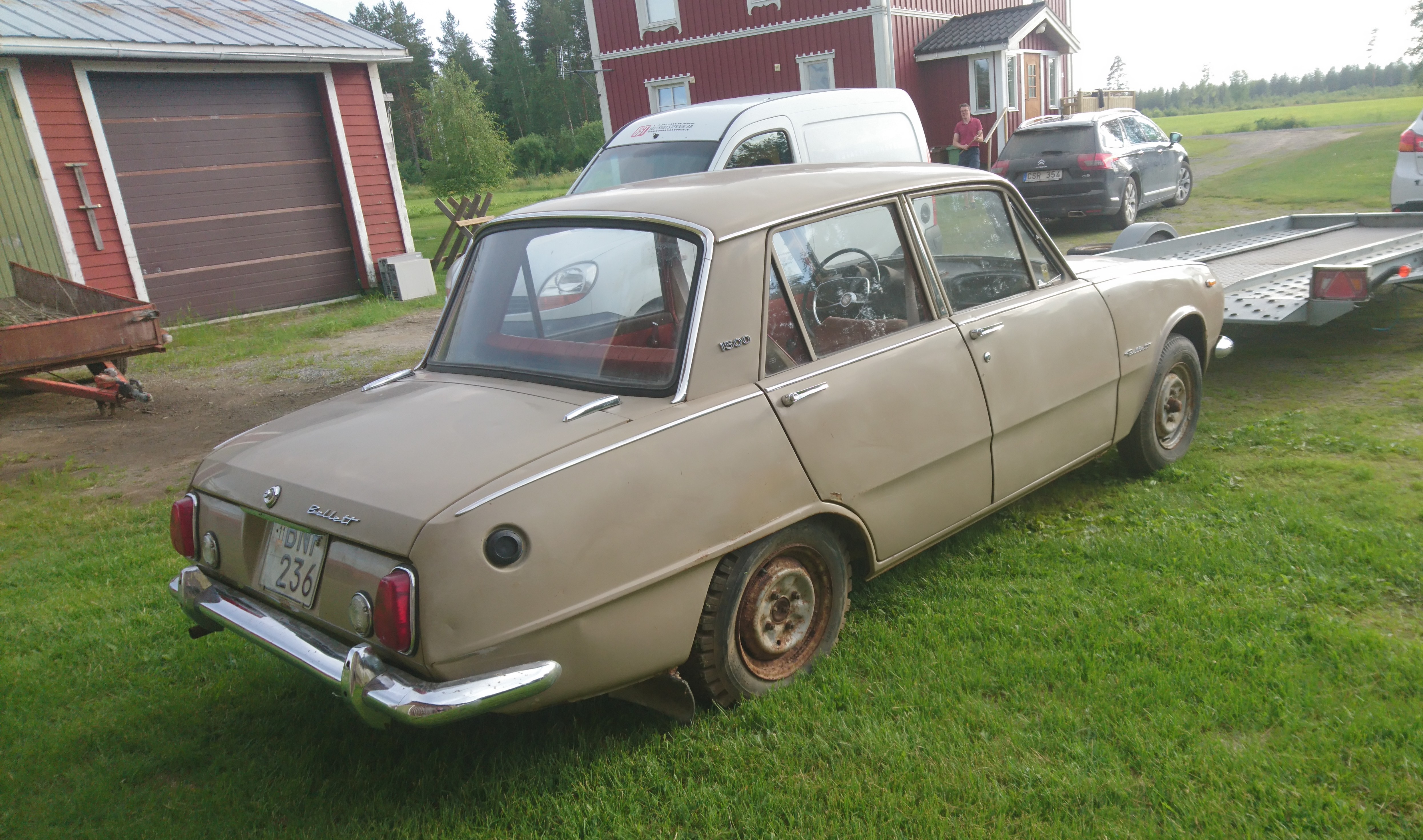

So... I found a Bellett here in Sweden! that hopefully will get back on the road someday, awesome car! but have been "off the road"/parked since 1977... any tips on finding parts? Clutch, brakes, engine stuff is the most urgent things

Yea I have never even searched for a Bellett because I really thought they didn't exist in Sweden but I have wanted one for a long time...
All of a sudden one appeared in a japanese car group on facebook and not so far away from where I'm spending my summer vacation :shock: sooo my vacation got really interesting really fast :lol:
I'm absolutely gonna keep it! and get it to running/working condition with whatever parts and things I can find, make or get renovated and later someday in the distant future :D try to get it through the swedish car inspection...
When it passes that and is legal for roaduse again it will probably get a complete teardown for some serious renovation.
Ok yea I've seen that there is quite a bit more Belletts and other old japanese cars in Finland compared to Sweden so I will start looking there for parts and stuff.

You are so lucky as the body looks to be in reasonable condition and the mechanicals are simple.

Thanks for Posting those pics. . Exciting time - "picking it up ....."
Generally more pics. at the petrol station while refueling the tow car and having a coffee before the trip home .........
A quick clean up and polish will make the Teardrop look a million Kronas......!

Wow what a great find, a tear drop in such good shape!
Really looking forward to seeing your progress getting it on the road

All the pics are taken at my brothers place where I "dumped" it for now since I'm spending my vacation there and since it was kind of far to drive it all the way home to Kiruna (~900km north from where we picked it up and ~200km above the arctic circle :D )

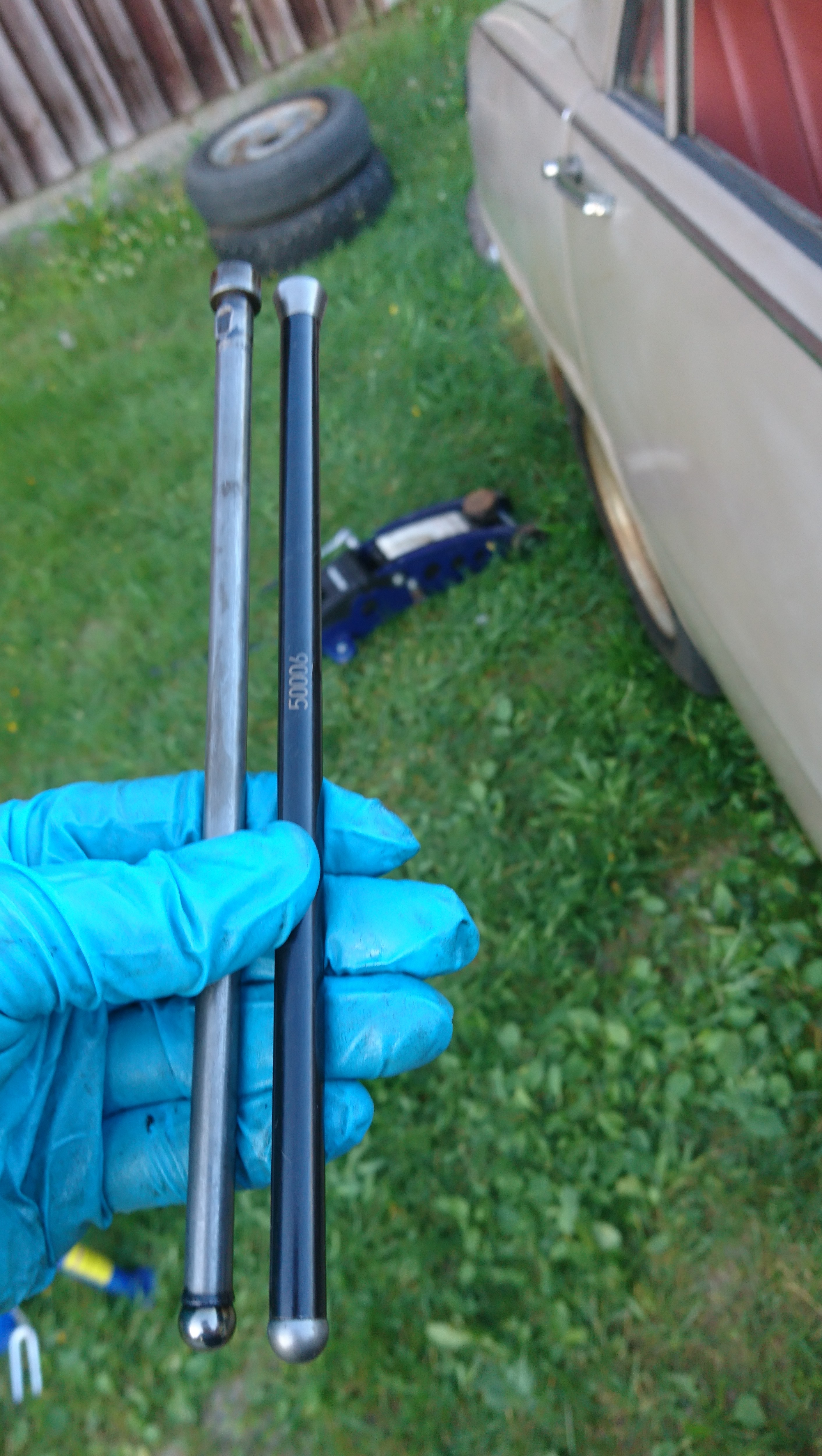

Finally got my custom length pushrods that I ordered! fits perfectly and doesn't rub anywhere, nice! 8-) had to use some "Tecnosil" black sealant on the very very old, crispy and broken valve cover gasket since I didn't have a new one laying around :D
Did also get most of the interior electrics working, gauges, lights, warning lights and switches.
Annnnd... Got the motor running aswell! Sounds awsome with a straight pipe :D until the carb bowl runs dry... since I haven't rigged up a fuel system yet :roll:
