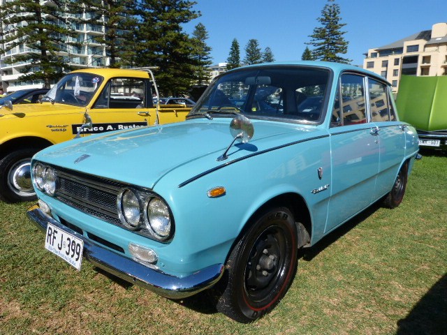

First post is the small contingent of Belletts, Isuzus. We attracted a bit of attention tho. There's something about Dave's Wasp, so freakin' original. Ross Deluxe likewise, it's got 'tude. And yours truly not lacking horness.

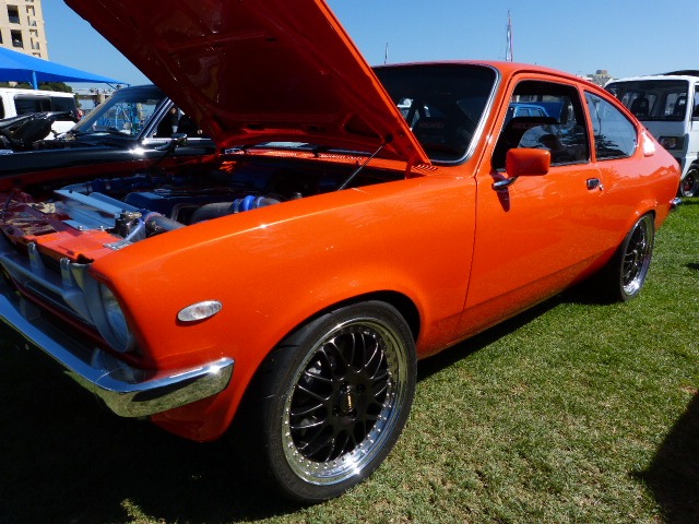

And some favourites from All Jap 2013. I did snap about 150 pics, but won't bore anyone with the lot :mrgreen:
The Datto 2000 was cool as and apart from Tom's unusual Bluebird, the old Cedric, and the Belletts, was the only other era classic to be seen in the paddock.
The Gemini fastback is for you, Antus. Nicely prepped, and sporting a nissan twin cam.
The shovel nose Coupe was rare as !! And the 260 zed's were out in full force, this one catching my eye for it's unusual faded racing livery, racing ratter 8-)
