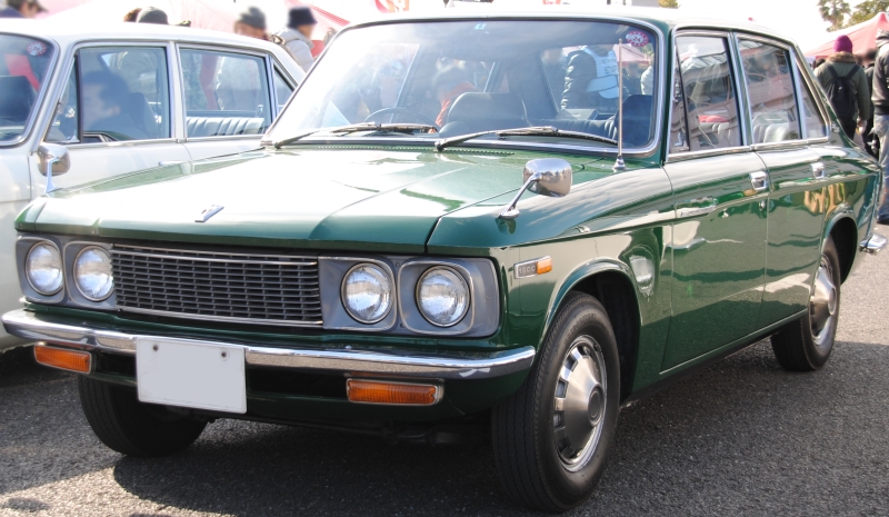

Sun Oct 27, 2013 9:29 pm
Hey Orph the 72 Florian has basically the Chev Luv front (will up load a pic)
Now that with the Chev badge and power plant would be Awsome :twisted:
Sun Oct 27, 2013 10:09 pm
pa_man you find a florian, i have some luv panels here, we will make it work!
i would kill for a late model florian myself, or just the front panels and dash to put into a luv!
Mon Oct 28, 2013 2:05 am
Ha They Chromed the Luv bumper bar :lol:
Reckon that Flo front would bolt straight in with all existing Luv panels!! :o
