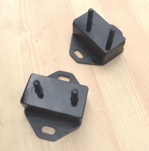

New re conditioned engine mounts on ebay:
http://www.ebay.com.au/itm/172080416674 ... 1555.l2649
or:
A&A IGLIO ENGINEERING
8 Hill rd, Wingfield. 5013
PH: 08 82432016
They specialise in vulcanising all types of rubber mounts.

I got a set of these a couple of months ago (were slightly cheaper then I could get a one off set done locally)
Price has gone up a little since but that's to be expected as their supply gets lower
Get em while ya can I always say ;)
