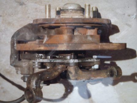

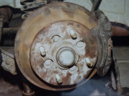

Hi everyone!
I wonder if any of you are able to identify the calipers fitted to my Florian, Aunty Mary?
They came already fitted up and look like they were meant to be there with no signs of modification. They look as though they bolted straight up.
They are a simple single piston with sliders, which are free. They use DB85 pads, which I have a new set of.
My problem is that lately the left piston has been has been binding. This has caused the inner pad to drag a little, which has worn away the pad. Despite a fair bit of force, I can't get it to retract.
I'm off the road until I identify the caliper and get a kit.

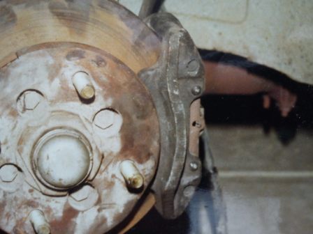

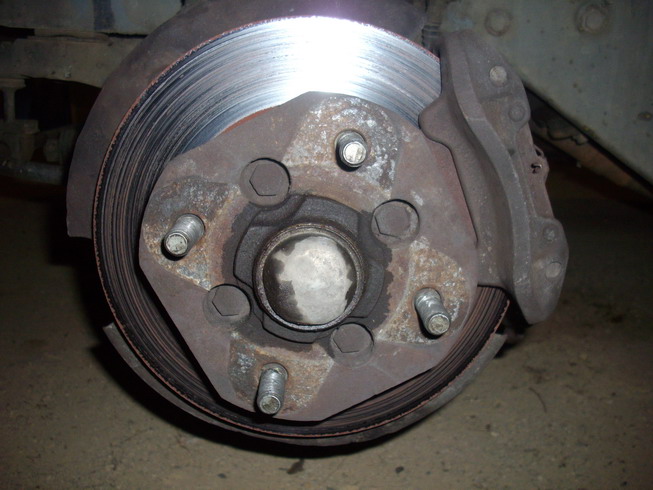

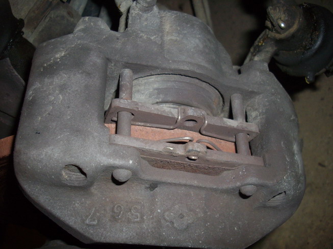

OK, some pictures of my early sedan with Sigma disks. You can see the caliper looks the same as yours.
I think some Galants had same setup but the 'cutoff' type hubs. Need confirmation of that.

Ahh, looks spot on Glenn, thanks. I'll order a seal set tomorrow. :D

yep, is the GD Galant version of them.
the hub was slightly different, but used the same caliper as the early Sigma.

So, I got the kit, ripped off the caliper. The piston was so tight I had to shock it out between two blocks of wood. (Pedal pressure wouldn't budge it!)
Trouble was the outer seal had a small hole pierced in it which had let moisture in. The housing had rusted up & the piston jammed in the rust. (It did sit for 12 years.)
A quick hone, kit fitted, and good as new. New pads in & it stops like ........ like a car with brakes on it! :o
Kit number is K861S : Caliper kit MM 50.65 : Mitsubishi Colt, Galant. Toyota.
From Autopro.
Thanks for putting me on the right track.
Cheers, Matt. :D
