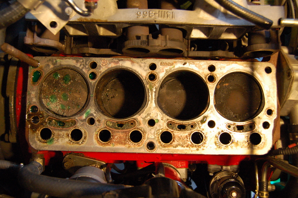

Heading back to Adelaide a couple of weeks ago from SA's Riverland...... lost a cylinder outside Murray Bridge.... yep, $250 tow back home. Finally got around to getting head off tonight, hoping for 'just' a valve or head gasket issue.... take a look at cylinder #4 below. WTF!

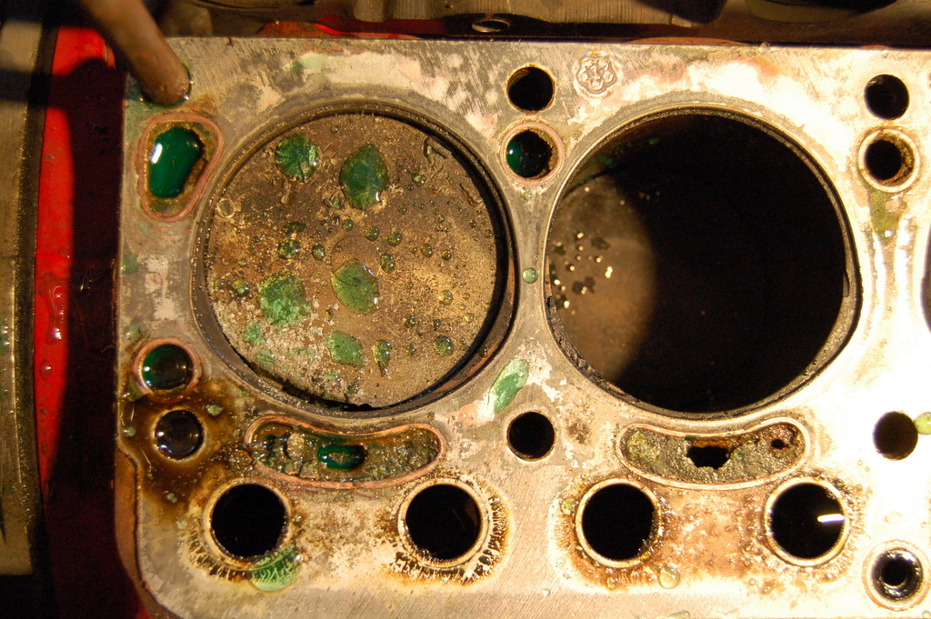

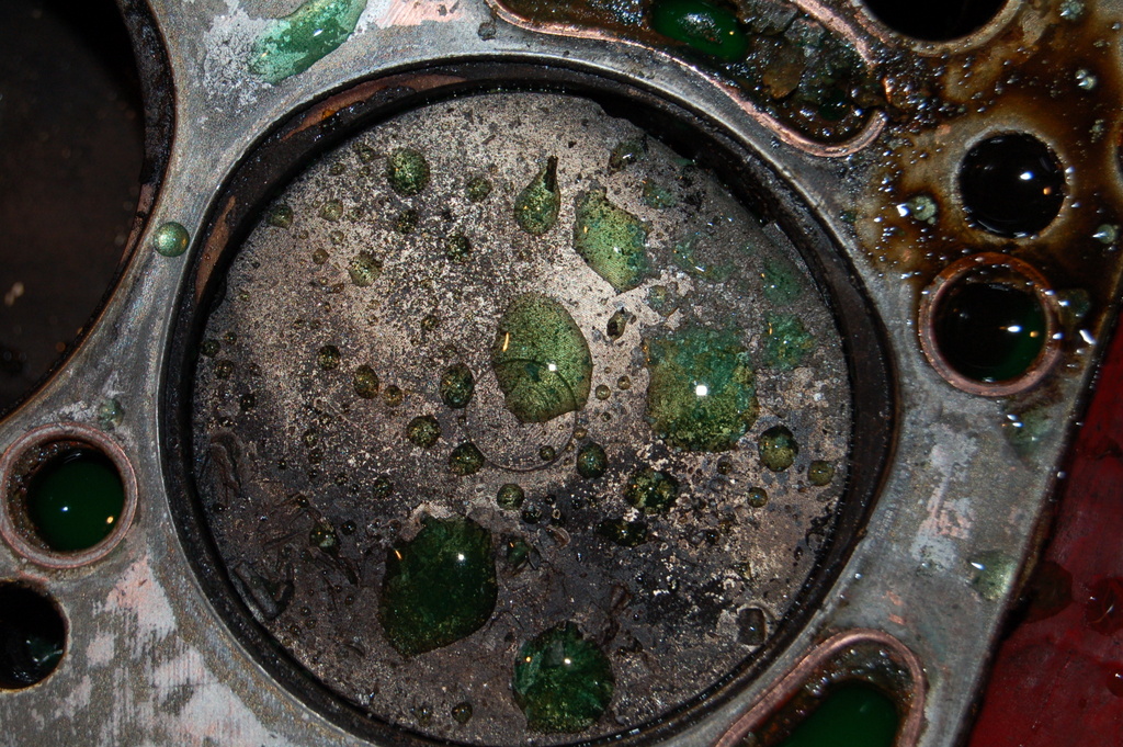

What's that all about? There's a bit of piston missing! Any suggestions on how the hell this happened? Here's a closer look...

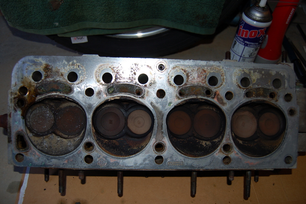

And here are images of the head.

Hey Paul,
Looks like you got a lotta corrosion built up blocking water flow through and
past the top of the pistons especially #4, causing overheating and the meltdown. :o
Maybe you didn't have a corrosion inhibitor in your coolant for a period of time.

i can send you a manifold gasket if you need 1. It would not be unreasonable for a machine shop to do the work in a couple of weeks, gemini pistons as Lewis mentioned are available new you can modify the gt rods to suit or a set of gemini rods will match you crank. As they share bearings. Be carefull if they want to acid dip the block as cam shaft bearings are a little hard to find you may need to use the old ones :?:
Sun Sep 23, 2012 9:04 pm
those water passages look pretty blocked up, so an internal clean would be needed.
Heed the advise on the cam bearings too !

with that amount of damage, your very likely to need oversized pistons anyway as that number 4 bore will be quite deeply scratched and worn.
the heads cooling galleys are more blocked as you look back from number 1. quite a build up of corrosion-calcium in the head.
that all said, its not often a Bellet engine does something like that. Hope she is back running for the Nationals :)

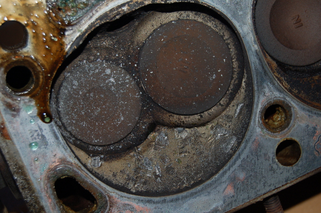

It does look pretty melty, but there is another possibility if you discover that the water wasn't blocked, though it is likely to be, my Florian alloy head was all blocked when I got it. Strange though that I was able to drive to the 2011 Nats & back with the temp needle just under the red bit without this happening.
Sometimes a top ring can break up, and the little bits move up & down in the groove, wearing it untill they break through & come up on top of the piston. Are those bits if ring sitting on top of the piston? And the dents in the head surface look like ring bit dents. This is what happened to my first motor in 1977. Same result though, there will probably be bore scoreing needing a re-bore. (Though back then I was still at school, so I was given a good used piston by Ted Freeman, a set of rings from Gary and bought a $10 head gasket. I smoothed the bore score with emery & put it back together. I did about 20,000 mile on that motor, then sold the car to a mate. It used a little oil, nothing serious. Tuff motors.)

OZ - I'm assuming you're right re oversize pistons, as apparently the original owner had engine apart no less than 5 times, swapping standard vs high-compression pistons etc, so one would have to assume it has been bored out before.
Greg - thanks for the heads up on the acid dip issue, and for the offer of a manifold gasket. I'd already gone out and bought a VRS kit prior to taking the head off... in the hope that it was just a valve issue or a busted head gasket.
Lewis - yes, while I'm new to taking an engine apart, I did look at those blocked galleys and think 'overheated' to myself... I've always run good coolant in her, but I've only had her 4 years.

Just a question: Did the car suddenly have pre ignition or pinging, or had it developed? Would from the increased heat from the blocked passages cause pre igniting of the petrol in that cylinder to then eat the piston and for the rest to happen? Sorry its not helping your cause just curious. Best of luck and hope to see the car happy and healthy at the nationals

Retroasted - about 20 mins earlier, the engine had a brief tappet noise that disappeared with lower revs... then same again when finally let go, although lost power that time and pulled off road. Unfortunately car will be a no show at Nats.
