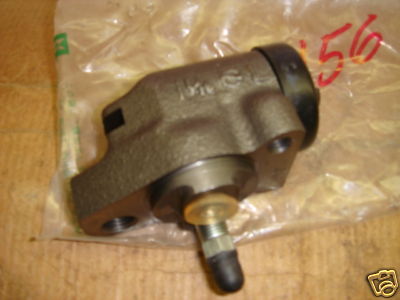

Check theese out on eBay they're used in 72-75 Chevy Luvs drum brake fronts.

I'm afraid the Luv brake are quite different - probably because of the difference in lugs etc?

I should have looked better, sorry! It's the same thing, the angle confused me... bought one, now all I have to do is wait for it to turn up. Thanks guys for the quick responses!

No no no, it's all wrong... comparing the pics I should have seen it. Has anyone got any ideas? I'll try to contact IZU069 again...

What is the difference? are you aware there is a left and a righthand cylinder.

The big difference is the sort of trapezoidal piece that the originals have, the upper part on my pics. The others don't have that extra bit. I have now sourced a set of the right cylinders though!
