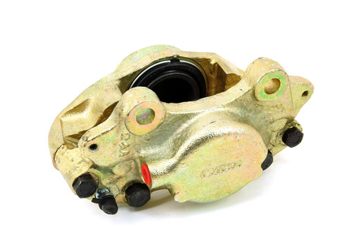

I don't have this part but it looks similar to the GT. What is GT caliper piston size ?
Uses a solid disk too.

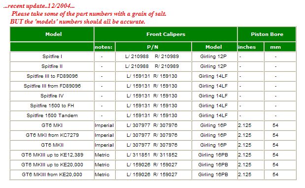

This one is 54mm piston size (~2 .125")and from Triumph GT6. There are a couple of verisons with metric or imperial fittings. Mount spacing might vary too. Don't know what it is.
While certainly not common here in Oz, seems they are easy to buy in the UK.
Would be interesting to compare to GT in the flesh so to speak.

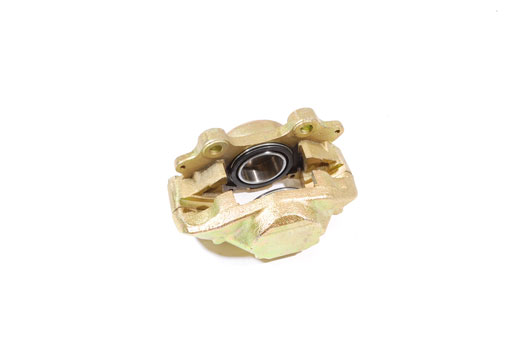

another shot
Mon Apr 16, 2012 1:13 am

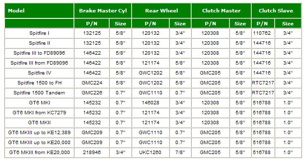

master cyl size etc of the GT6 is as below...
Triumph GT6 twin spot calipers 16P etc 54mm d pistons.jpg [ 63.81 KiB | Viewed 20794 times ]
