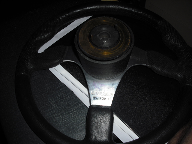

PICKED UP THIS WHEEL CAN GET THE SAME IN WOODGRAIN ...TROUBLE IS THE SPLINE THIS MODEL IS SW-PD011 WHAT OTHER LATER MODEL CARS WOULD HAVE A BELLET SPLINE .....???? WHATS THAT ...NONE... AH WELL $20 LOST WILL LOOK GOOD ON THE GARAGE WALL CHEERS DAVO

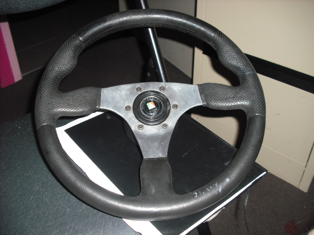

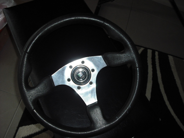

sorry the pics cheers davo

Looks like a standard six bolt boss bolted to the wheel.

JT the boss kit is rx7 until around 68 then it is gemini spline. rx7 series 1,2,3 are the same spline it's the depth that changes. Davo's car is mid sixties teardrop so it will be rx7 unless the shaft has been changed which i doubt as it had a early gt wheel in it.
JT the bellett of yours is later model with strip tail lights so gemini should fit.
Wed May 29, 2013 10:29 pm
its an Australian wheel its down under ......its upside down to show the coding of the wheel ....cheers davo ...and thanks greg for your imfo
