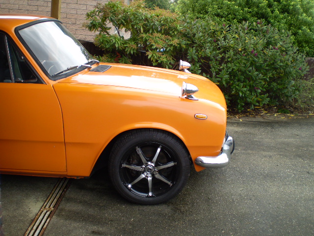

Tue Mar 17, 2015 6:54 am
Here is the photo you requested from front
