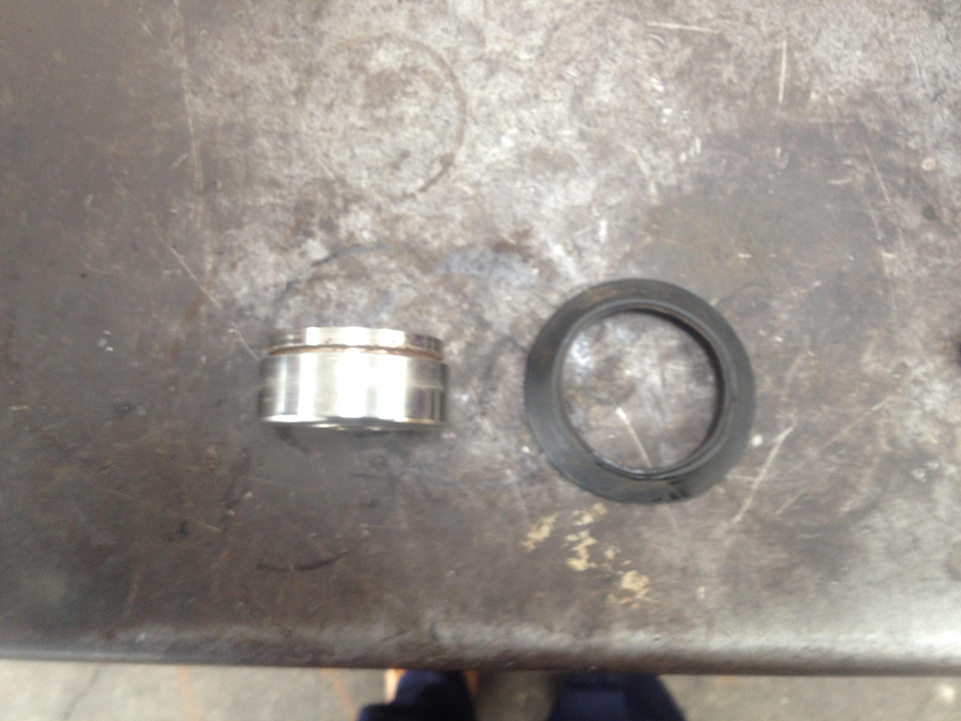

Has anyone got serviceable GT brake Pistons that they are willing to part with
Out of 9 I scrummaged so far only 1 is useable
So I need 3...
Also need a set of dust boots as per photo
Can anyone help
Thanks

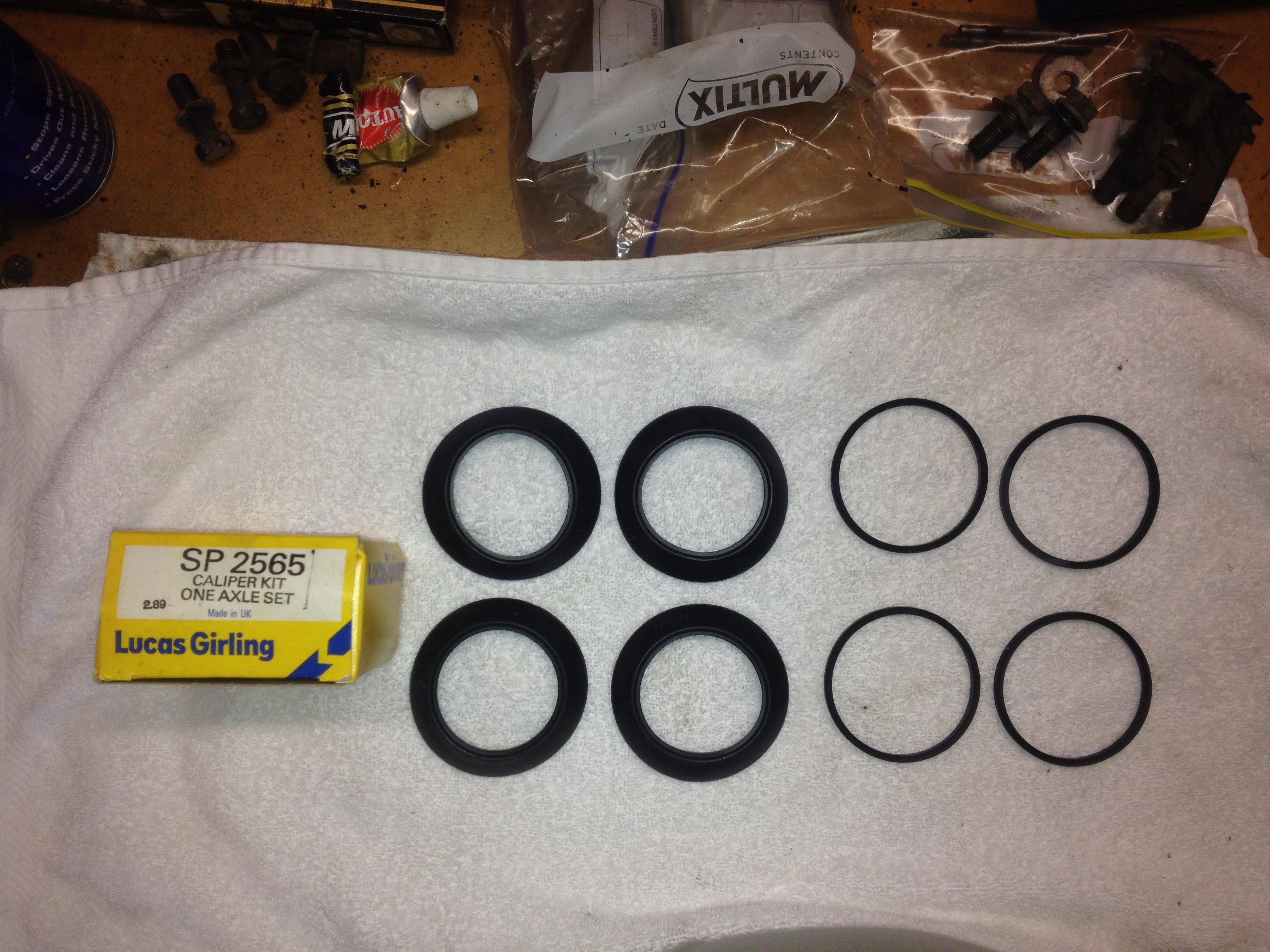

Well have some information
http://www.powertrackbrakes.co.uk/wcylinder.html
The front pistons are off the Jaguar 420G saloon built from 1966-1968... small run which makes then rare in itself
Calliper Rubber Kit : Girling SP2565
Brake Pads Bellett : DB704 (No longer available - save your backing plates and have them re-bonded)

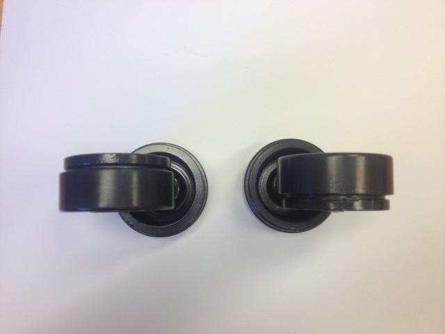

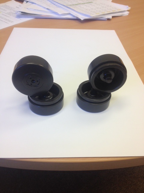

Tue Sep 29, 2015 10:10 pm
Just picked up the pistons from the Ceramic Coaters
3 are definitely useable, 4th touch and go as likely to 'seep' which may be OK on weekend driver but not daily driver so I will give it a go.......
Interim step to Sleeving if pitting minimal at about 1/3 cost........
