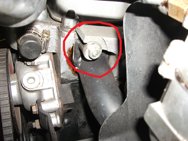

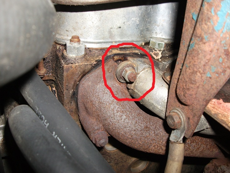

ok, here's the differnece in GT to sedan manifold mountings:
*the different mountings are across the entire manifold face, not just at cylinder number 1. i have only shown number 1 as it's the easiest to photograph and see easily for reference*
sedan: note location of top bolt/stud on number 1 cylinder, circled in red.
is at "1 o'clock".
GT: note location of top bolt/stud on number 1 cylinder again, circled in red.
is at "11 o'clock".
very basically, the sedan heads have the 'close spaced' bolts/studs along the top row and the 'wide spaced' ones along the bottom, while the GT is exactly the opposite.
and yes, that makes the sedan and GT manifold gaskets different to each other too, just to make things a bit harder for us all....

Hmmm ... that could make Bella's next evolution a bit tricky.
Thanks for the pictures and info Brett.
Sat Nov 13, 2010 4:41 am
Question oh Bellett sage's ... is there enough material in the head to re-drill the manifold bolts in the preferred format.
ie G150 head drilled for GT pattern ?
