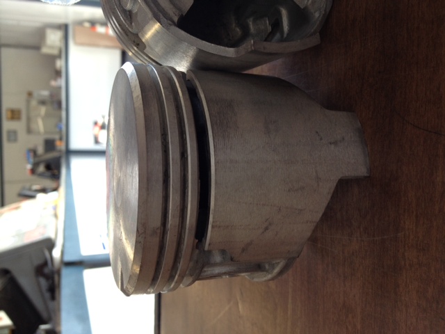

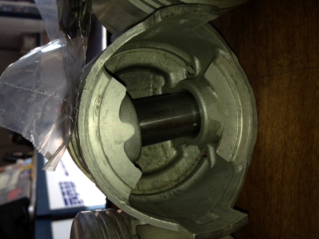

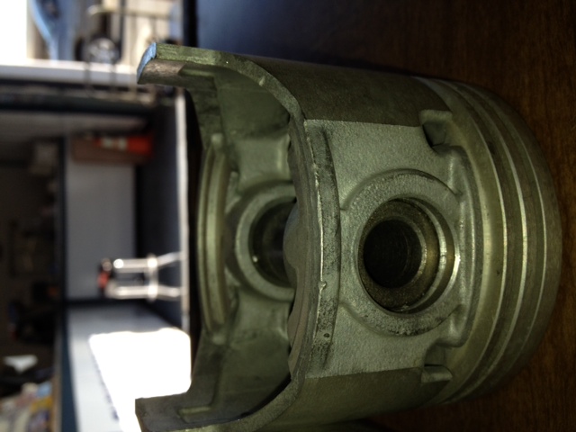

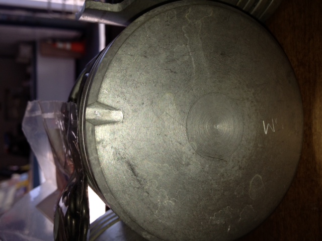

I found these pistons, can anybody comment on them please?
They are supposed to be for the SOHC 1800cc engine, Series 1 - 4 Chevvy LUV in USA.
They are domed on top. >> updated:- Must be my eyes, vendor says they are flat tops.
Not 'shiny' looking either like others on eBay.
Wed Apr 18, 2012 12:16 am
They are 84mm +20 thou'

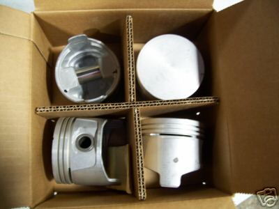

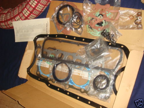

I took a plunge here.
Bought Luv series '72 - 75, flat top piston set. +30thou. OK, not 'right' pistons, but better than dished ones.
Rings and full gasket set. Hopefully right one see below, appreciate any feedback !
Just need a car to go with them !

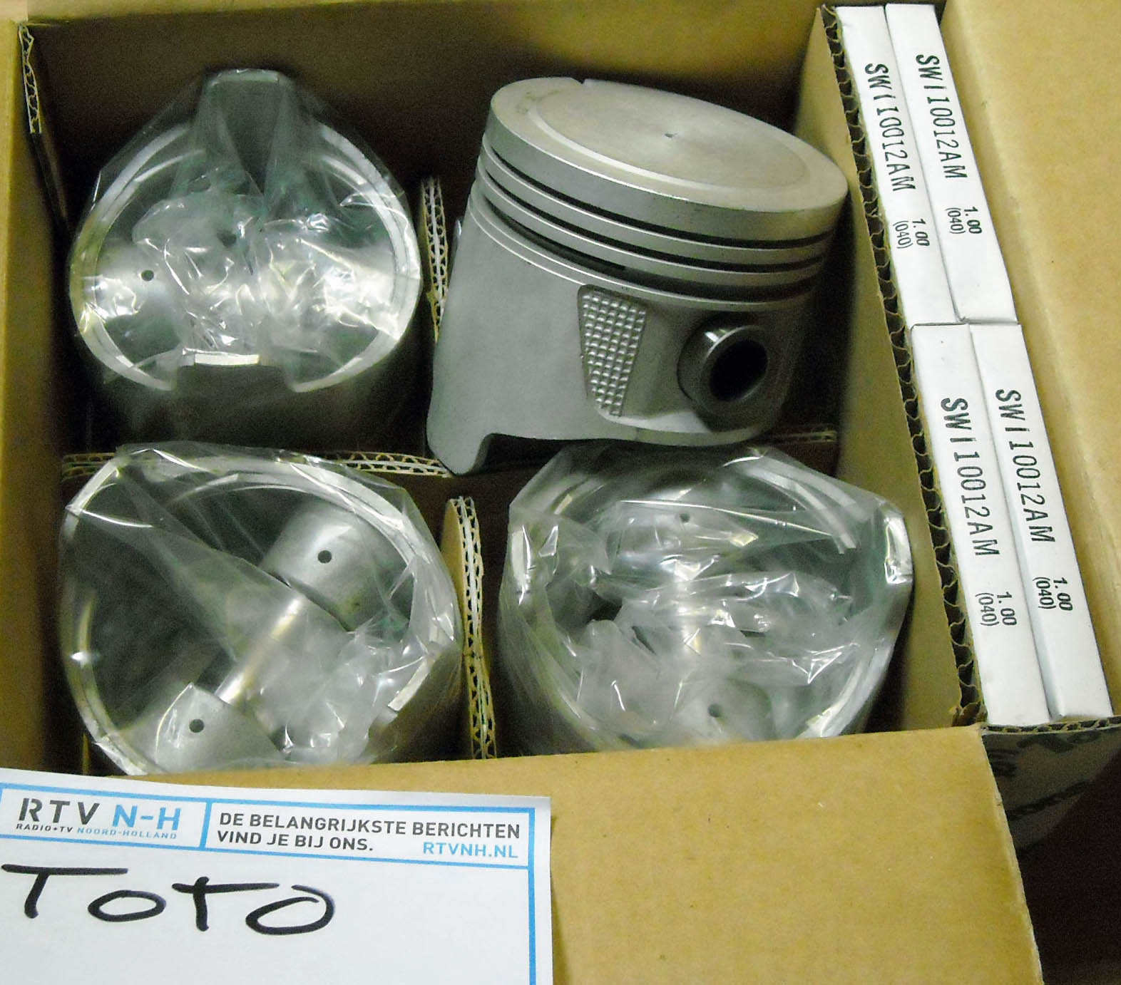

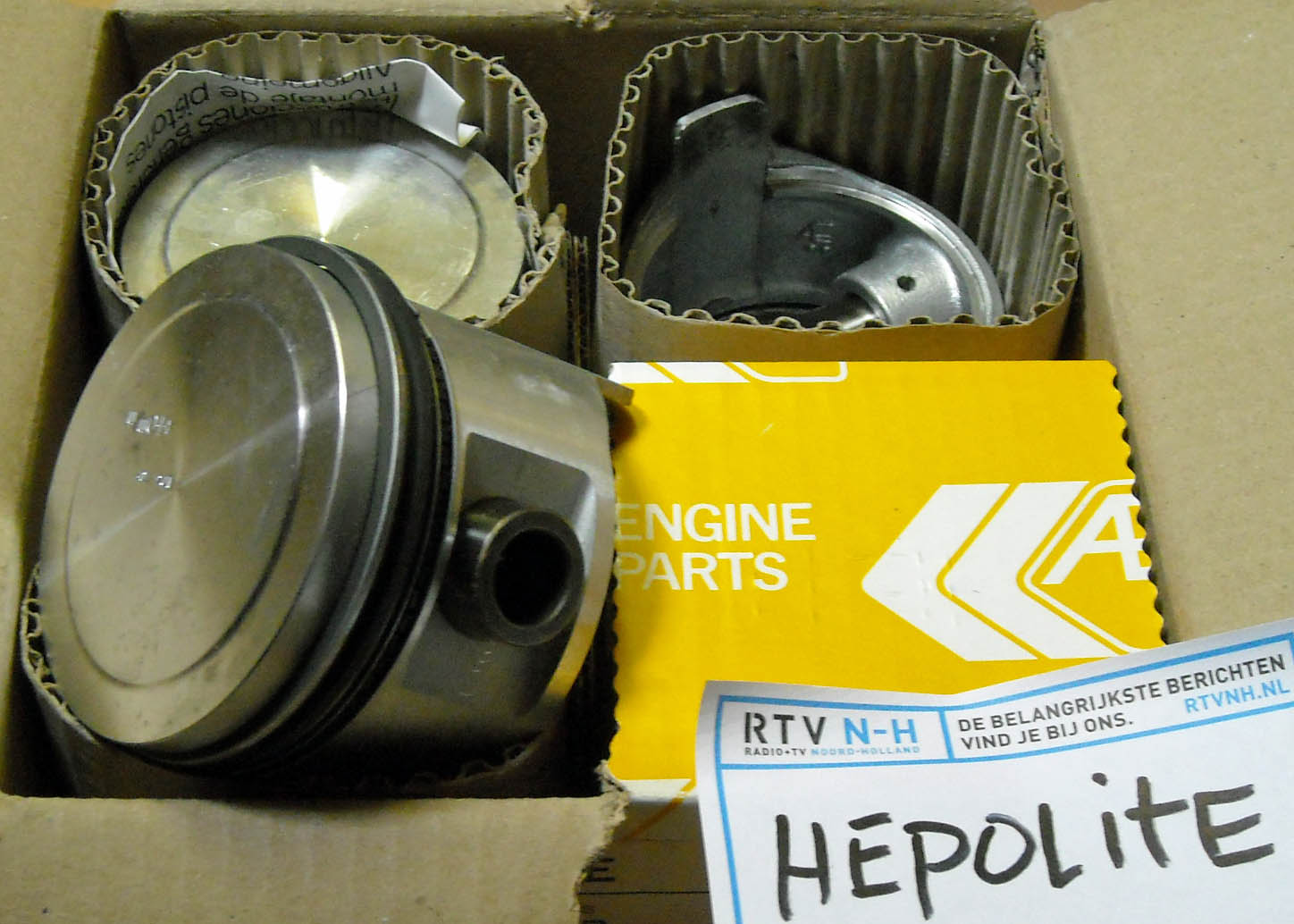

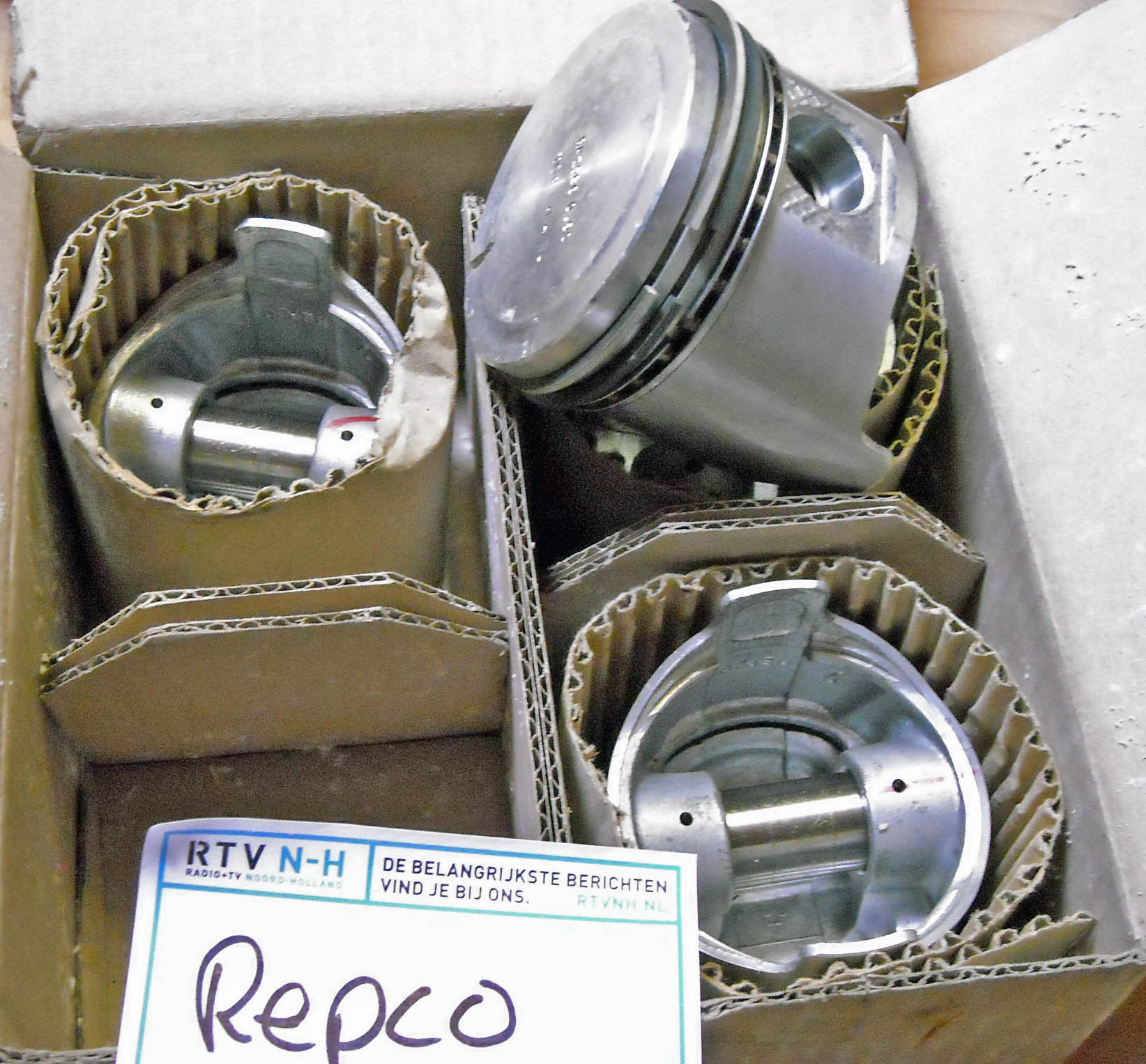

Hi Glen, as promised some pics of pistons that Dutch Dick sent me, when I was looking around for them myself.
Hepolite
Repco
Toto

Mark, are they 84mm pistons? I guess not if for Rollie.
Fri Apr 20, 2012 11:36 pm
Posts: 95
Hi Glenn,
The pic's Pombellett shows us are pistons for a 1600 (82 mm pistons) indeed, I also do have the 84 mm pistons. They look just the same with he little step on top of the piston too. This offcourse will give a better compr ratio.
The original sohc pistons had the cam on the piston not only for higher compression, but also for the flow in the chamber.
I'd say; now it is getting time to go out and buy an 1800 sohc car. With a bit of luck it has a good engine with no work at all !
groejes Dick
