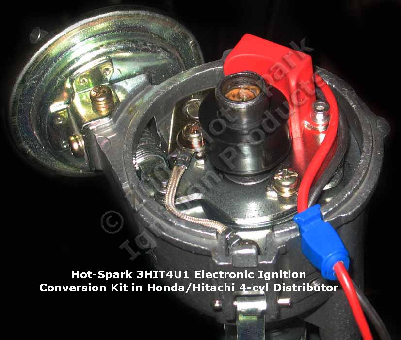

Now the 64 Bellett dollar question (they are worth a million afterall :D ).
Has anyone had any experience of these.
http://www.hot-spark.com/1-Hitachi-Distributors.htm
They seem to be a reasonable price (even coming from the US).

The Hot-Spark points conversion works great.
Just bolt in and away I went, the ignition was about the only thing that didn't miss a beat in 2000 odd km's.
I didn't get the distributor recurved or rebuilt thats for later. I just used the best pieces from all the distributors I had laying around.
Just make sure you have the correct coil to suit the conversion.
I got to together with a couple of others on the forum and we bought 3 sets to bring the postage costs down.
Highly recommended conversion.
