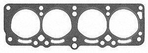

doesn't that out of round cause problems though on DOHC ?
This should be the SOHC gasket:- (need to verify)
A G200W set is on ebay (Oz) Item number: 261018545307
Wed Jun 06, 2012 12:17 am
they never put suffix codes on the engines themselves, but the OHV Bellett's had no suffix code.
all twin cams were a W code.
all SOHC engines that were in late Bellett's were an S code.
and Gemini style engines were Z code.
these are important to know as they are all different beasts to one another, and while some parts do interchange, 90% don't, so the suffix is vital to get the correct stuff.
