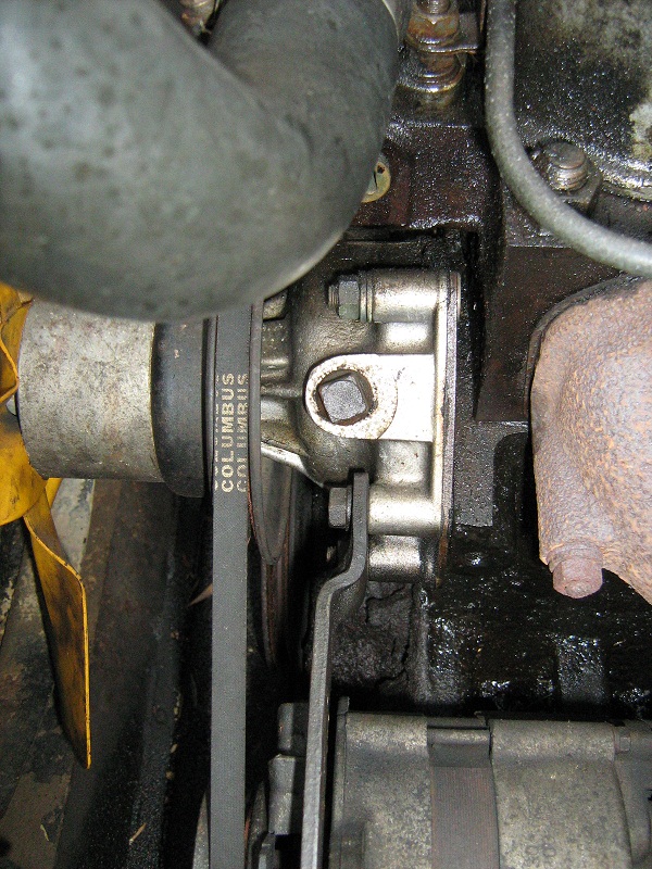

The Early Australian G161 Luv is the same as the later Bellett/Flo pump (pic of Luv Pump)
The Later Australian G161z Luv is the same as the Gemini.
The US delivered Luv came with a G180 OHC The later of which looked like the Gemini Engine
neither of which fits the Bellett/Flo engines.
You may find local parts suppliers may have the listing for the G161 Luv BUT BE CAREFULL
you will often get the Gemini Version!

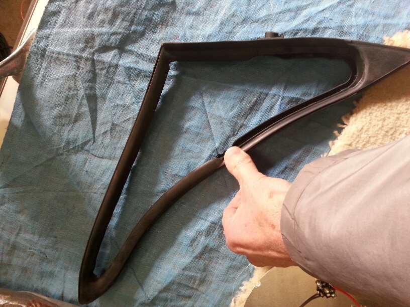

I have these rubbers for my Sport to be fitted.... called "weather strip" on the bag. Now i seem to recall the earlier cars had a flat bottom "U " shaped rubber piece ? Unsure how that fits in with the rubber around the actual window though, Dave.

Yeah Davo,
I have fitted a pair of these front quarter window rubbers to my PR90 last year. I had to modify them by cutting off the pointy front and shaping them into a smooth curve.. To fit them it is also best to completely remove the quarter window so the rubber can fit in one piece.
Did you receive my email? I will send it again through PM
Cheers, Lewis
