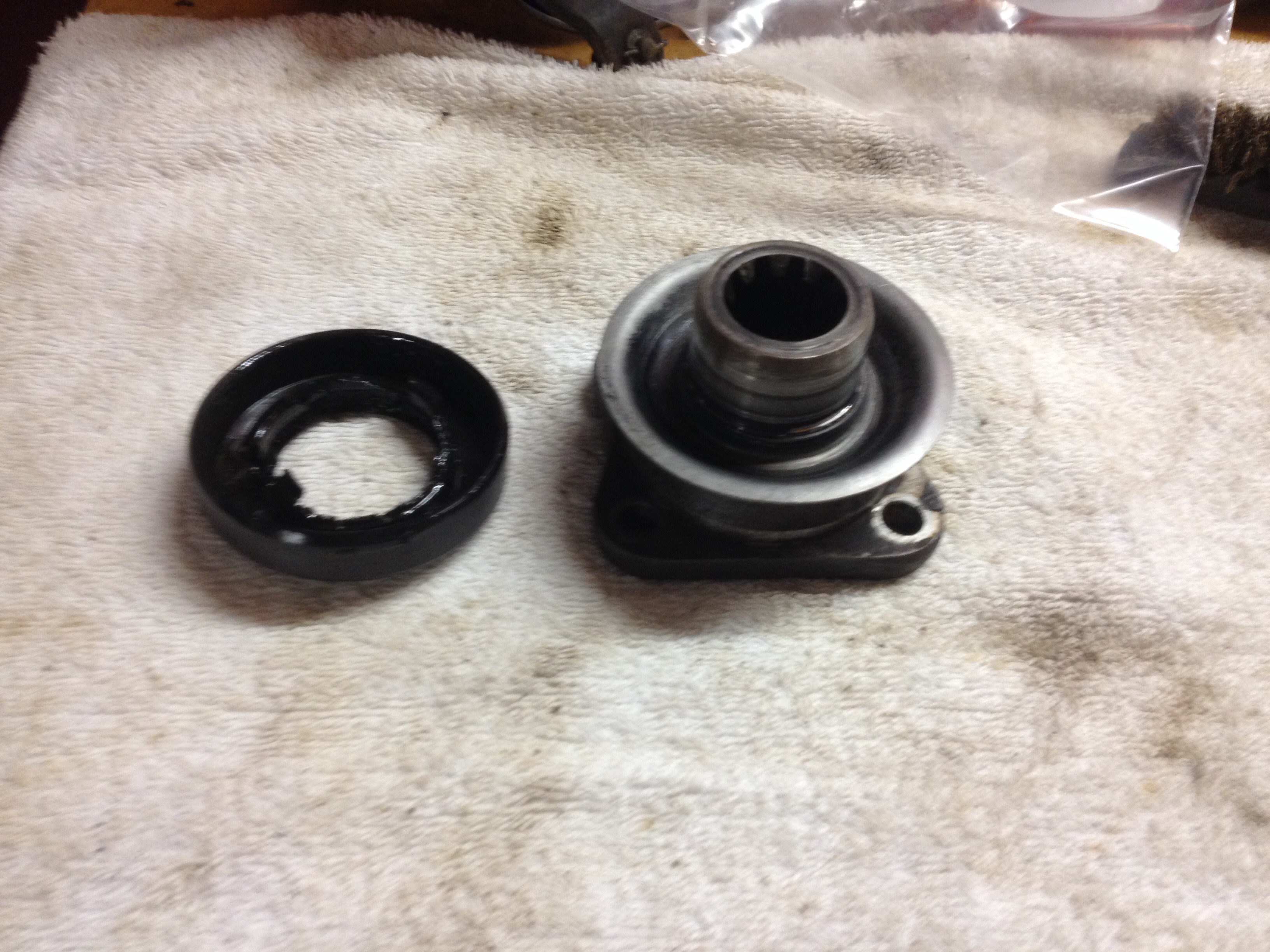

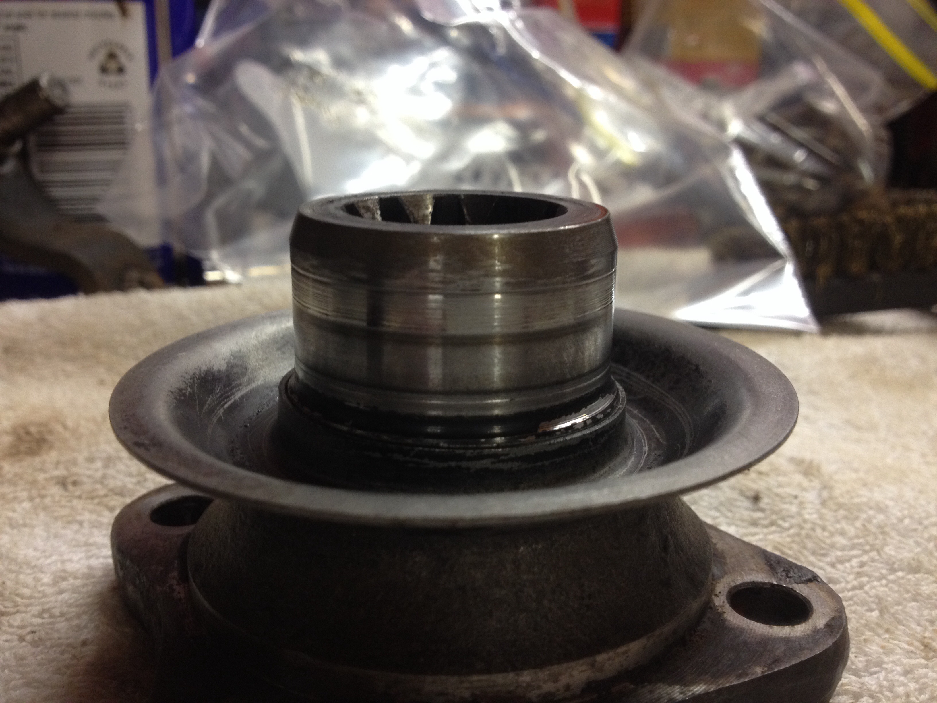

Eureka
It fought me all the way but bit by bit got the yoke off
50 year old Seal hard as hell and a real sh@# To get out lying on your back on concrete at 0' but hey, that's a heat wave in Tassie :lol: ..
The yoke will need sleeving as u predicted I am Afraid

Speedi Sleave
Best invention known to man
http://www.bsc.com.au/sites/default/fil ... 6Shaft.pdf
Thanks Dave
Legend

No probs. J. We see this at work quiet often.
We had a young fellow advised by his "backyard mechanic" that he would put a new seal
onto the rear main crankshaft of his diesel engine but will need an extra thick gasket to have
the seal run on a good surface. :shock: This particular seal is mounted in a large bracket and
doesn't have a gasket, only sealant. :o There were some swear words said that I've got in my black book.
I agree. Good invention. :)
