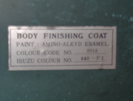

Would that be Glacial Blue?

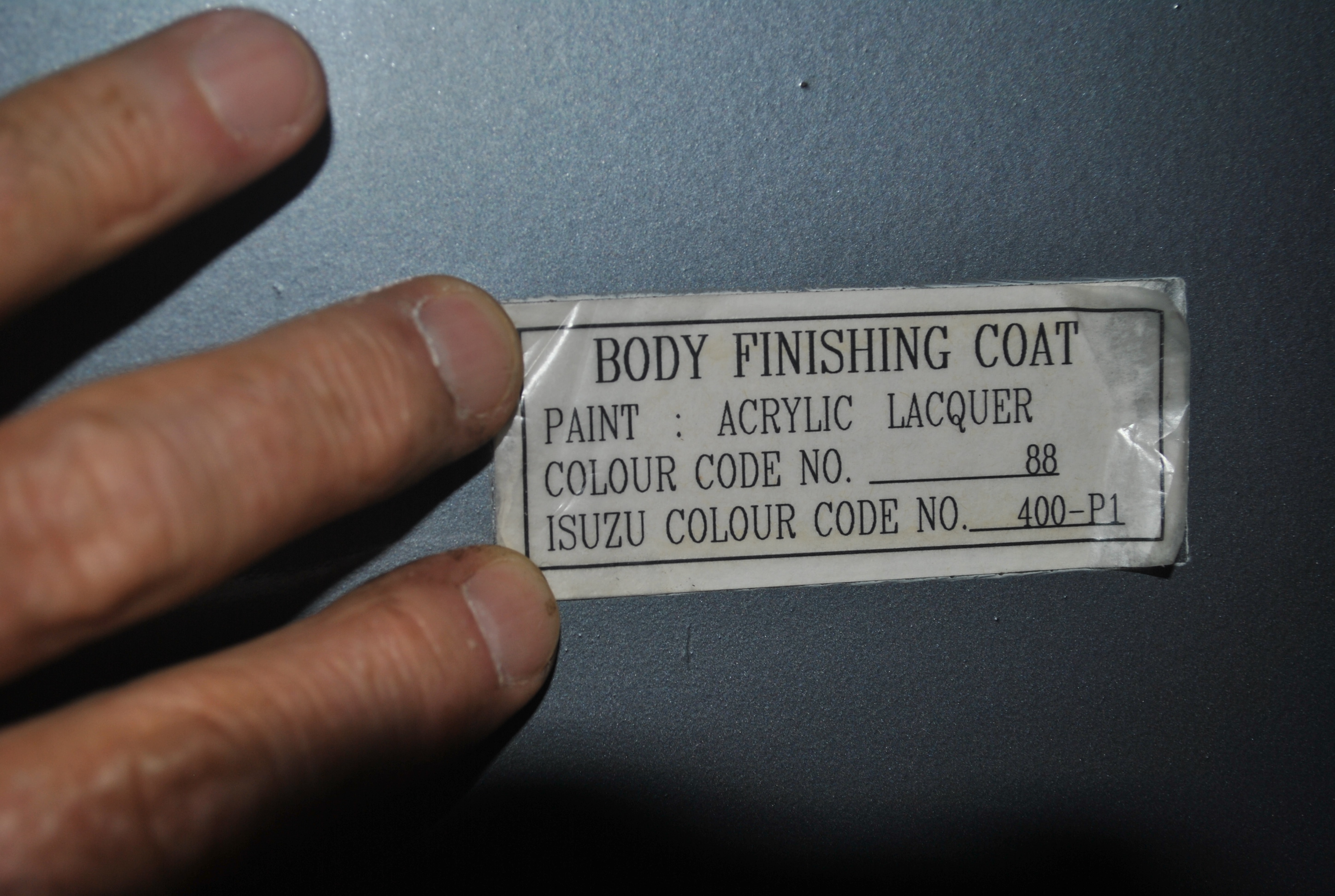

Hey Brett, does your listing have my paint tinting quantities? Code 88.
