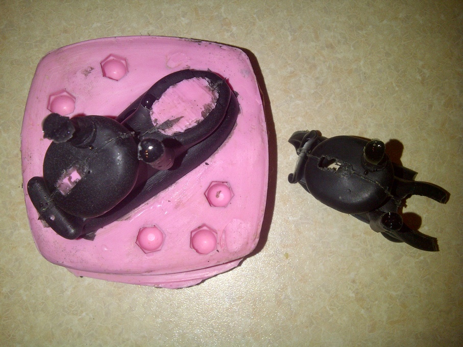

if you have been following my efforts with producing Molds and Rubber components for the Bellett's, you would know I have managed to produce Timing Chain Tensioner, Steering Rack isolators and Sway Bar rubbers.
to date I have not fitted a Chain Tensioner inside a running engine, so I do want to test that before selling them.
Steering rack and Sway Bar rubbers have been fitted and are working very well.
but I have been wanting to produce a more difficult, 3 or 4 piece mold and pour a successful rubber component.
as I won a brand new rear brake cylinder on eBay and it included the rear external handbrake seal, I decided to give that a go.
the mold process was not too difficult, but every pour I did was incomplete with the rubber missing at both ends.
but I continued trying different ways of preparing and pouring and tonight I opened my first successful component.
Wahoo!!!
that was particularly rewarding as it can be even more difficult to produce a good part in colder weather as temperature has a significant part to play in failure or success of the pour.
just one more part that I can now reproduce and not have to worry about running out.

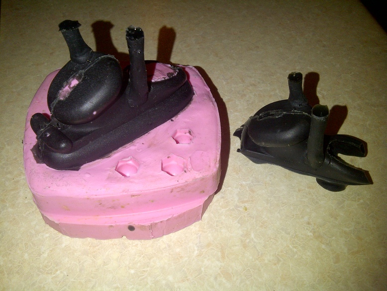

below are a few photos. the good pour is still on the base mold and one of the failed ones sitting beside it.
and one more

your right Orph, but they are not quite the same size or shape.
the brake cylinder is a smaller version.
