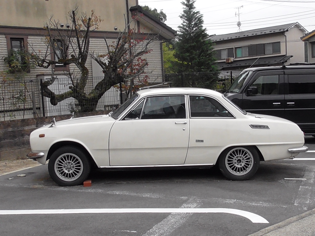

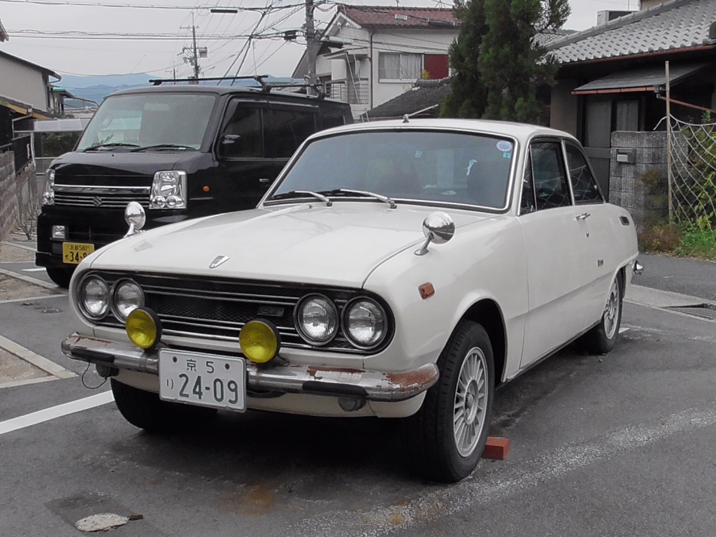

It turned out not to be....or at least not to be right now. But, I did take two pics of the car because almost every morning I take my dachshund out to pee about where I'm standing to take the picture. Maybe the guy will change his mind, but that will have to be another day.
I did find an abandoned Honda NSR 250 with a sign that it must be removed by December 20th or it will be trashed. I'll see if I can find out the parking lot owners and if I can just push the bike home for a father-son project. Most Japanese people simply don't do what I'm going to at least try to do and I guess that is a good thing for someone willing to put in some sweat equity. A colleague of mine, a Canadian, found a guitar left on the side of a trash pile near his house and took it home, cleaned it, and put the parts in correctly. its not great but it is a free and fun to play with. Cost him a pittance in parts and new strings.
