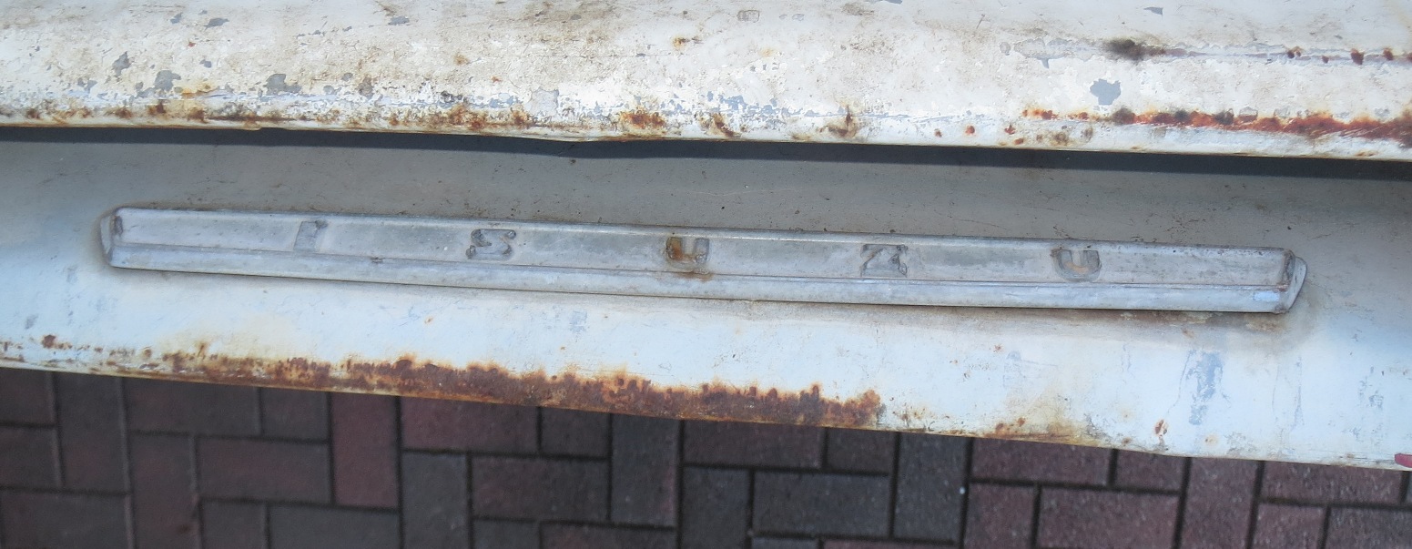

1 thing I thought of was the Early Series Bonnet badge, was thinking first in metal but then
thought maybe chrome plastic as I reckon they will get knocked off pretty frequently.
what does everybody think???

I'd go aluminium Josh, it'd be cheaper. If I could get a sample to take dimensions off (and return) it would literally take me a couple hours to finish, then send off for quote. I need to line up Oz for a fact finding mission one afternoon. 8-)

Didn't think of Ali, I'm guessing the original is
Ali, is the one in the picture too rough?
If not we can use that one.

I reckon the one above will be fine, will drop into Oz's soon.

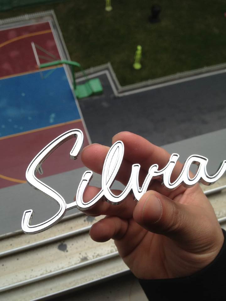

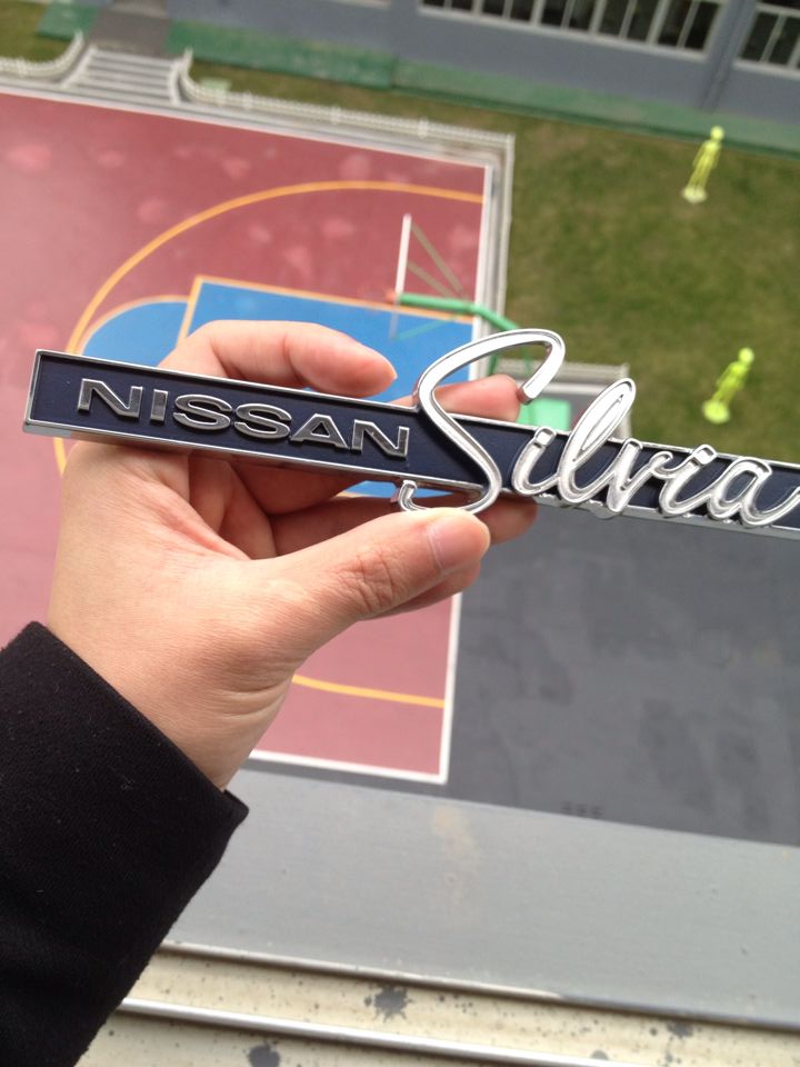

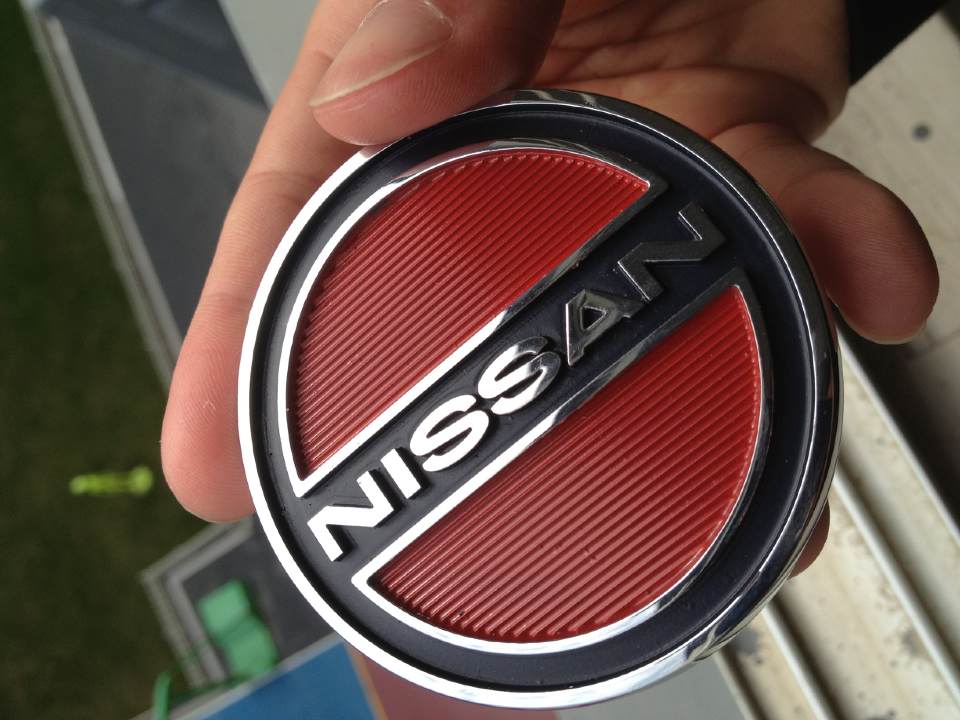

Digging up this old thread, just out of interest, here's the Silvia badge set I had made...stainless steel (no rust or pitting, strong and close to original weight), sandblasted (for casting effect in centre), polished, chrome-plated, then painted blue and red, an order of 10 sets came in approx. cost @ AU$500 per set.
I have the pitted originals for my car, they can sit in a box somewhere while the repro's take pride of place...I wouldn't be able to restore them for AU$500 anyways. Nothing's a bargain these days, but at least it also proves nothing is 'made from unobtainium' any more, for those who don't have original parts for their car.
Anyways, not spruiking any extra work, but happy to lend a hand if someone wants help getting parts made. I reckon by comparison, a Bellett GT badge set would be less as sandblasting is not required, nor multiple colours.

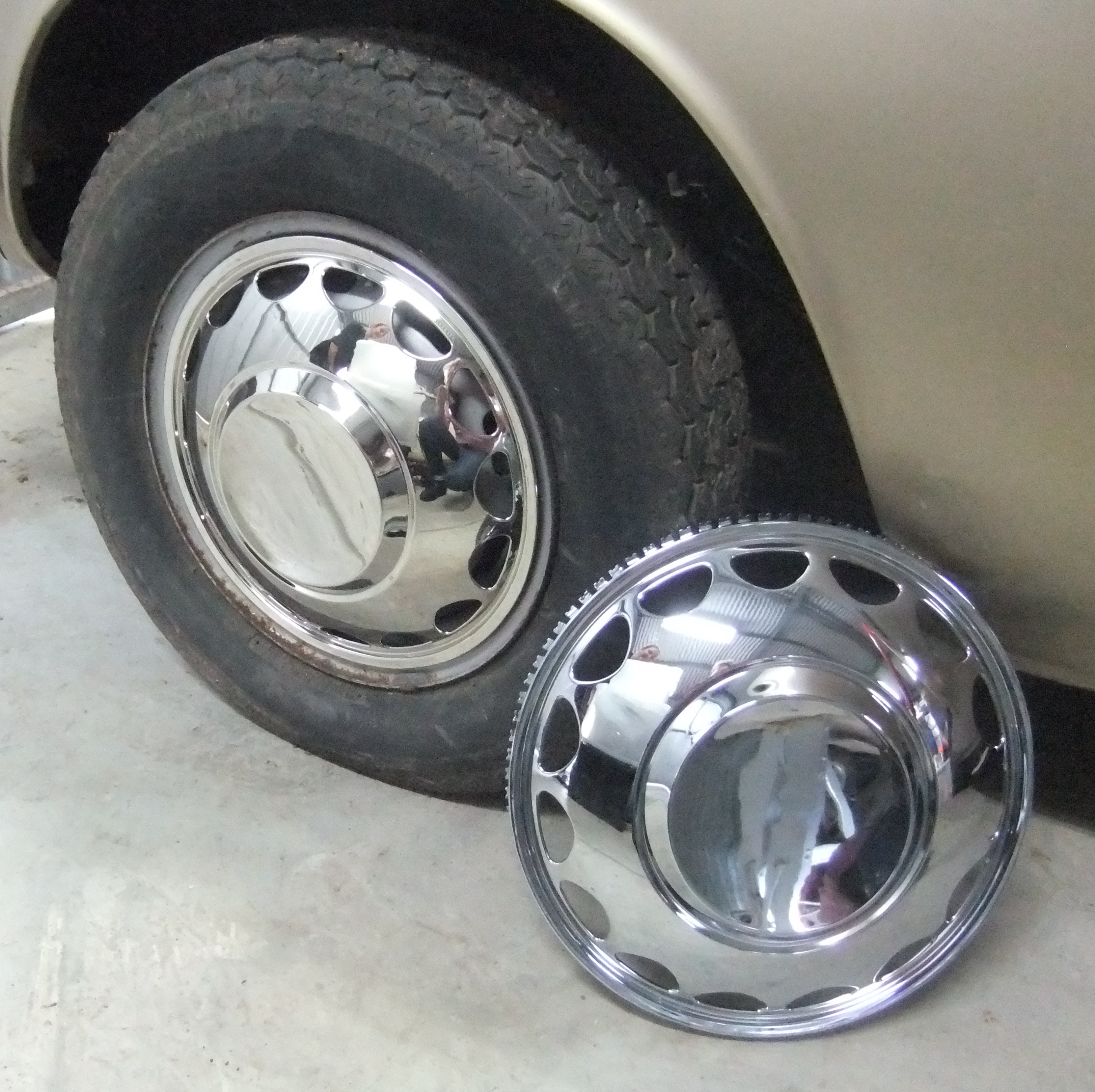

Hubcaps too, although tooling for these was expensive, which drove the part price up to US$1,000 per set. Was hard to generate interest at that price to some extent, the old chicken v egg situation of increased interest = more customers = lower cost = blah, blah, blah.

Wow that's awesome! Great work!

excellent stuff you did well mate you chased it all the way
