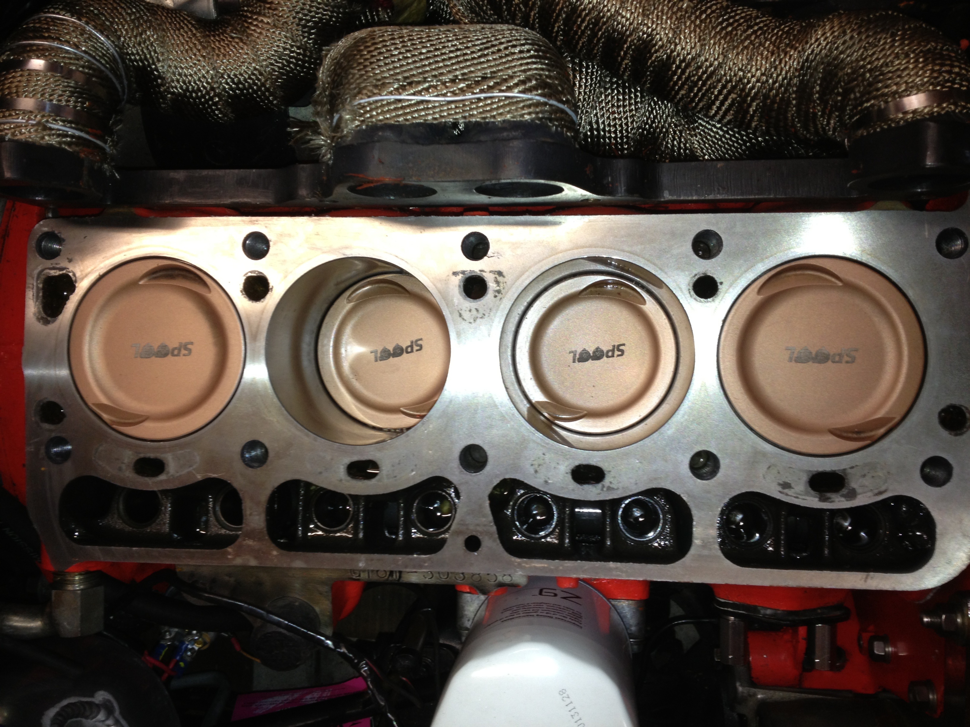

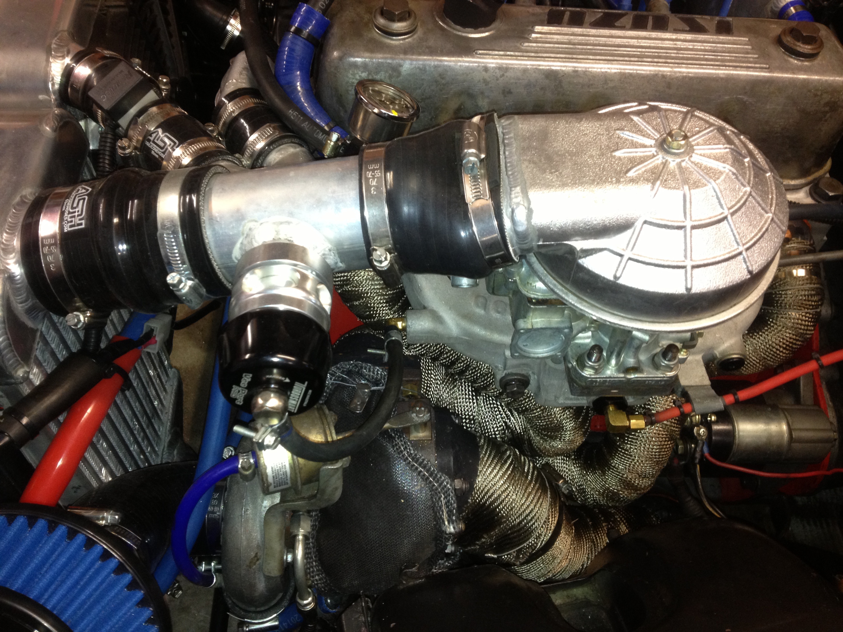

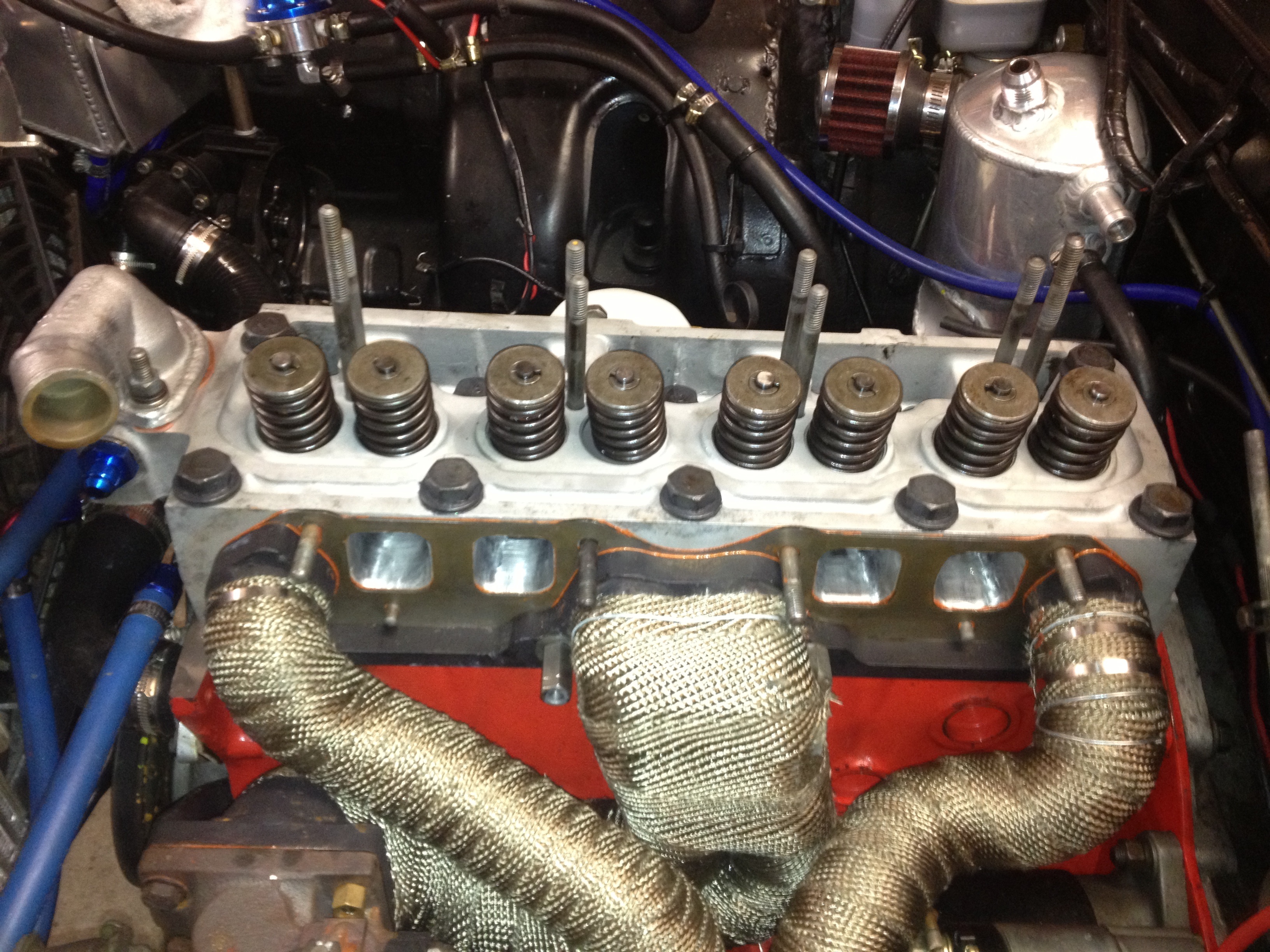

Thanks for such kind words of encouragement Oz and Josh
I really wanted to get Asroc to the Nationals but just couldn't get in enough testing beforehand.
It was just as well as we had a good blast on the back roads thanks to Yellowperil on Saturday afternoon
:D
It was soooo great at the Nationals
What a great 'Family' Bellett people are!
I have some great friends
I'm happy to post some pickies so here are a couple
James

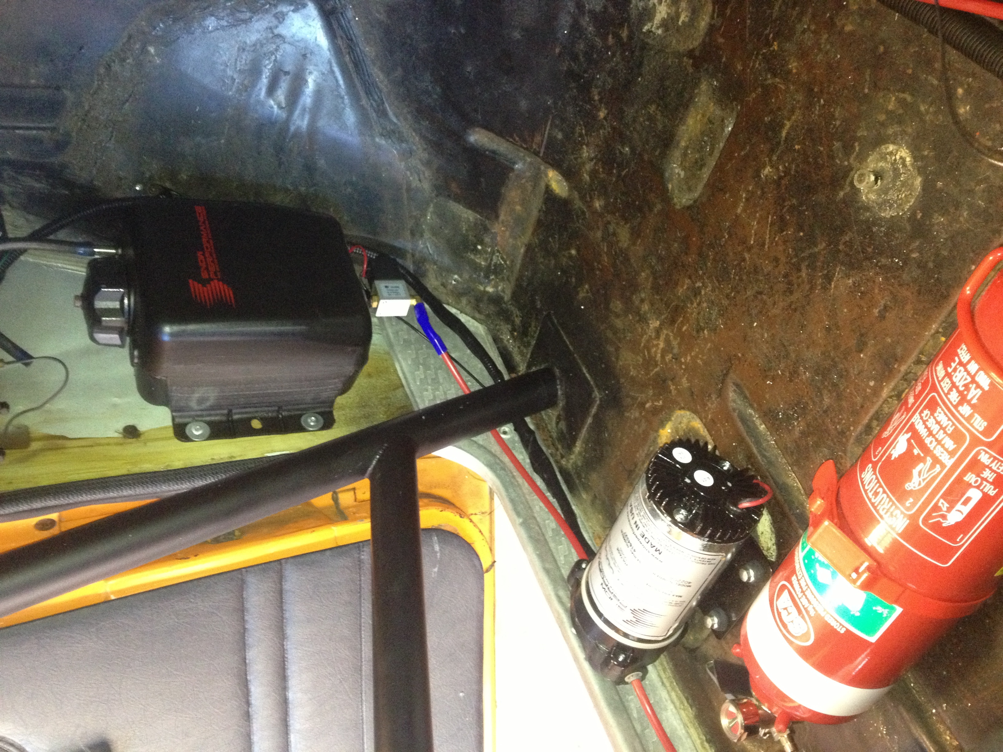

and the setup for fuel and battery in the boot is 2nd to none as well.
many many many hours of painstaking work in that car.
a real reflection of the dedication of the owner. very nicely done, James.

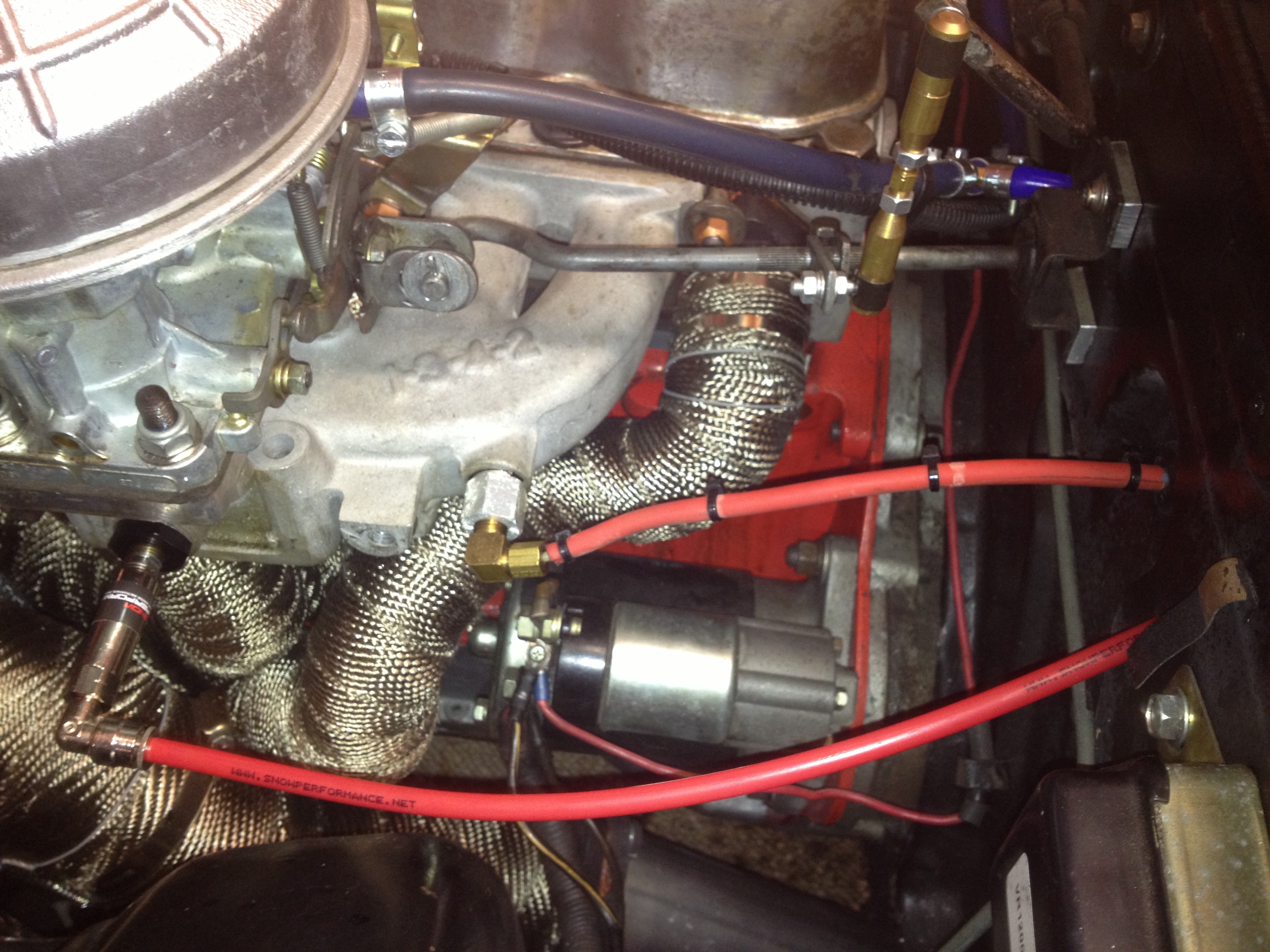

Hi All
Thought you may be interested
Final 'tweak' (for now anyway)
I bit the bullet (with all the excellent builds posted past and present) plus as a very good insurance measure against detonation
And fitted Water/methanol injector system.
I mounted the injector right under the carby in the inlet manifold for best effect
Pulls like a Malley Bull
