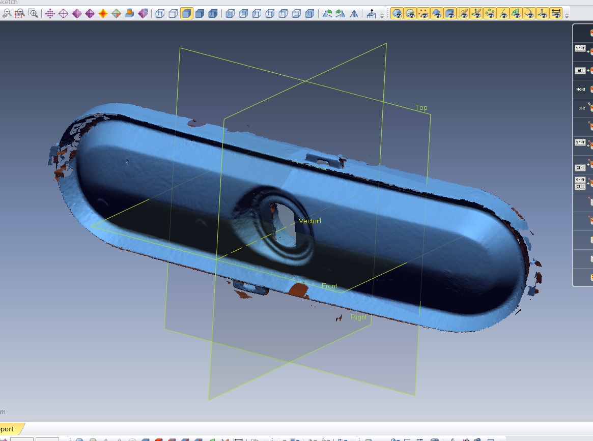

Certainly can do Matt. I've attached a scan of a Silvia replacement lens I'm working on right now - when finished the CAD from this scan will make the lens. These days they have excellent cast acrylics that mimic the properties of injection moulded plastics very well, so if you do your homework you can select the right material to make a part just as good as, or better, than the original. I'm currently testing several materials in the UV tester at work to see how they hold up under extreme UV testing.
I'll let you know what cost the Silvia lights come in at. GT strip lenses would be no problems at all and prices should be comparable with the Silvia.

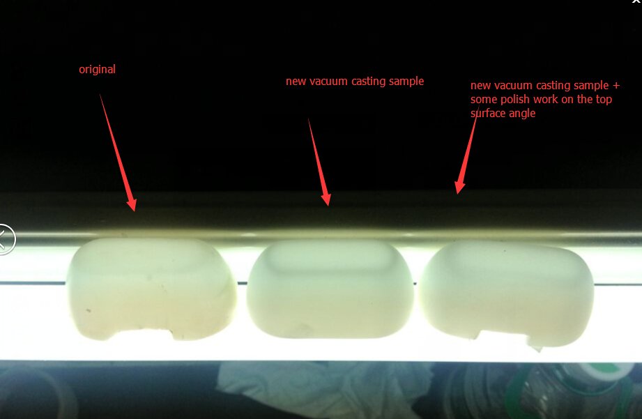

The guys up in China sent me some pics tonight, so I've attached the Mazda R360 lenses; original (L), off-tool cast part (M) and final part with light sandblast to replicate the light dissipating rough surface (R). L & R would be pretty hard to tell apart had the plastic not aged on the original and gone a bit yellow. I reckon the little 'snail' front indicators that were on my GT would be perfect for this method - might cost maybe US$20ea, but would look all glossy and amber just like the real thing, with excellent UV stability and impact strength, not fragile like resin.
So, yeah, lets make some stuff and get quotes! :mrgreen:

mate you are a genius ...this is great for all the guys in need of any type of lenses well done the marque stays alive ....cheers davo
Wed Sep 02, 2015 9:32 pm
That's what I thought too Davo (well, not the genius bit)...as long as the CAD data exists the parts can be replicated at any stage. I produce drawings here with all the material specs and dimensions to ensure they'll stay correct through successive batches.
