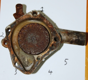

This is a closer up of the original Bellett pump.
One thing to note is that between holes 2 and 3 in the picture there is another hole.
On my engine there is no bolt in that hole. I mention this because on the LUV pump (next picture) there is no hole there.

Sun Aug 19, 2012 11:52 pm
