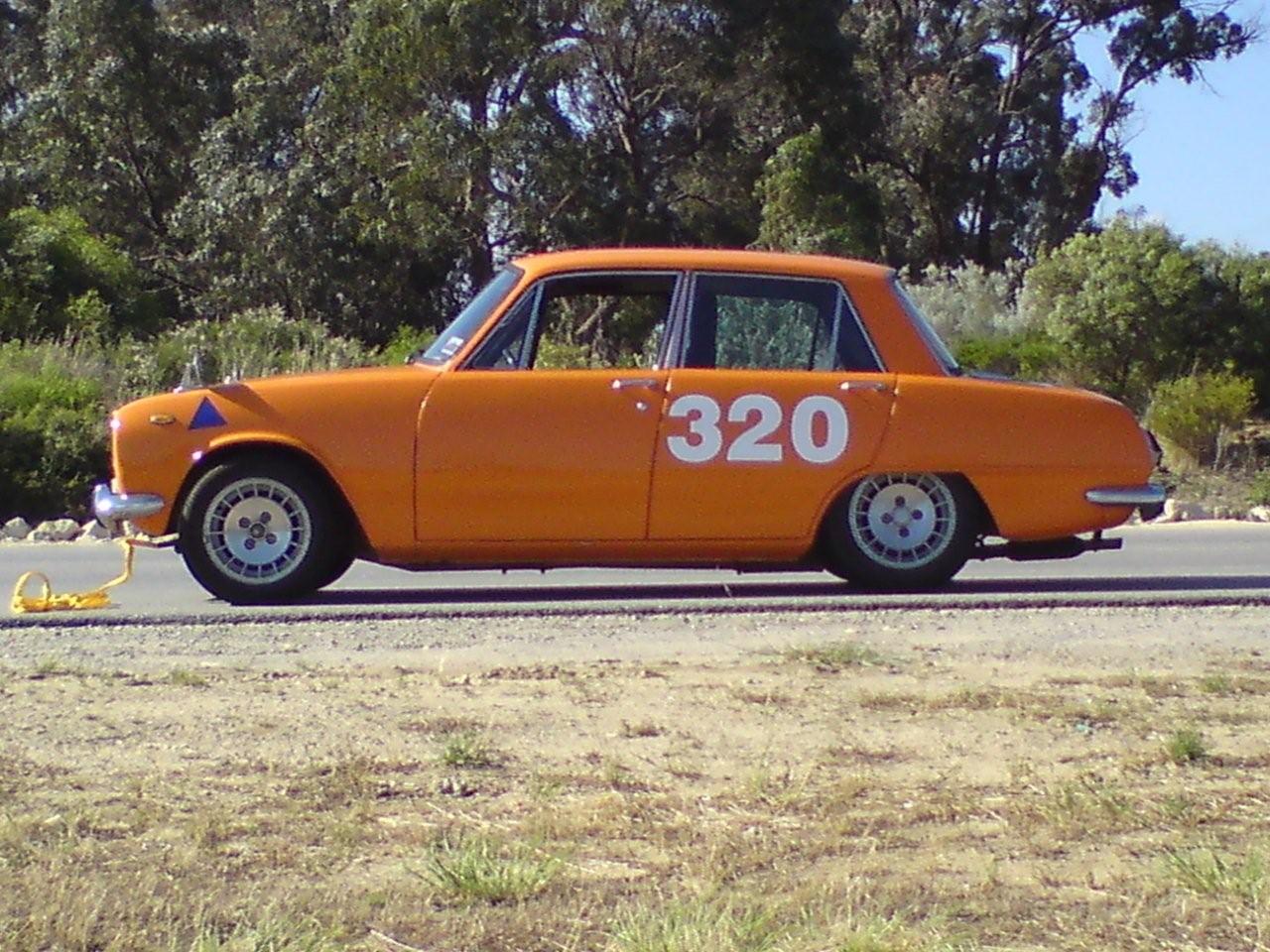

Hi and welcome James,
I wish I knew the "Tangarine machine" was up for sale at the time but I did however purchase Bill Buys blue 69 sedan. Nice guy and was a pleasure to have met. I don't know if you have this pic of your car or not (also posted under "Dear Donkey" thread) as it was prior to your purchasing it. I love it and glad it went to someone who obviously does too
What a cracker of a car

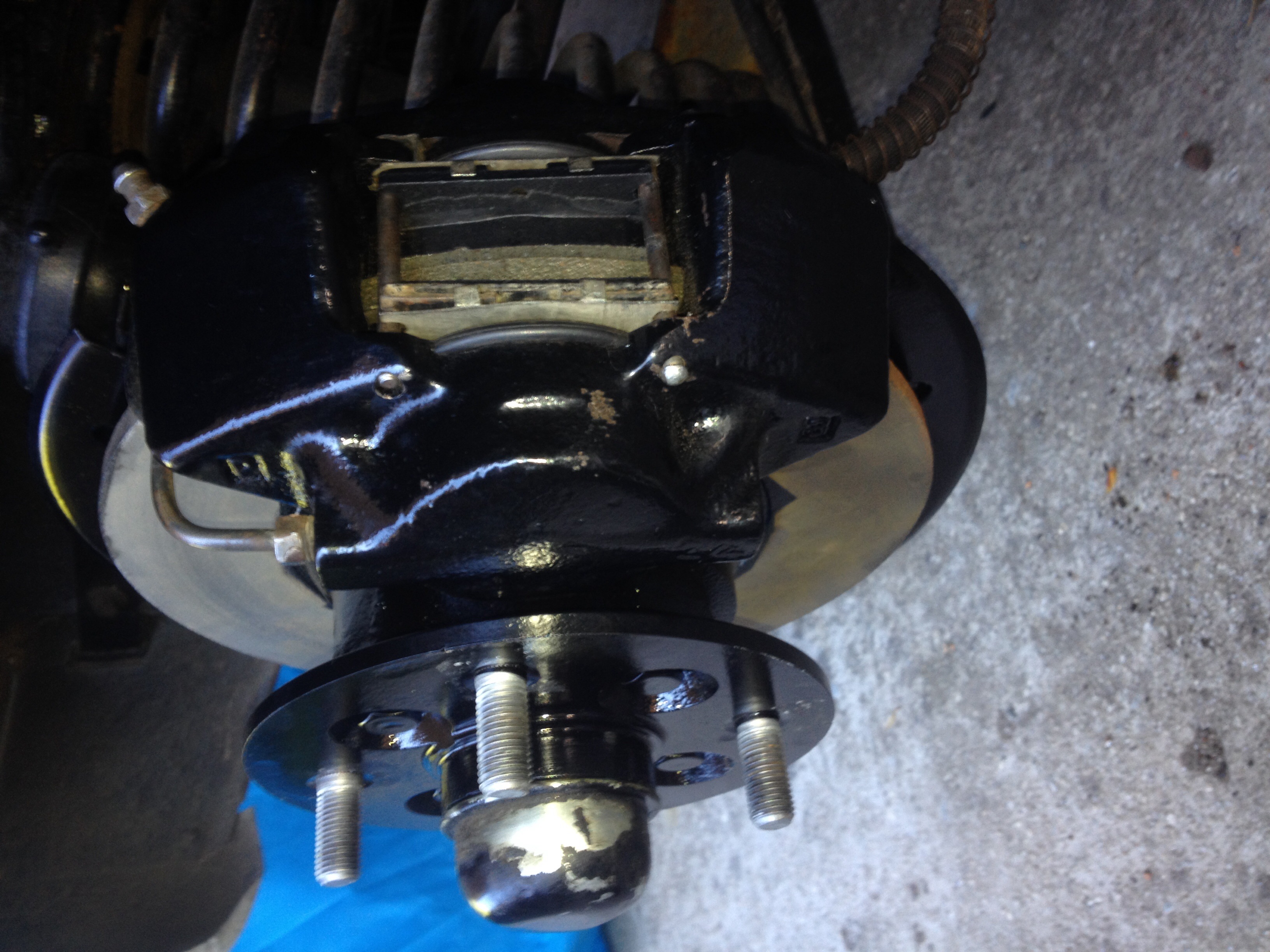

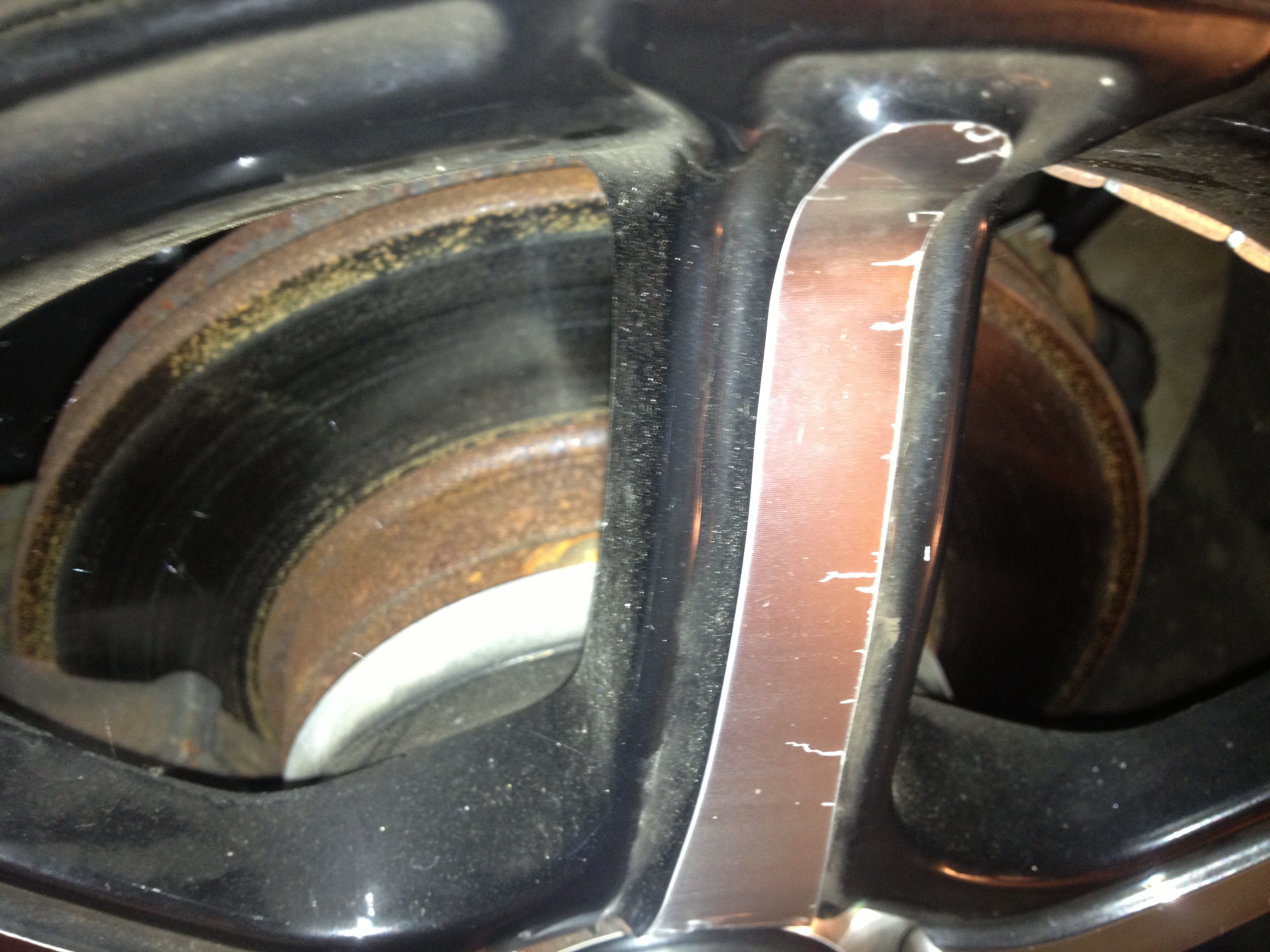

Discerning eye
Let me say I am handy but not Skilled in fitting and turning requiring welding
I fitted a Davies craig electric water pump on the front driver's inner guard under the overflow tank
Re brakes well Custom and Cash - built by local race car fabricator
All he told me was '92 Mondeo vented rotors, cross drilled volvo callipers so only 1 brake line and not 2
Custom fit to bellett hub requiring 1/2 inch spacers and minimum 15 inch mags.
Datsun 120y master cylinder requiring knibble of suspension tower
Photos attached
Sorry cant help more
Cash and lots if it!

Interesting choice of rotors. It appears they are 1995 and up Mondeo by my disc rotor listing? 24mm thick,
The TP Magna discs are very similar and slip over the Bellett hub if the centre is turned out slightly.
OK on the master also. Thanks for the feedback.
