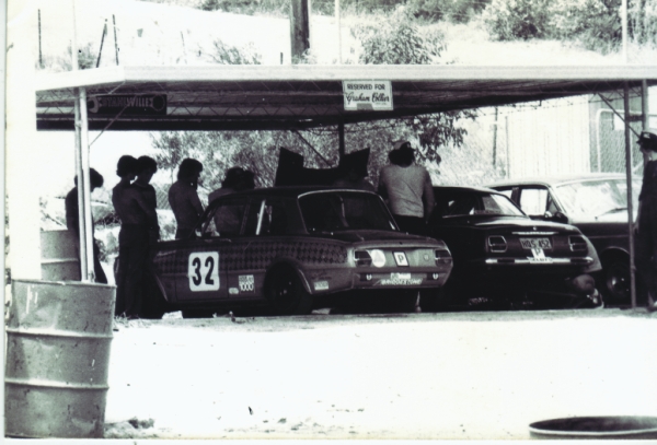

Although the Squirrel was built to race, I only ever competed in one Open Race Meet at Amaroo Park if I remember correctly, this photo shows the Squirrel and George Steeden's GT in between races.
The reserved sign says for Graham Collier, I guess we were subbing for him that day.
Ted.

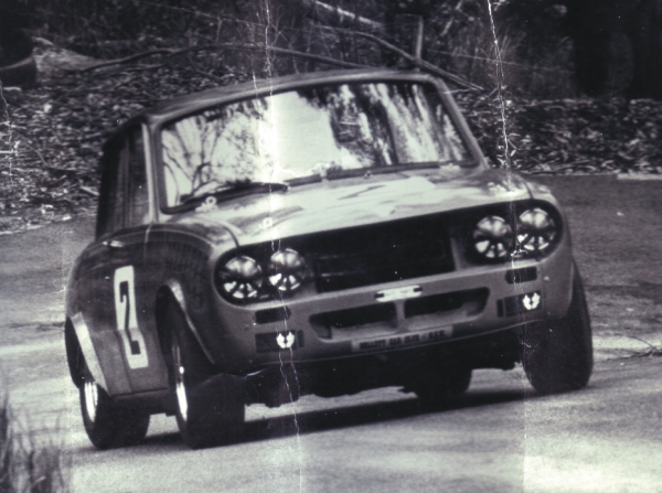

Here's the Screamin' Squirrel with yours truly at the wheel ascending Amaroo Hill Climb.

Great photo, just how we all remeber of your great ability to get the most from a Bellett.

I wreckon it's Silverdale!

Very possible "Poppy", I was going by the colour of the road!

Looks like Siverdale to me, may be just getting old
