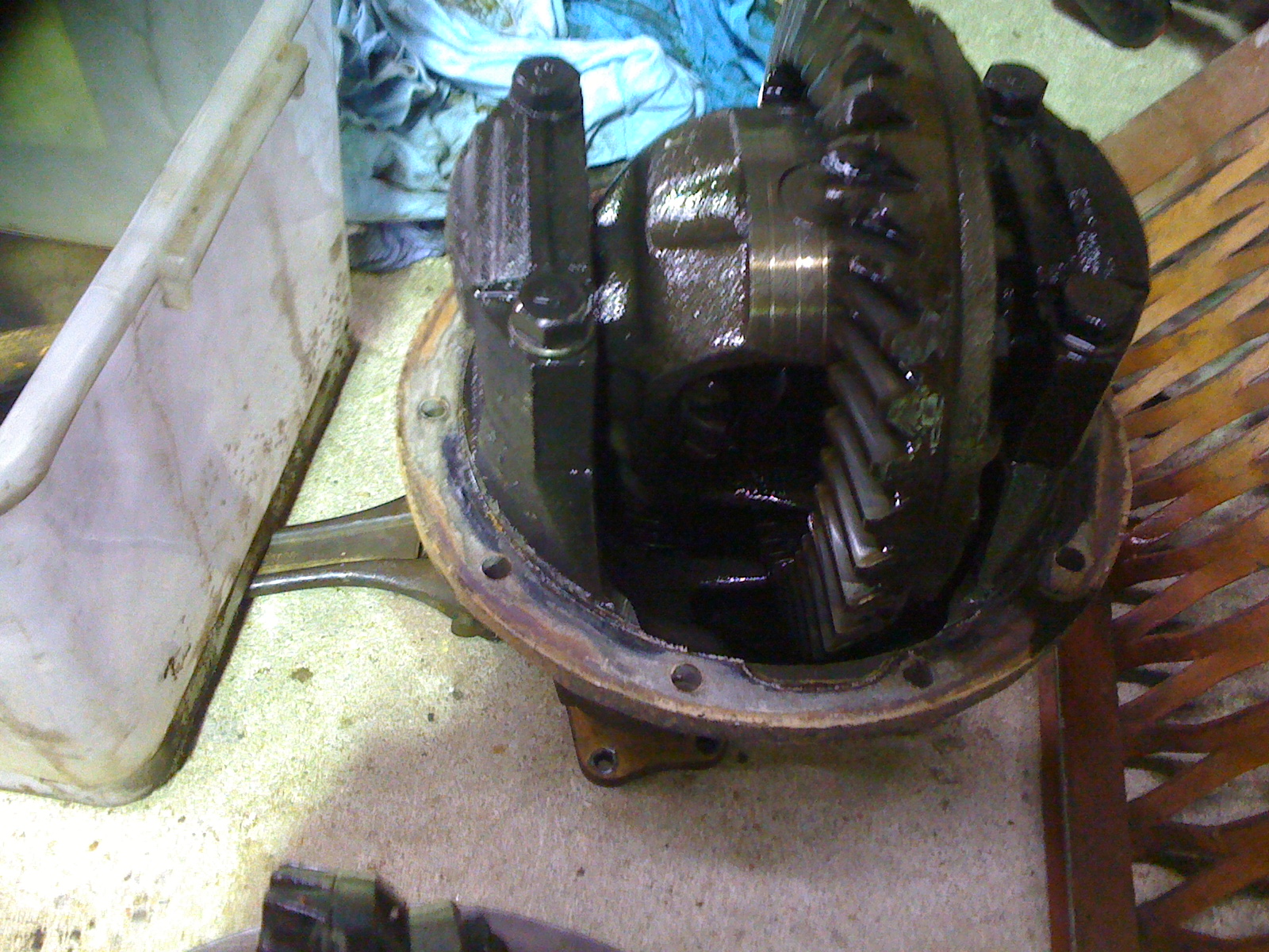

Posts: 139
Car(s): 1980KBD40 ISUZU
I have a few KB Isuzu/Chev Luv 9/41 4:56 and 8/41 5:125 centre's laying around.

do they fit in a bellett diff housing? do you know?
Fri Sep 21, 2012 5:29 am
Posts: 139
Im unsure if they will fit Bellet or Florian, they are commonly known as a 10 bolt amongst Isuzuists.

cheers for the pic yeah im pretty sure the bellett diffs are 8 bolt not 10 :(

Posts: 139
I have 4.56 diffs from the front 4x4 Chev Luv/KB Isuzu which are 8 bolt. :idea:

hmm do you have a pic of those gears by any chance? mainly of the crown and pinion gear really by themselves or are they still in a housing.
Sat Sep 22, 2012 1:47 am
Posts: 139
Best i can do currently.

hmm interesting...i wonder what the pinion gear looks like thats the main thing...where abouts are you?
Sat Sep 22, 2012 7:25 am
Posts: 139
Riverland S.A 2hrs from Adelaide 1.5 from Mildura Vic. Would a front diff work in the rear? :? Will you have four reverse gears and one forward etc. :lol:
