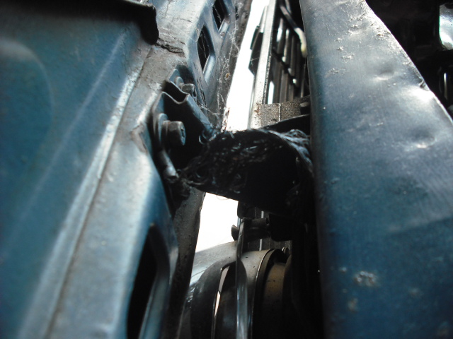

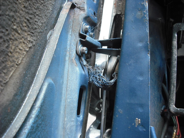

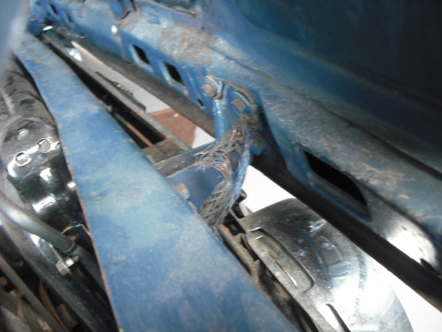

HI GUYS BACK ON THE CAR AGAIN ...I AM CHASING SOME EARTH STRAPS THE 2 THAT ARE ON THE BONNETT TO THE BODY MINE HAVE THE MESH WORN THROUGH ...ANYONE HAVE SPARES OR SOME FOR SALE ??? CHEERS DAVO CAR IS PATIENTLY WAITING FOR ME ....

I think they are only on the teardrops. Again, no real reason for them though i think. You could make them up if all else fails. Auto elec could probably do it for you.
Mon Oct 28, 2013 4:58 am
Think they had something to do with trying to prevent static in the car radio reception.
I would have thought that they would have been " after market " fitments . My Teardrop does not have them.
Mon Oct 28, 2013 6:23 am
Got to admit never seen them myself, reckon KB might be right :geek:
Great little Bus there Davo, looking forward to seeing it!!
Mon Oct 28, 2013 6:29 am
Looking at the way that the mesh strap is attached I would say that it's a home job by a previous owner.
Doesn't look remotely like the sort of fitment method any manufacturer would do. A bit shoddy and as the rest say "never seen it on any other Bellett before"
I've only ever seen that sort of thing on a mates old FJ Holden and it was fitted by his uncle when they installed their Ferris picnic radio, possibly to eliminate static as Kerry mentioned.
Mon Oct 28, 2013 6:38 am
What advantage would it have as bonnet already earthed through hinges? The older cars had a earth strap from motor to body mainly to earth starter motor.

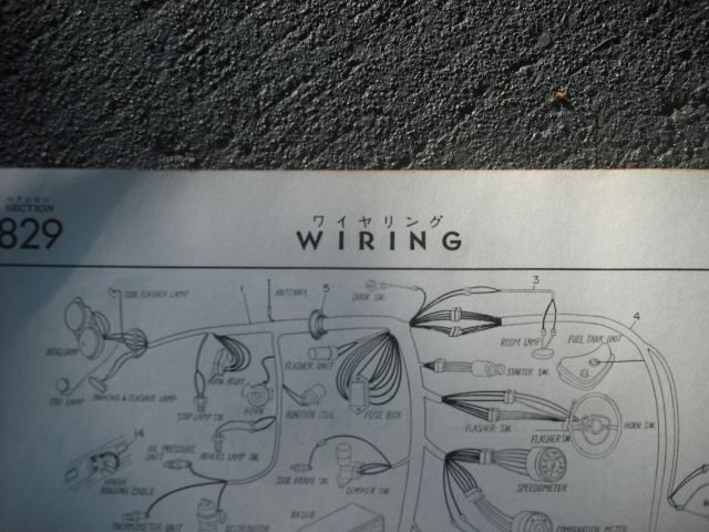

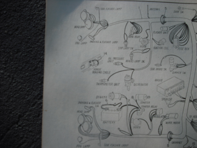

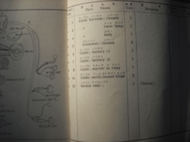

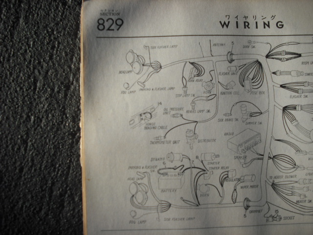

sorry guys its in the book ...hinge bonding cable ...a14 cable earth bonnet hinge (2) got this out of the small belletts parts list book ....cheers davo

WOW You learn something new everyday :geek:
Then I would say your local auto electrician should be able to make some up :D

more proof the exist ....out of chassis workshop manual
