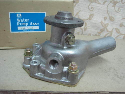

Here is a link for a water pump for sale on Ebay.
BUT at nearly $400 AUS you would have to really need it!!

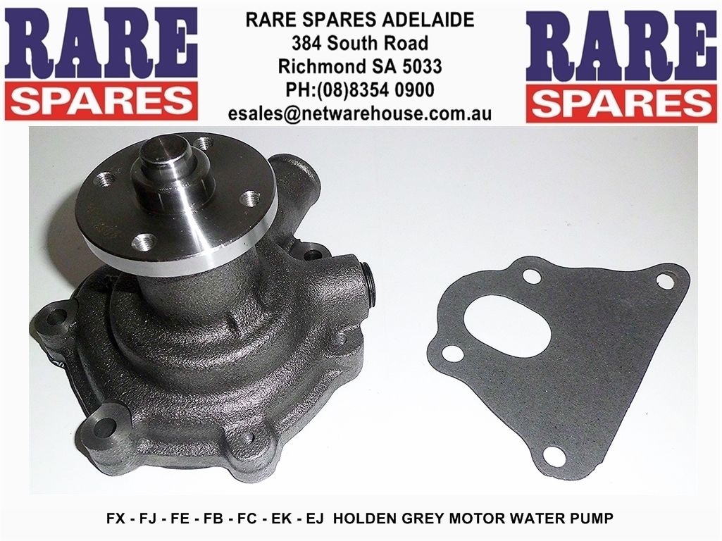

every time this comes up, i think of the water pumps used on a zillion Holdens with the Grey or maybe the red motor (or black) and think those simple pumps might just be adaptable to a Bellett. Mind you I don't have either of them to compare and see if that's feasible.
Depending on the height of the Holden pump, an aluminium adapter plate might work ? eg a plate 10mm thick, drilled to Bellett holes and countersunk bolts used to screw to Bellett block, then tap the plate to take the Holden pump. All assuming the water passage would line up or close enough.

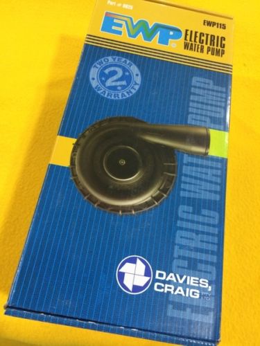

Just did a quick price check on an electric setup and I reckon it can be done for around $300.
Davis Craig electric pump for up to 3Lt is $185
A Thermo fan setup for around $35.
The original pump backing plate should be able to be modified with an outlet easily enough.
A Couple of hoses and away you go (yes I know it prob wont be quite that simple BUT)
Might just have t have a play around with that :geek:
You might be onto something Glenn...I wonder if it might be possible to find a proprietary pump shaft/bearing/impeller of the right length (maybe Holden), scan in the Bellett water pump housing, CAD up a modified housing to accept the new shaft/bearing/impeller and then CNC machine a new housing? Off shelf aluminium might do the trick, a coarse sandblast on the outside will make it look like a cast housing...completely rough estimate, maybe $100? Add backing plate, gasket and proprietary parts, maybe another $100? Maybe we can 'open source' our way out of trouble and have a reliable supply of parts?
