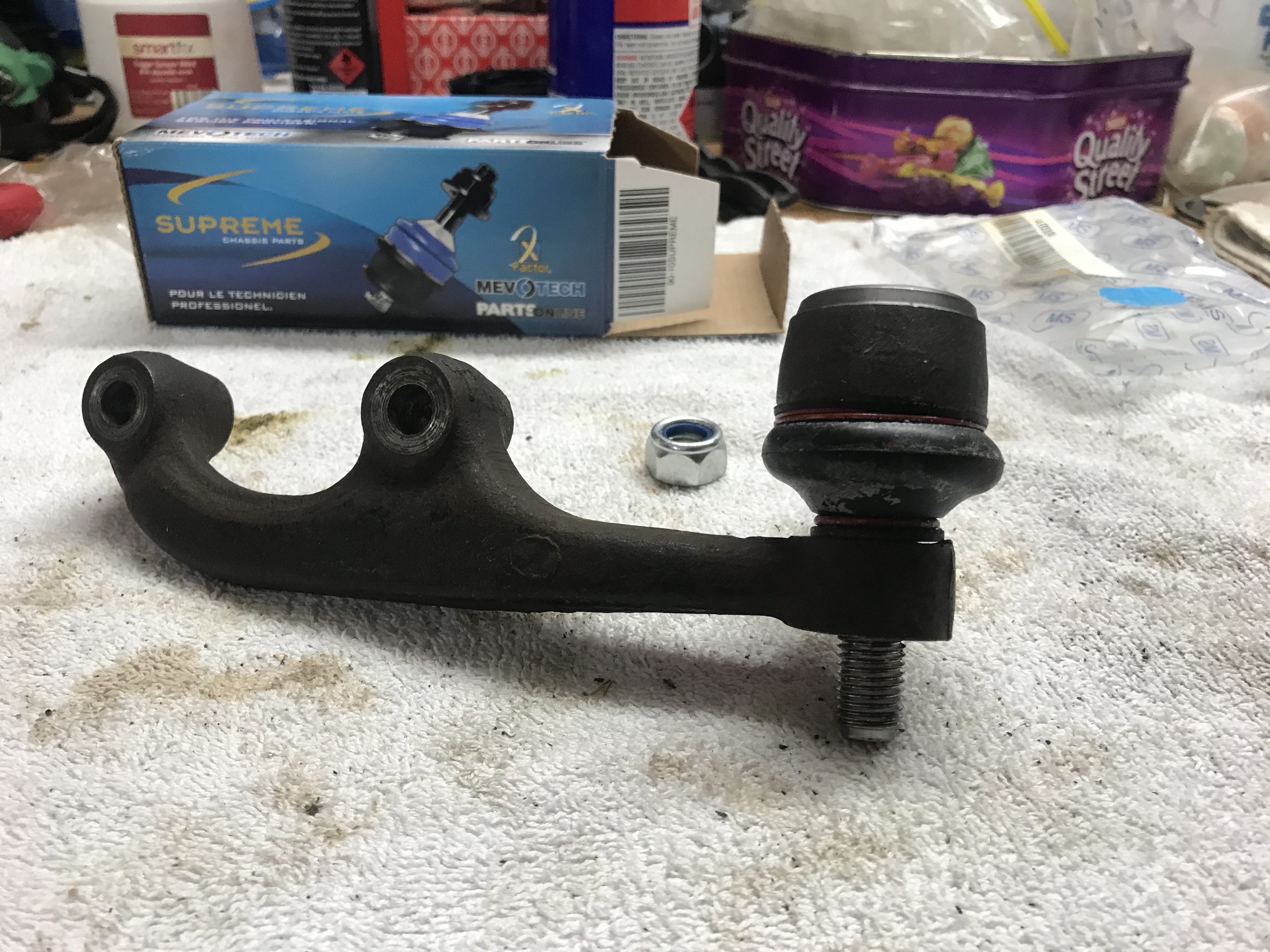

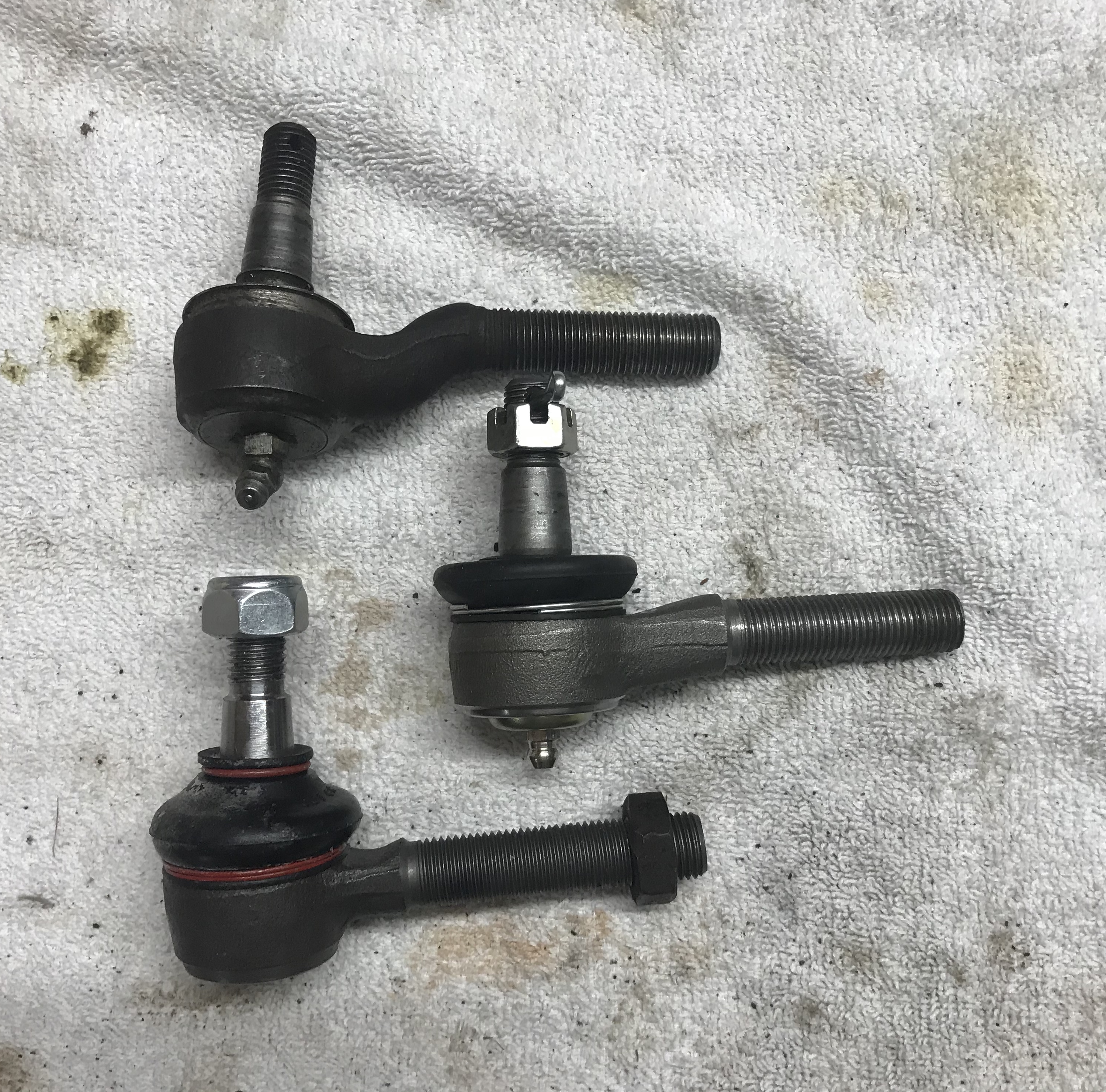

Hi All
No responsibility taken as have not fitted to my cars but have been busy beavering behind the scene and finally found these, they seem to be a good tie rod for lowered vehicles,
Has been a real challenge to find with a right hand thread

Be VERY CAREFUL.
Those looks like the ball is located slightly higher than the original in relation to the threaded section. Any change in things like that can give problems with handling, especially bump steer.
Might not look like much but believe me.... 3mm can make a huge difference.

As I said I take no responsibility - investigate with your own merits
Arrr the black art that is Bump steer
For those with keen eye sight amongst us......
The tape is 6mm
