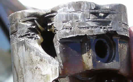

Im for fitting webbers. Webbers dont melt pistons.

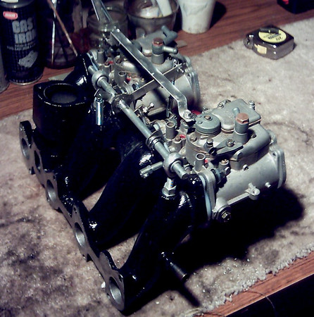

Yeah man I'm with Oz. The turbo is a novelty, but those carbies sucking down juice at full throttle would just be cool.
My GT has an EFI DOHC and I'm thinking of carby-fying that too, or at least something along those lines.
