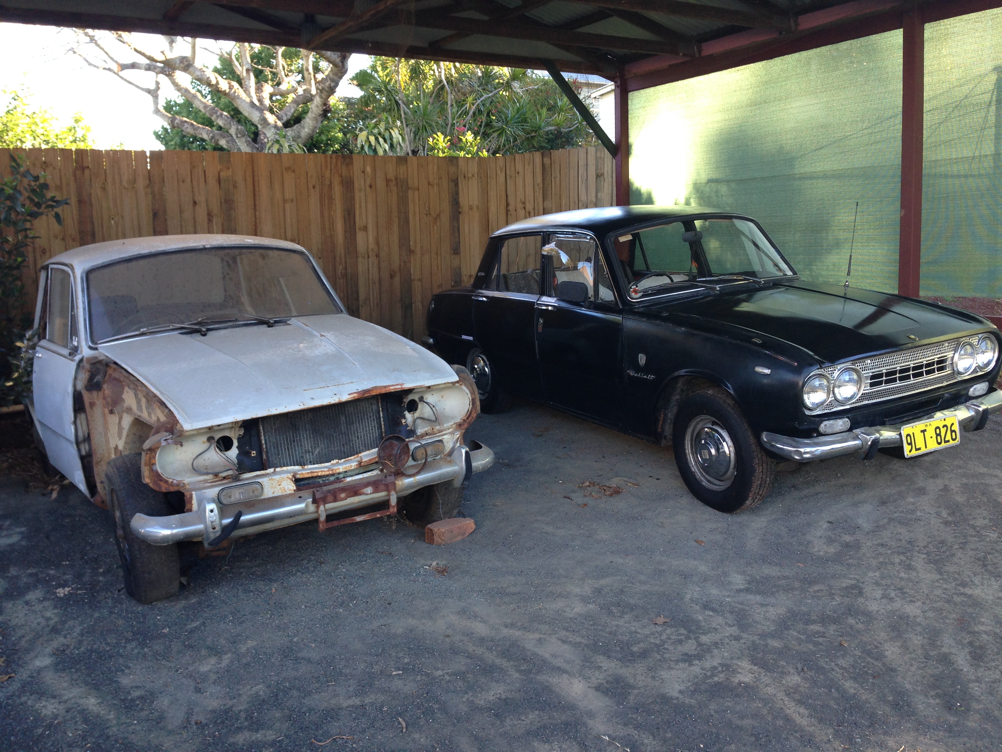

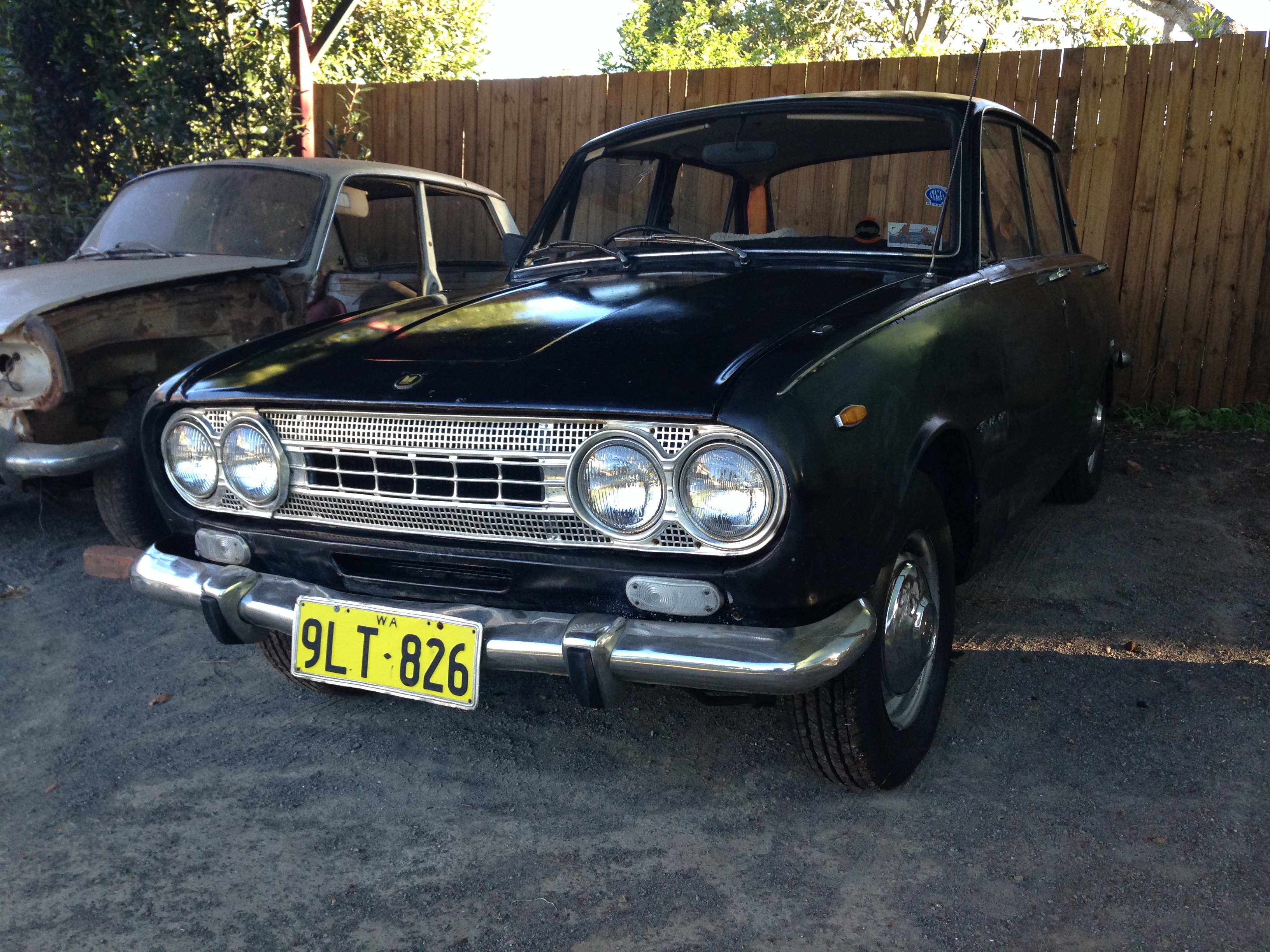

Sorry Gunna, couldn't help myself, someone from Toowoomba did get quotes, it arrived today and it now resides in my carport, some TLC is required, but it is a running vehicle and very presentable, some photos attached.
It's my son Michael's birthday tomorrow (19th), so it has arrived at a very appreciated time.

I drove the car for the first time today, I had forgotten how small the Bellett is after driving the XC Falcon for so long.
Steering and ride is quite good, clutch needs adjusting, it comes into play very high in the pedal movement.
Brakes, from 4-wheel Power Assisted Discs in the Falcon to 4-wheel non-assisted drums in the Bellett, no comparison, Discs on the front are going to have to appear, especially for modern day driving.
And to think I used to race these cars with Drums all round.

Here's my take on it at this stage, the car is a 66 1/2 and DID HAVE a three bearing motor originally (which is the block under the house).
The engine in it now is a 5 bearing that has for some reason been made to look like a three bearing and for some reason, carries the same engine number as the 3 bearing (is there a way to link the engine number to the chassis number).
In the paperwork I received, there are comments about leaks from the sump, I don't recall if the tin sump should go on a five bearing motor and if it did, what the result might be.
In the spare parts there is a Late Starter Motor whereas the car has an early one fitted.
There are some very confusing aspects about this car (is it possible to track down if it was in fact black from the factory?) (there are a lot of less than professional body repairs done).
There is a late Deluxe Front guard on the drivers side that was Orange, (a spare passengers Deluxe guard has also been supplied, also Orange), the passenger front guard on the car is an early model (Trim strip and mirror mount different).
The car appears to have been in storage for some time (possibly outdoors) and I suspect the may 2016 rego on it may be its first for a while (it was fitted with 5 new tires and an Inhibitor Switch in May/June when the rego was done).
The car has quite a bit of potential, but does need quite a bit of work on the body, it drives well and I got the brakes working as good as I can remember a Bellett to be, but still mysteries to solve.
At this stage, some sill rust got it knocked back for rego, but we are working on that.
