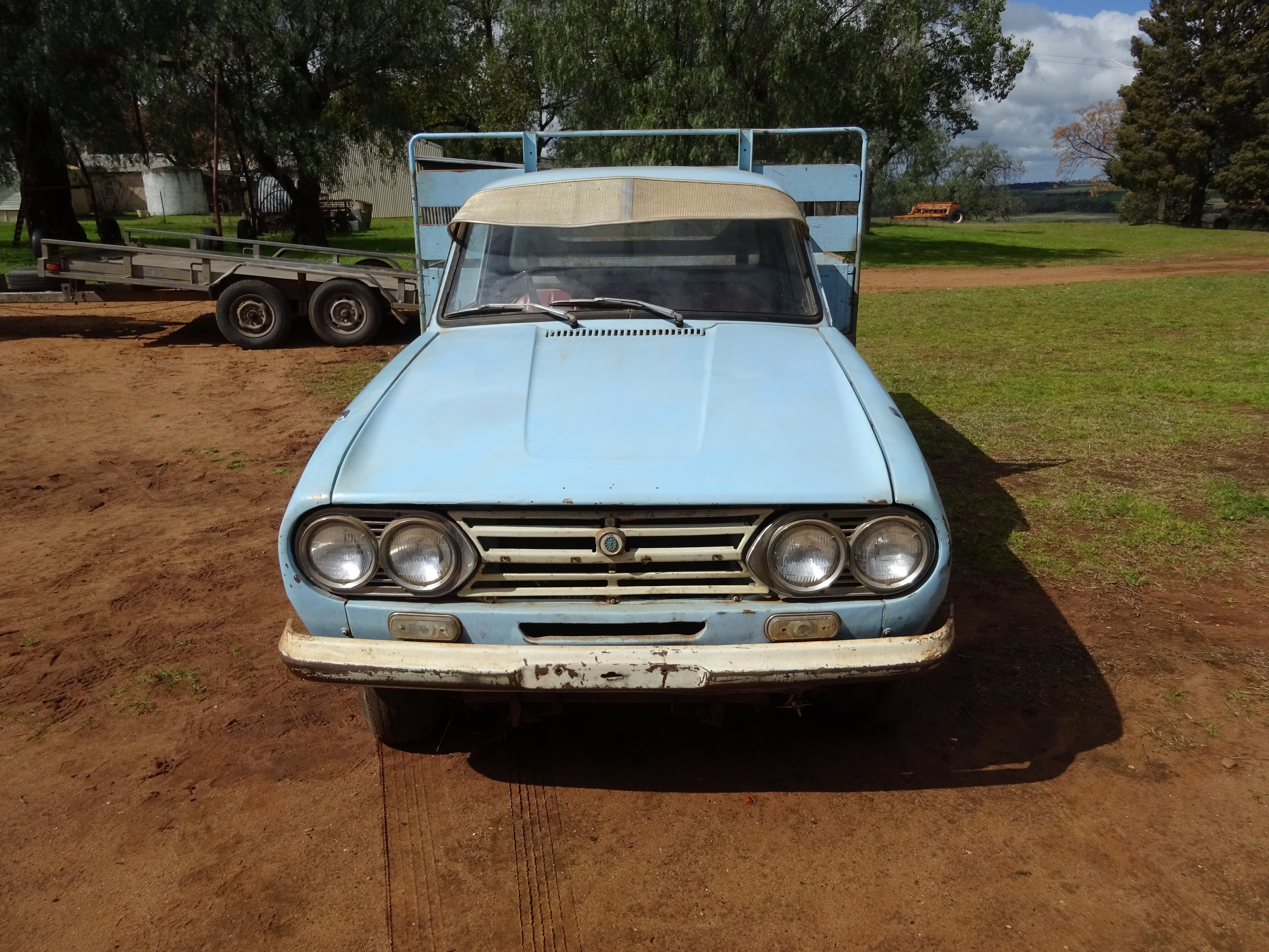

The Facebook picture that made me fall in love with a 1 owner, baby blue ute from Dubbo.........

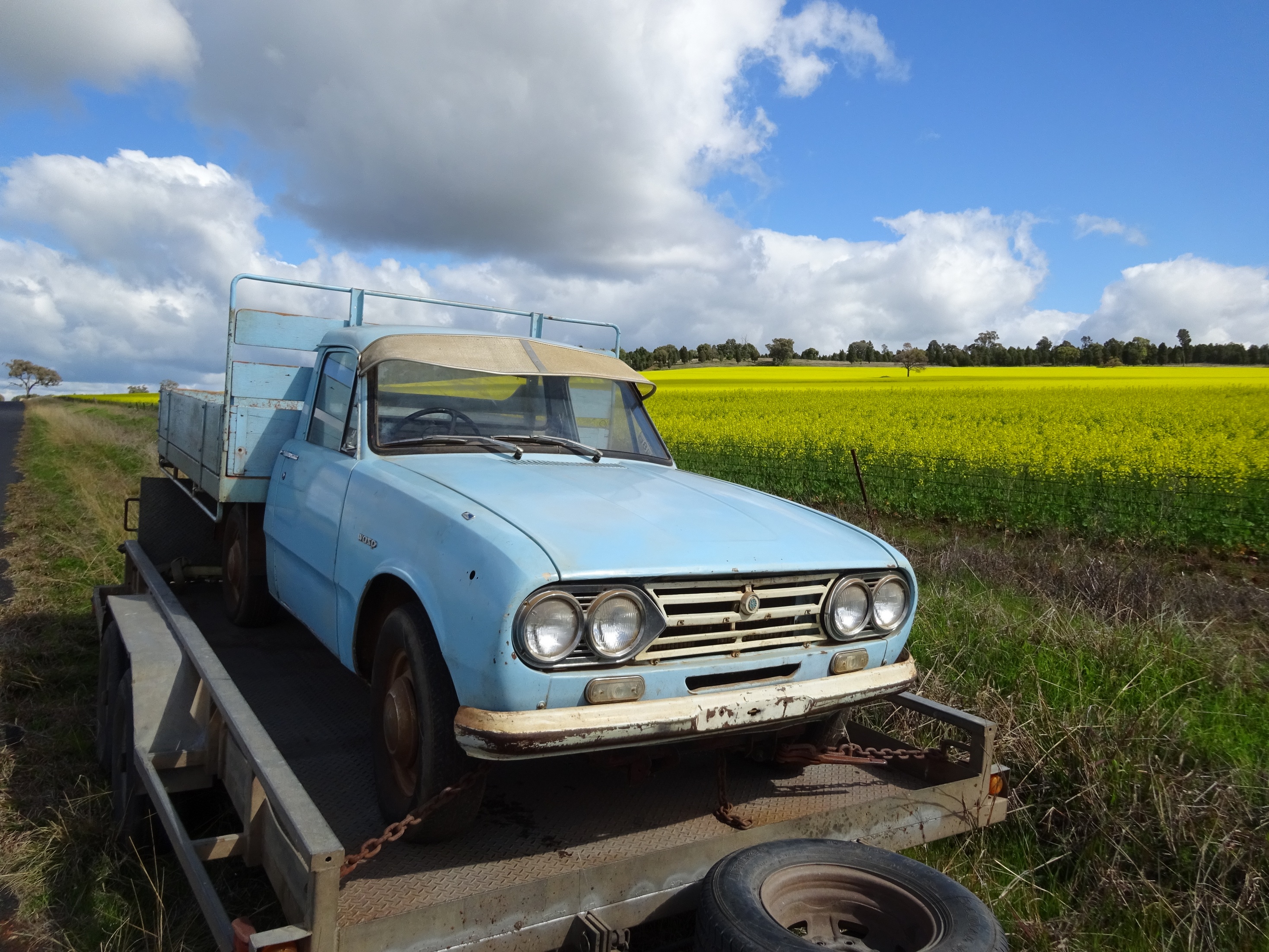

Some pics from the day I picked it up and the road trip home..... back roads style :mrgreen:

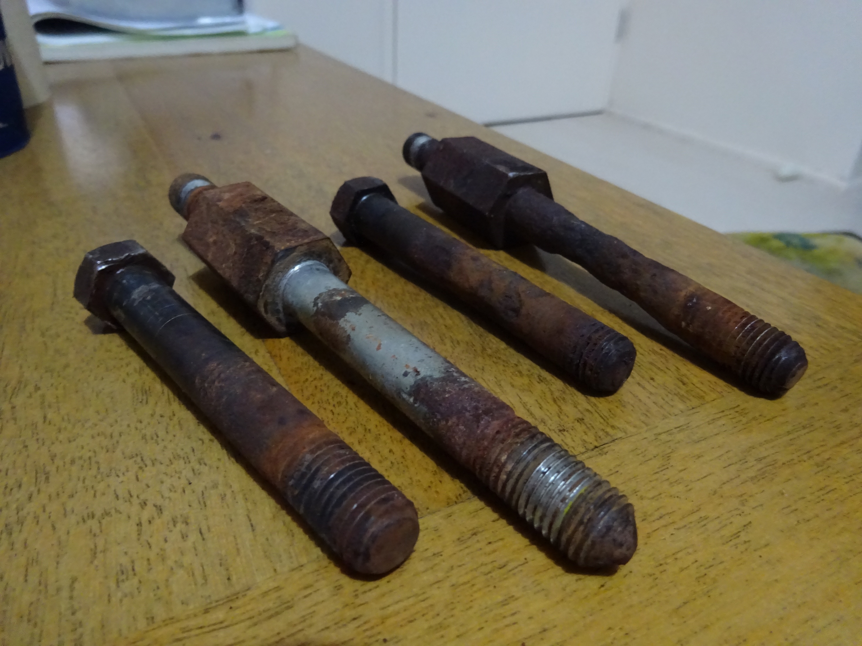

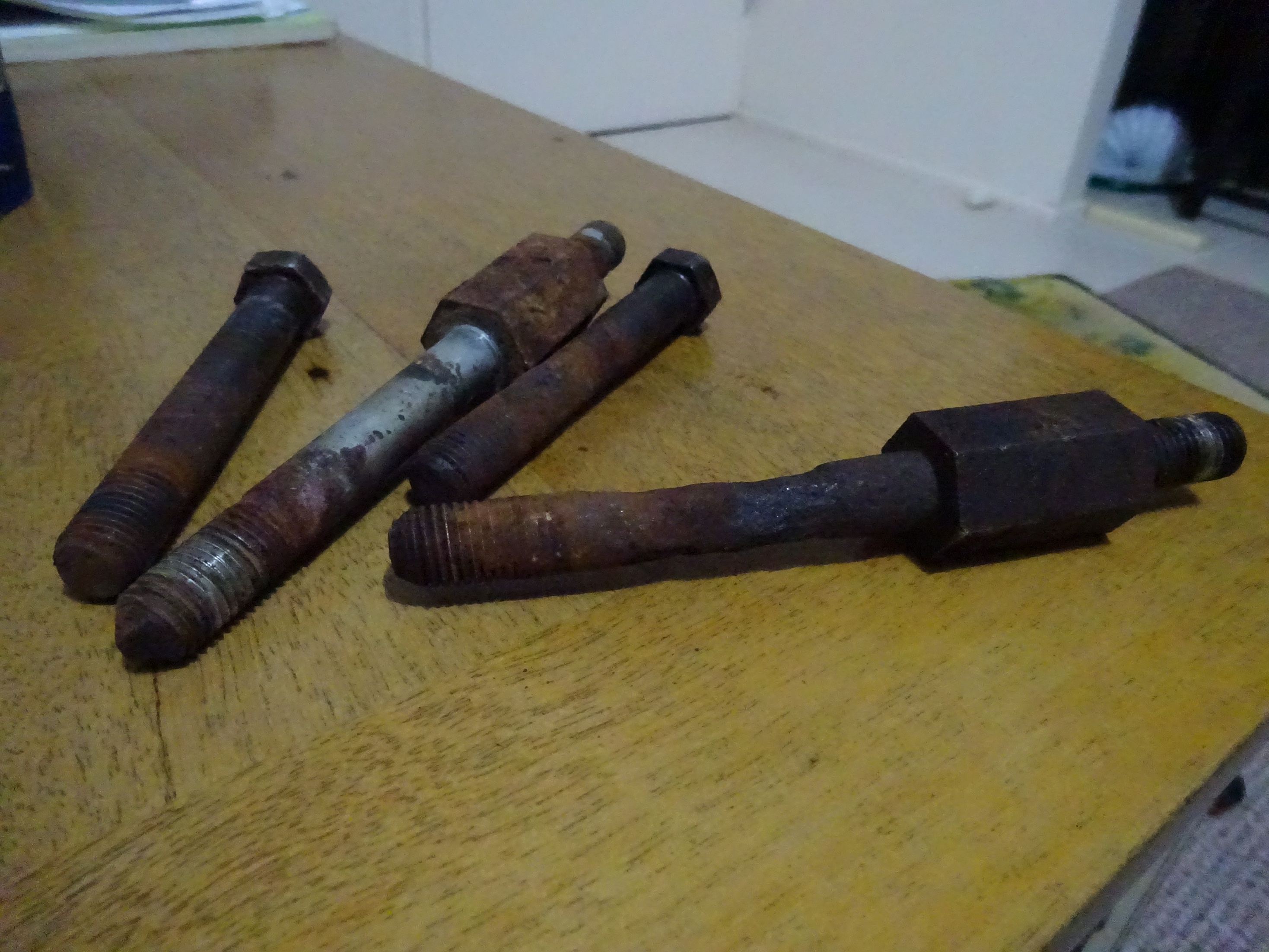

I took 4 1/2hrs to get the drivers side lower ball joint out :shock:
Never in my life have I had one that tenacious.
Two of the bolts were we and truly rusted in tight but persistence, a bottle torch, pinch bar, hammer and a few beers eventually paid off.
Does anyone know if bolts like these are still available off the shelf somewhere??
If not I'll get a mate to machine me some up
