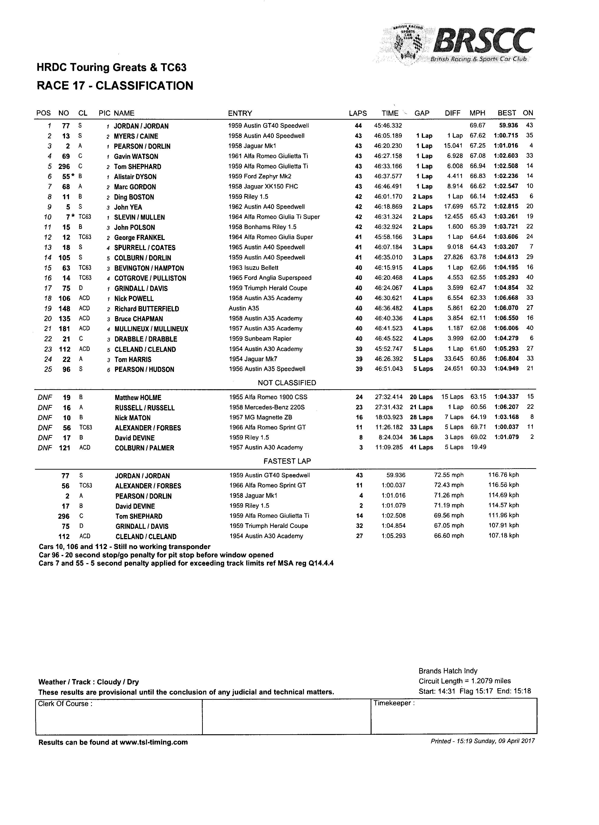

Back from Brands, and generally pleased with how we went.....the new diff is excellent, and has already gained us 2 seconds over last year...but of course, the extra speed/revs comes at a cost, and the car ran very hot....which subsequently we couldn't run at maximum attack.
We have plans to sort this though.
We qualified 15th of 33 and finished 15th.

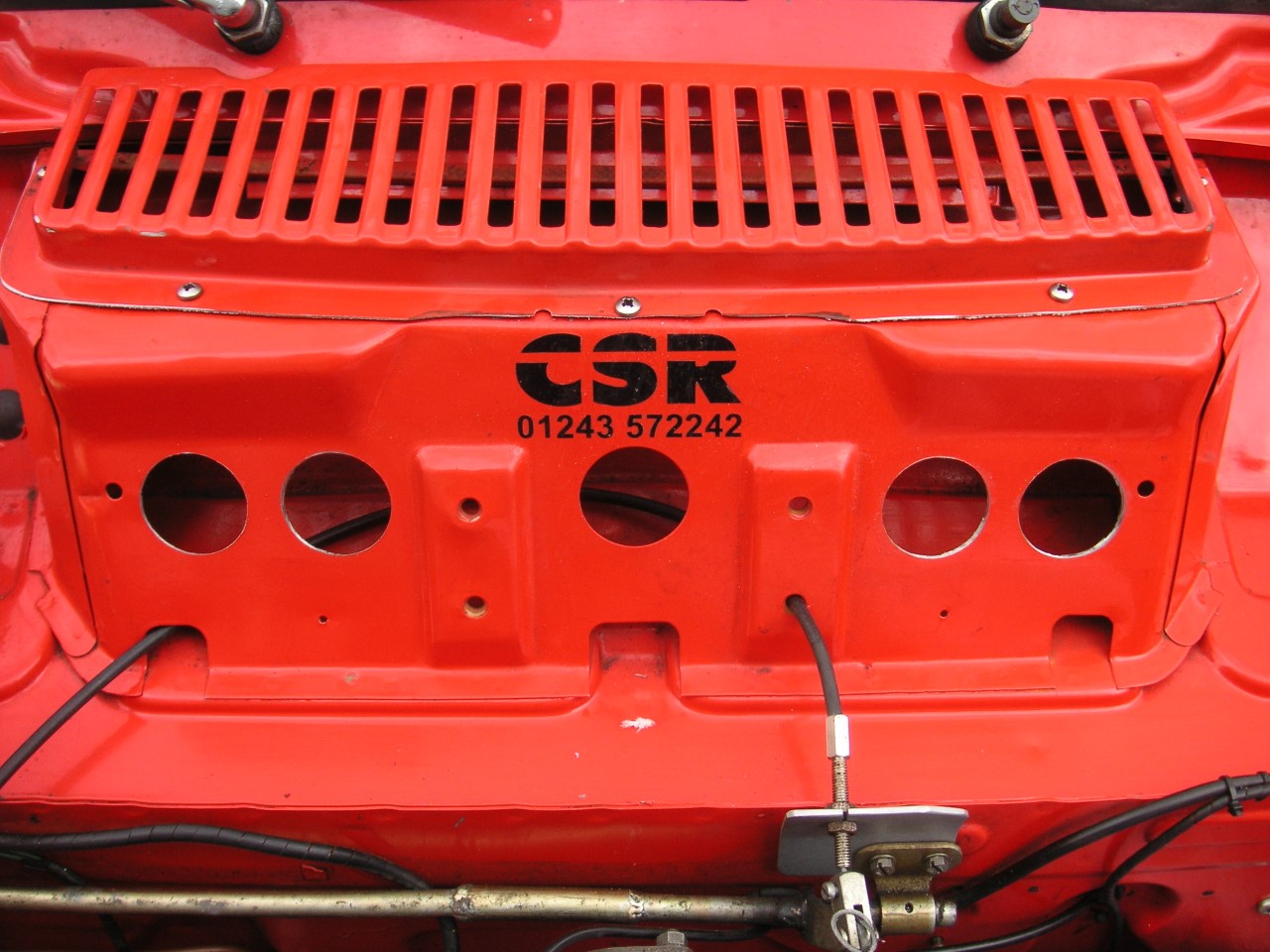

We've now started work on cooling it down, the idea is to create a lower pressure area at the back of the engine bay and increase flow through the rads.
So we've cut more air exit holes in the heater box
We're not allowed to raise the rear of the bonnet, so we've cut off the bonnet flange and the return flange on the grill.
There are loads of other things we can do, but this time we'll take it one step at a time, this way we can work out which mod does the job.
