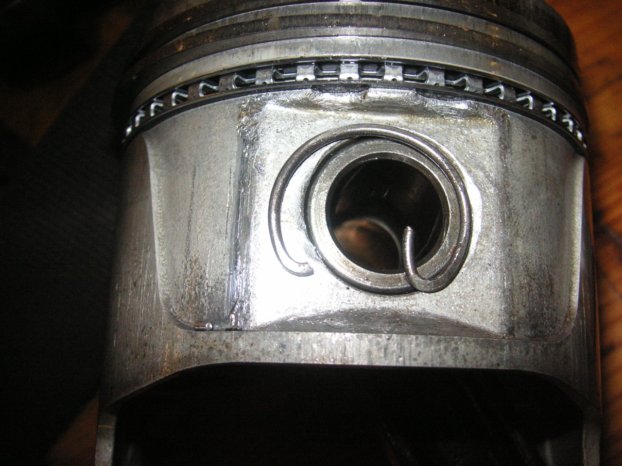

True enough Sticky....and we need it even more, as it turns out all the clattering has shaken a clevis pin loose....
....and now we have to re-bore as well......so it's a full on rebuild now.
A year or two back I found some NOS flat top 1.5mm over pistons...these will put us up to the best part of 1900cc....we have time to properly balance every thing, and put the flywheel on a further diet....so hopefully this cloud has a silver lining, and by silver lining I mean a second or so!

That gudgeon pin clip must have made a racket. I had a circlip on a rear axle short shaft let go once.
The noise it made would not have been the same as what your engine had produced.

Dave, there's another 1.5 litres, so just over a third of a gallon......and the sound of me swearing drowned out the circlip noise!
