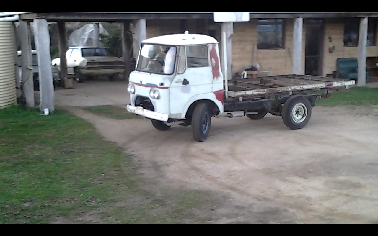

So today Dobby came out of the shed under his own power. :D
Heres an action shot!

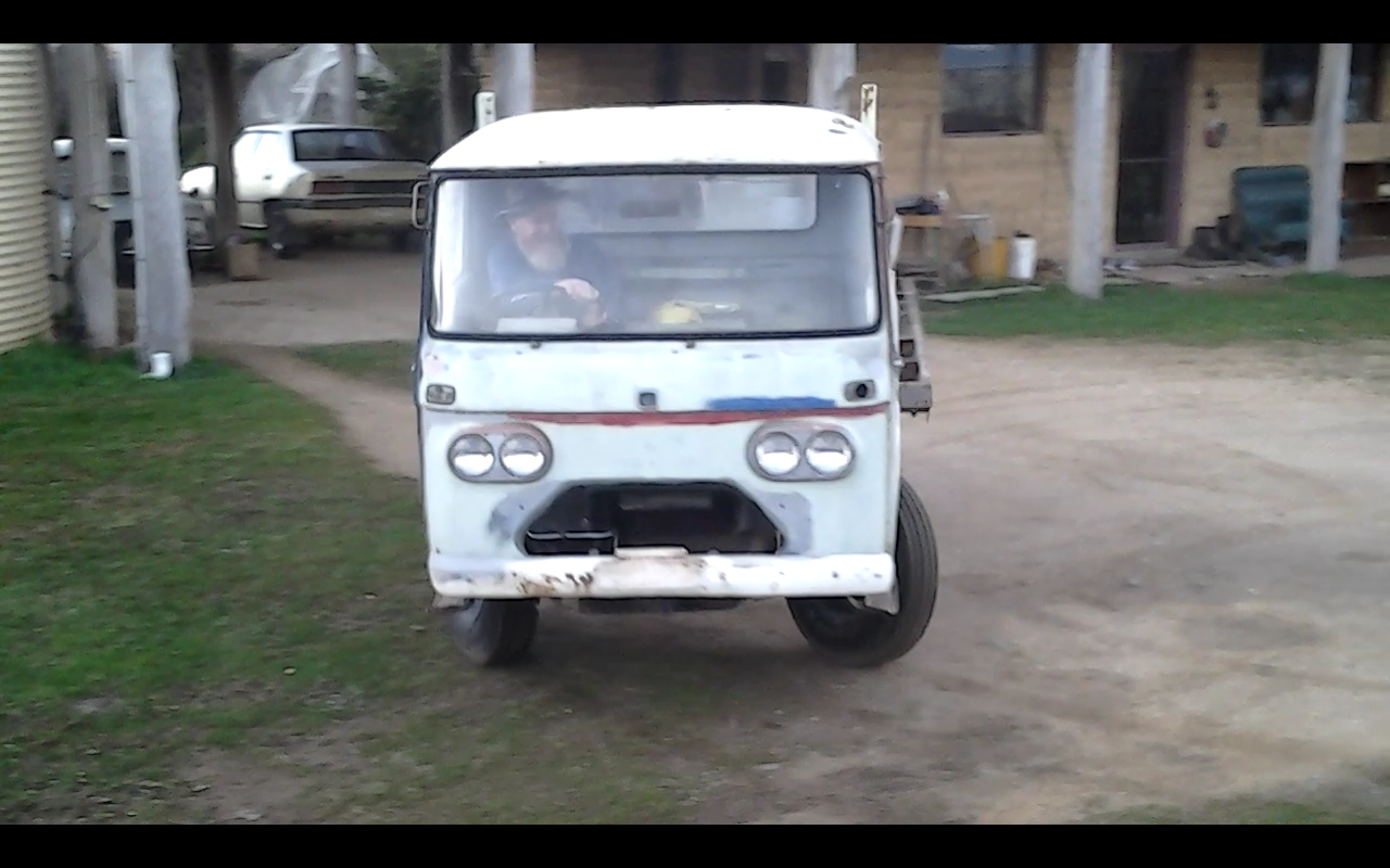

I was pretty excited.
He has a surprising turning circle, a bit tighter than a Bellett and way tighter than a Florian. Somehow he turns more tightly to the right, might be a wheel alignment needed.
So, the clutch works, all the gears select, even reverse, and the brakes are surprisingly effective, considering theres no booster.
So now it might be time to get into some paint!
