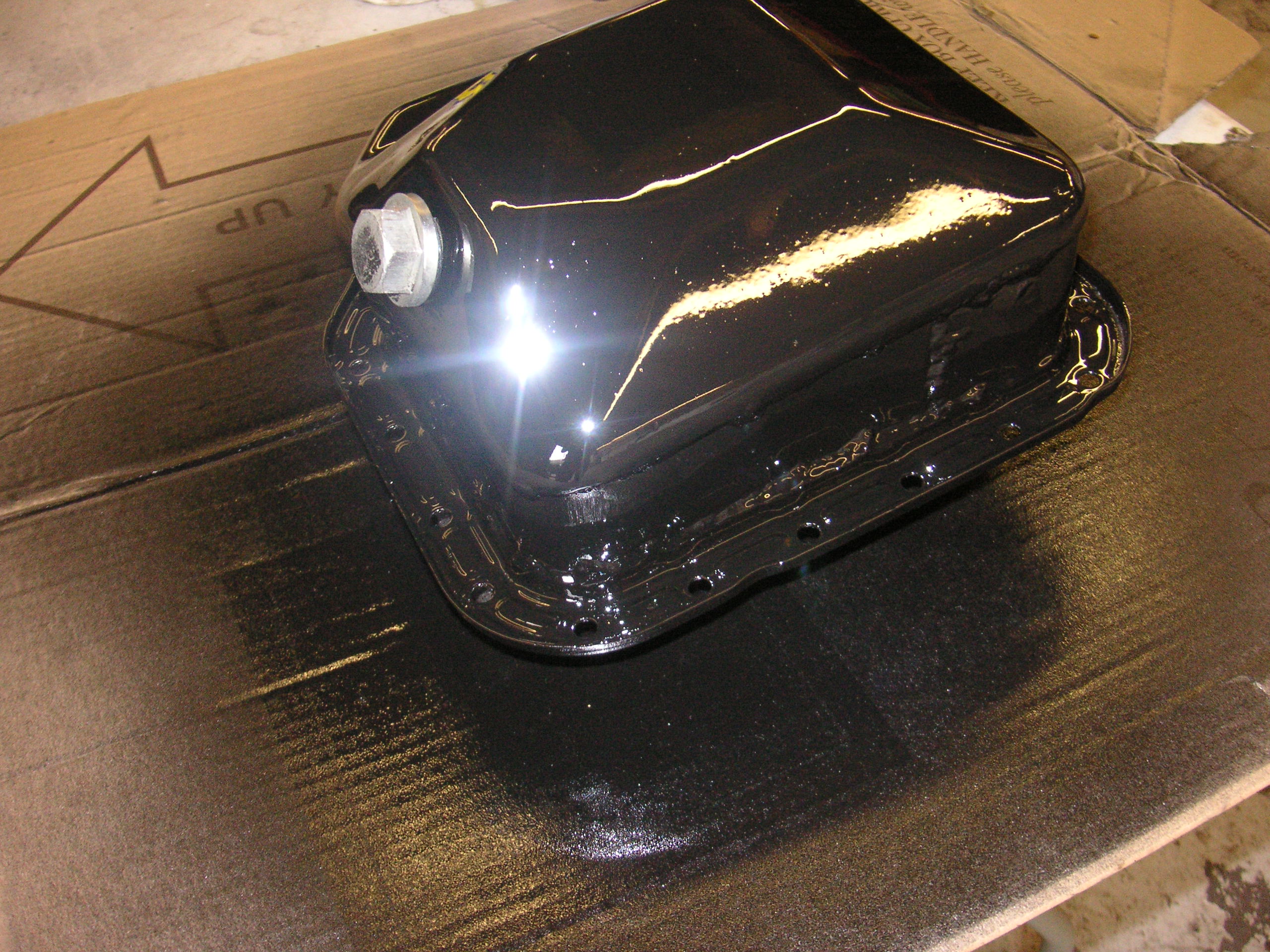

Whilst the block is at the machine shop, we've created our new 'deep' sump in order to counter the surge.
This has been an interesting exercise, also involving extending the pick up and accompanying shroud.
And finally giving the end product a coat of 'speed' paint.
Don't you just love the development process?

Thu Sep 07, 2017 7:53 am
Hi Pom.
Have you gestimated how much extra oil is needed. :?: It looks like half a gallon. :lol:
Better more than not enough. :|

Dave, there's another 1.5 litres, so just over a third of a gallon......and the sound of me swearing drowned out the circlip noise!
