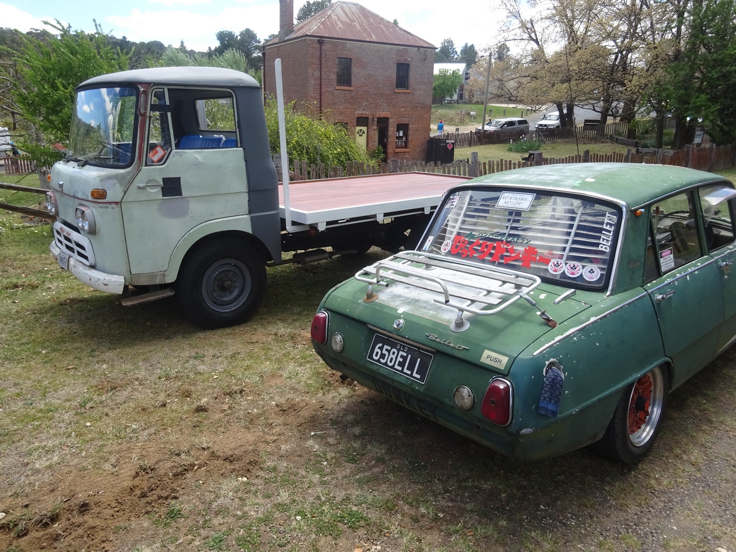

Who are those guys in your elf pinching. 44 gallon drums of petrol. Ha ha
Fri Oct 20, 2017 7:11 am
funny how the guy in the cab has the safety helmet the other 2 have caps but they look cool ha ha love your elf farmer
