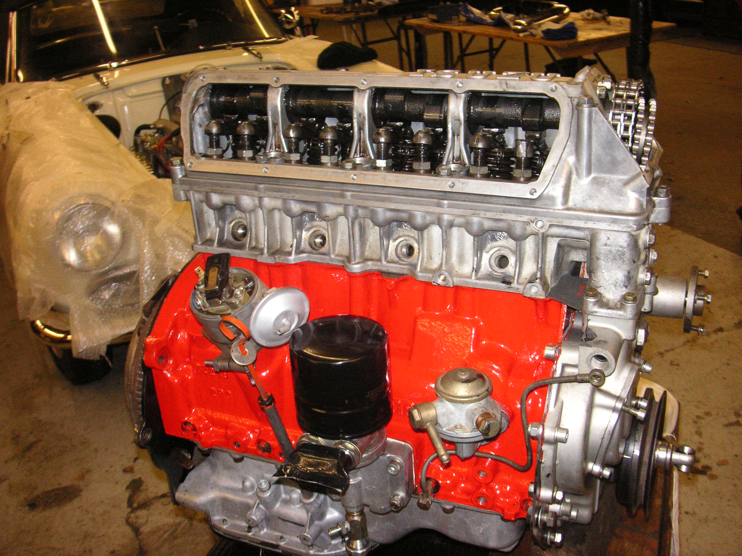

The motor's pretty much done now...here's the business end before it goes on.
Torqued down.
