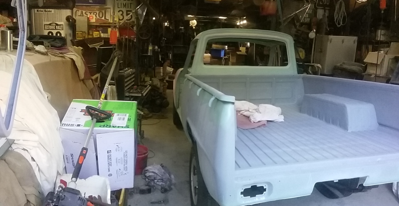

Happy new year - I took a bit of time off & spent it in the garage . Tub is now rubbed back , rust repaired in taillight panel , 4litres of bog ( most now on the ground ! ) & lots of hitting it ! The main section of new floor
is now welded in - the four bits either side of the wheelarch are yet to be cut to size .

How long has it been now ? Are yes , that's right - about 40 years . COLOR IS FINALLY BEING APPLIED
AND IT'S NOW IN ONE PIECE !!!
